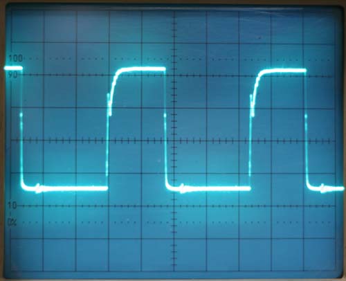

Offline halfbridge smps gate drive
Low side gate:
5V/div and 2us/div. Center is 0V.
Looks pretty good to me. To be picky you could work on the bus impedance to try to get rid of the minor ringing on turn-on.
And also.. That spike that you see when the other IGBT turns on is just a common mode noise. It's normal. The IGBT does not 'see' this. To verify this you can take the scope and place the tip on the emitter of the lower IGBT and place the ground at the same point. You will see the same spikes. You can also put a ground eliminator tip on the probe which reduces the probe ground to under 0.5". The spikes will be deminished greatly.
Most likely you do not need this new gate drive circuit but it would be interesting to see if there are efficiency improvements. Did the previous gate drive waveshapes look similar? Also I usually place a loop in the the connection on the drain or collector and insert a current probe to check out the actual transistor current to see if there is anything funky going on.
