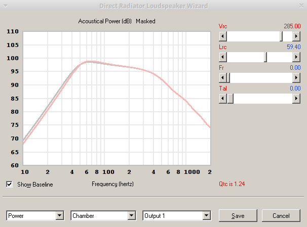

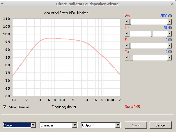

I think they would make dandy OB helper woofers. With a decent size baffle (not huge) They should do nicely down to the low E on a bass guitar and a bit lower. Another possibility would be as part of an in-wall (i.e. infinite baffle) setup just don't expect true subwoofer output levels; Good for the mains though.
Some sealed sims...
Red line is about 10 ft^3 while grey line is about 14 1/2 ft^3.
A true infinite baffle (rear of driver exhausts into the next room)...
You could try an aperiodic vent too.
Some sealed sims...

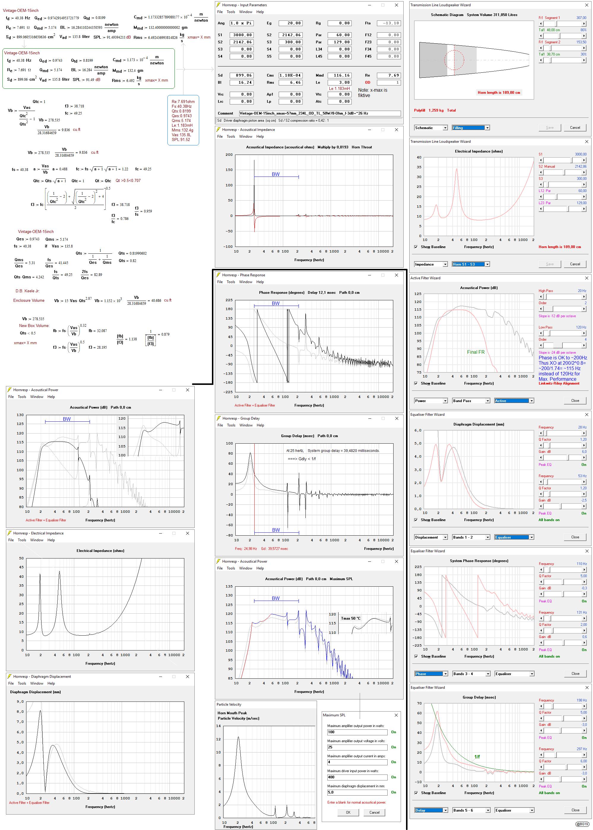

I had a (prebuilt) ported sub with a similarly high Q driver. The FR plot was "M" shaped. Still sounded OK if used <80Hz.
Bjorno's suggestion looks like a lot of bass / bang for the buck.So what would you guys recommend when using this woofer?
What other gear do you have? Other posts imply that you have a measuring mic & EQ, so you'd be able to tweak a complex build.
After such a long time, the suspension will stiffen up. Wobble it at it´s resonance frequency for at last 20 hours, with reasonable cone movement, I woud suggest +-5mm at last. Then let them cool down for about 2 hours (important!) and measure again. You will see much different TSP data, which represent the real, long therm values.
Most probably you can use them in quite different constructions/ simulations then.
