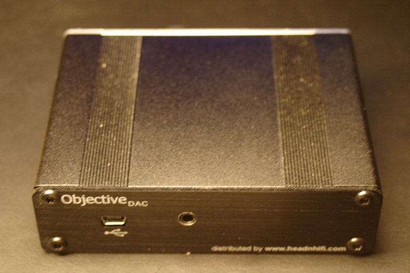

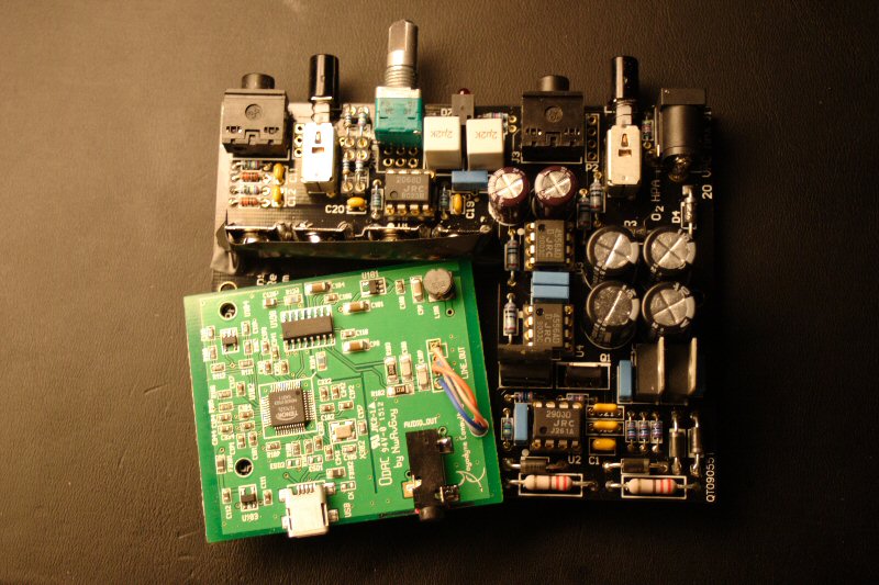

Received and put the ODAC together with the O2, no issues whatsoever. Thanks a lot !
Inside I went for not fixing the ODAC at all, it fits quite nice and gets secured by battery fasteners and the usb-connector in its hole. I used some plastic tape to be shield the ODAC electrically.
I used a 5.5mm drill bit to make the hole for the line-out. I marked the position before I mounted the 3.5mm connector and later only soldered two points so I could adjust the position a little bit to make the fit perfect and then soldered the third point.
