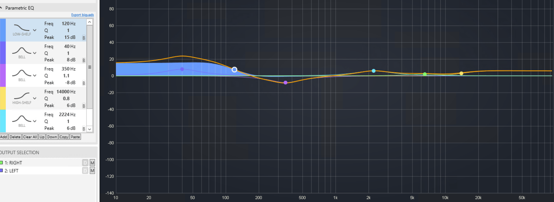

@styjp - SB Acoustic SB20FRPC30-8 hit my door this week. Honestly I didn't have much hopes as per Qts, Qms, Qes values, that, theoretically, disqualify it for open baffle. I placed it in piece of plywood 600mmx300mm as an baffle (so basically nothing) and to my big surprise it plays dam good. BUT, a big but - if you don't use DSP processor - forget about this speaker. See correction curve (set up by ear so far as I didn't have time to set up measurement rig yet). Without DSP you can't make it play. With DSP => my Lord! It really singOh thanks for that, didn't know there was a formula to determine the baffle. This is really helpful.
This is actually the size of baffle I wanted to experiment with. Do you use any subs or just the speakers? I guess you can pump up the bass with DSP but how loud can this get with such corrections?
Also what's your target curve with that dsp? A measurement would be nice!
Thanks!
@styjp - this is good question - how loud. Principally quite but it also heavily depends on music material. I listen mainly to classic where bass is not so densy. But if you play eg. Marcus Miller speaker is trying to jump out the chassis Another topic is bass quality - you can make wonder with DSP but if you go too far bass gets boomy. Generally - unless you are not more than 5W per channel you are good. So it's good combo to small tube SE amp (I have EL84 SE and it makes happy combo). Today I mounted it in larger enclosure with open back inspired by Klang+Tone (see Cheap Trick 269 project). I have Monacor sp 205 as well so will try today. If it's not gonna work nice for me I will give up with point source concept and back to my original well prooven construction with tweeter (actually it's Faital 3FE25 which I found to work amazingly as tweeter + Monacor sp205 in the mid + 2 x GRS 8" woofers all in two section open baffle)
