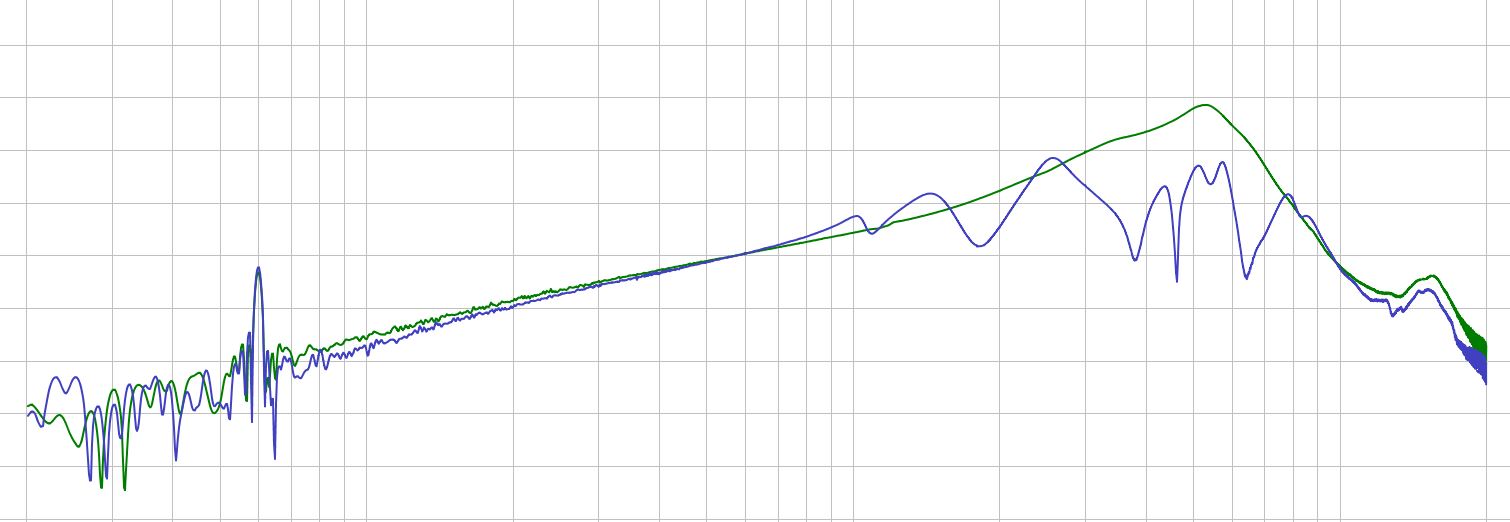

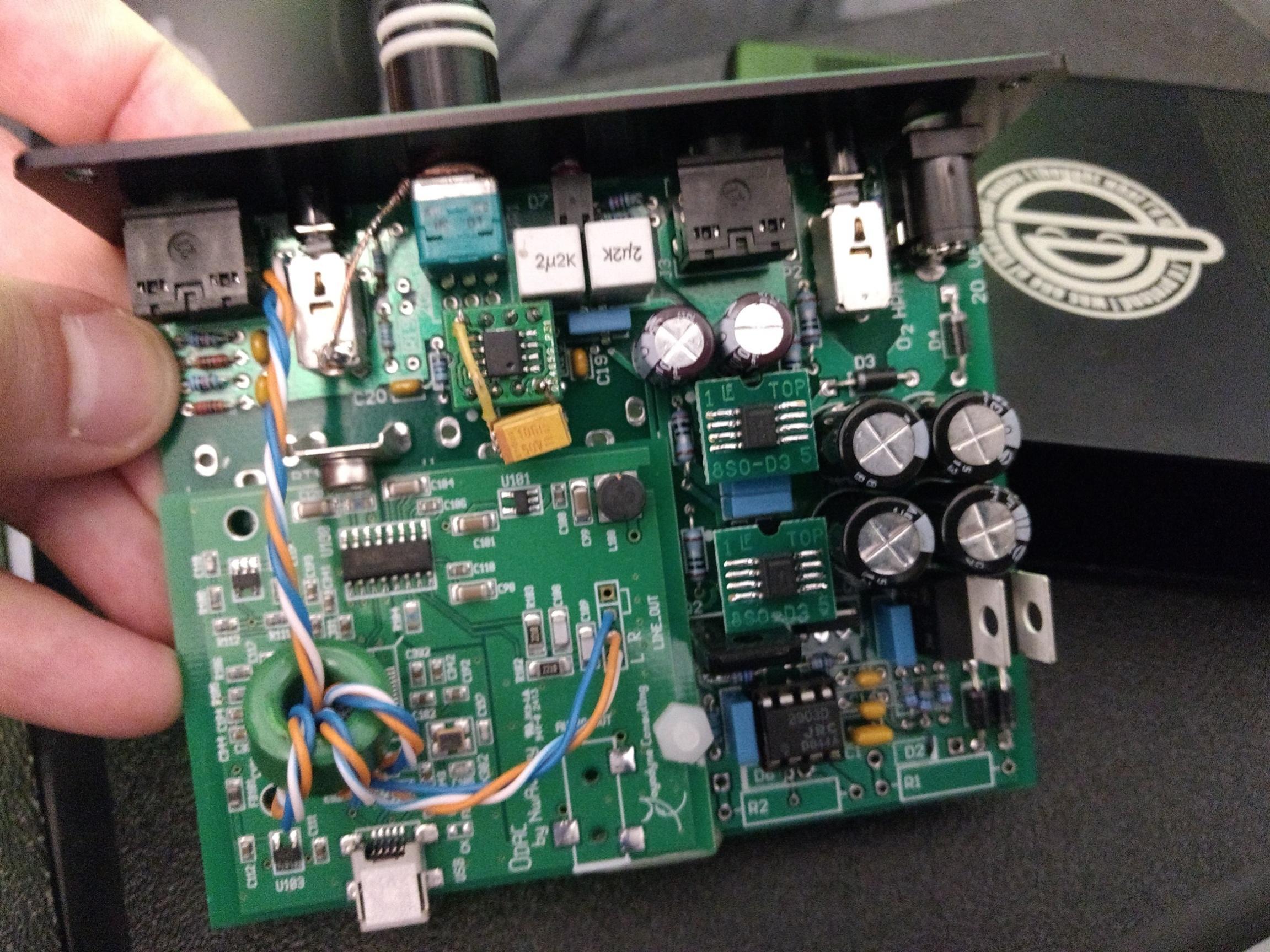

Looking for a suggestion for a mod as I believe I ran into an oscillation issue the other day and it killed one side of my headphones. (RIP Sennheiser CX300II's).
Background - I have a O2amp/DAC combo from JDS Labs running off a wallwart with 1x and 2.5x gains. I have made the following mods to it:
Replaced U1 with a pair of LME49990MA's in a adapter and put 10uf tantalum capacitors across their power supply rails. (this has tightened the highs up quite a bit!)
Did the "Your music source feeding the O2 headphone amp is too loud, even with the O2 is the 1x gain position" (I use IEM's and this better suited my listening levels) and "Ground the pot faceplate and shaft to reduce hum and noise pickup" (hey why not) mods from O2 modifications page.
Replaced the wires from the DAC to the AMP with ones I twisted and wrapped then around a ferrite a few times. (killed off some noise I was getting when I turned it up loud - the LME49990MA's are really sensitive!)
Replaced U3/U4 with OPA1688's in adapters. (lows have a good bit more punch now - great mod!)
Now now I believe one of the OPA1688's went into oscillation when I had only one earphone in my ear and a ESD event happened. I live in the cold north and despite my attempts to limit ESD it can still happen and I have been shocked though my ears with different equipment more then once. But this time I started hearing a weird (womp) (womp) noise right after so I killed the power to the amp and afterwards when I powered it back up that side of the earphone is severely degraded. Testing the amp and other earphones shows the amp is fine.
So my question is - what would be the best way of preventing this from happening in the future? (what parts can I throw at it - digikey is only a few clicks away and I like to solder! :) )

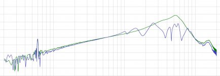

Attached are pics of the amp in its current state and a REW graph of LvsR of the aftermath of the ESD/oscillation event. (blue line of the R side shows how burnt it is)
Congratulations on your modification efforts! :) I like your solution on grounding the pot shaft, that wire to the shell of the gain switch. That is going to be more reliable than trying to ground through the shaft nut.
Regarding the LME49990 in place of the NJM2068, I don't recommend that one anymore and I've taken it off the websbite. The recent batch of LME49990's - after TI bought National - seem to oscillate in the O2. You can tell if it is oscillating just by putting a finger on it to check temperature. If it oscillates it will run 140F+, too hot to keep a finger on for long, vs. the more normal 100F. Just compare with how hot U2 gets, it should only be slightly hotter.
When I first tried that mod I tried several LME49990s and not oscillations at all. Maybe I just got lucky or maybe there was a process change, but the recent batches I've tried all oscillate. The reason for the oscillation is likely inadequate deocoupling at the power pins for that 110MHz LME49990. NwAvGuy only had the little blue 0.22uF film caps on the rails, which is all the 27MHz NJM2068 needed.
HOWEVER, having said that, you may very well have solved that issue with those tantalum caps you added! So you were right, it probably did sound different because the chip was oscillating, and when you added the tantalum caps on the power rail it either stopped or the oscillation frequency changed. Your LME49990 might be just fine now. If it isn't getting excessively hot now you probably solved it.
The LME49990 oscillation probably isn't the cause of your headphone issue though. It usually oscillates at 11MHz or so. At that frequency the headphone driver coil would be an open circuit.
Regarding the OPA1688 substitution for the NJM4556A chips, there is most likely your problem. That is one of those "try it, you might get lucky" mods that a fellow in one of the other threads came up with. I don't have that one listed here or out on the website. Normally the OPA1688 would require that 47pF compensation capacitor that johnc124 has in the datasheet to increase the phase margin enough to support a wide range of capacitive headphone loads. The O2 PC board just shorts the output to input for unity gain. In the unity gain configuration you would need the capacitor + resistor arrangement from the non-inverting input to ground in unity gain to increase phase margin.
In other words, unless your headphones and headphone cables are a very light capacitive load, there is a very good chance using OPA1688 chips in the O2 will oscillate. I haven't tried adding capacitors on the output to see at what point that happens, but I'll take a guess it isn't much over 100 - 200pF.
But even then I'm not sure that would take out your headphone driver. The most likely thing to do that is DC on the output. Have you checked the DC voltage level on each output of your O2, with nothing plugged into the input jack? It should be around 3mV with the original NJM4556A chips, or 0.5mV with the OPA1688s. If the OPA1688s started oscillating maybe their DC output level went up.
You may very well be right about ESD zapping an OPA1688 too! Static electricity is the #1 killer of chips in my experience, way past soldering iron heat and thermal issues. It could be the OPA1688 is more sensitive to that kind of thing than the older NJM4556A, maybe due to smaller process geometry. From the datasheet the OPA1688 claims to be well ESD protected on the inputs, but I'm not finding anything about the output.
I see another mod to consider, looking at your photo. :D The two 2.2uF film caps can be replaced by 3.3uF caps of the same size to drop the lower corner frequency even lower. I think I have that one up on the website. When NwAvGuy designed the O2 those 3.3's were not available yet.

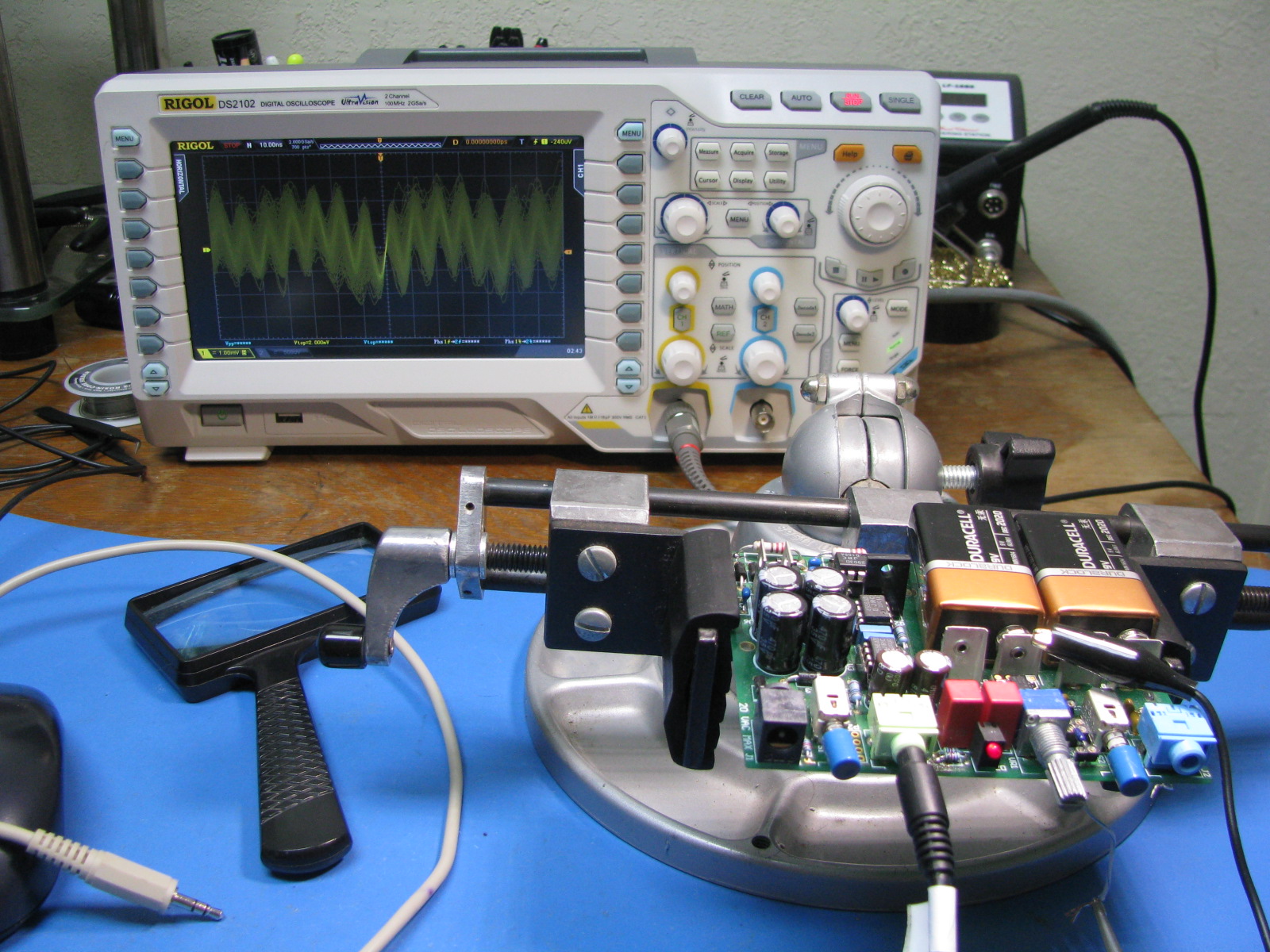

OrBy - yep 150 degrees F is oscillating! I agree, the LME49990 does sound good (still) even oscillating. I can't really tell just from listening if the chip is oscillating or not.
The NJM2068 really is a pretty good chip. My suggestion would be just to leave it, or if you wanted to try another chip (I haven't tested this one myself) the OPA1612 is bipolar and very low THD+N (also SMD and would need an adapter, but it is a dual like the NJM2068 so just a single-sided dual adaptor). The OPA1612 is still unity gain stable and "only" 40MHz GBW, so possibly less of an oscillation problem. If you should try the OPA1612 please post your results!
The output chips in the O2 are ones that need a root canal, so to speak. :D For that my Booster Board DIY project here is a better solution than the OPA1688. That board is a OPA827 wrapped around a LME49600 on each channel. Much more current capability for peaks, no problem driving normal capacitive headphone loads, and a headphone relay to eliminate thumps.

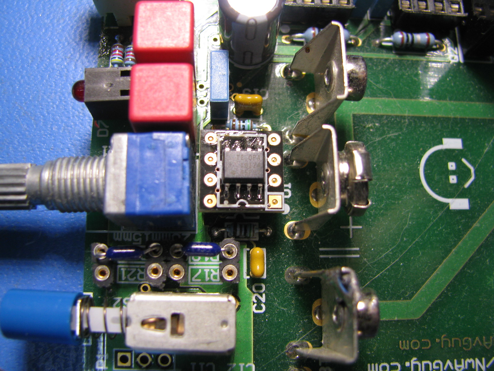

I had forgotten that I bought a bunch of these Brown Dog SOIC-8 to DIP 8 adapters recently:
SO8 to DIP8 Adapter | Cimarron Technology, Inc.
They are small enough to fit in that physical space around the NJM2068 area in the O2. I just soldered up a OPA1612 on one and gave it a try, but... it oscillates. 110F measuring the temperature (the 105F in the photo wasn't the max). I don't see the oscillation on the scope though, at the pot feed. The 1mV of background EMI shown in the photo is the same thing exactly that I get with the NJM2068. The chip sounds just fine listening to the O2 too. It must be internal oscillation due to decoupling problems. The NJM2068 runs at only 87F.
If anyone wants to mess with this themselves, I see that Brown Dog even optionally offers an OPA1612 soldered up on the adapter, in that drop-down list on the page, for $14 more. You would want the OPA1612AID version to solder it yourself.
I'm back to not having any alternative "upgrade" recommendations for the NJM2068 in the O2, unfortunately.

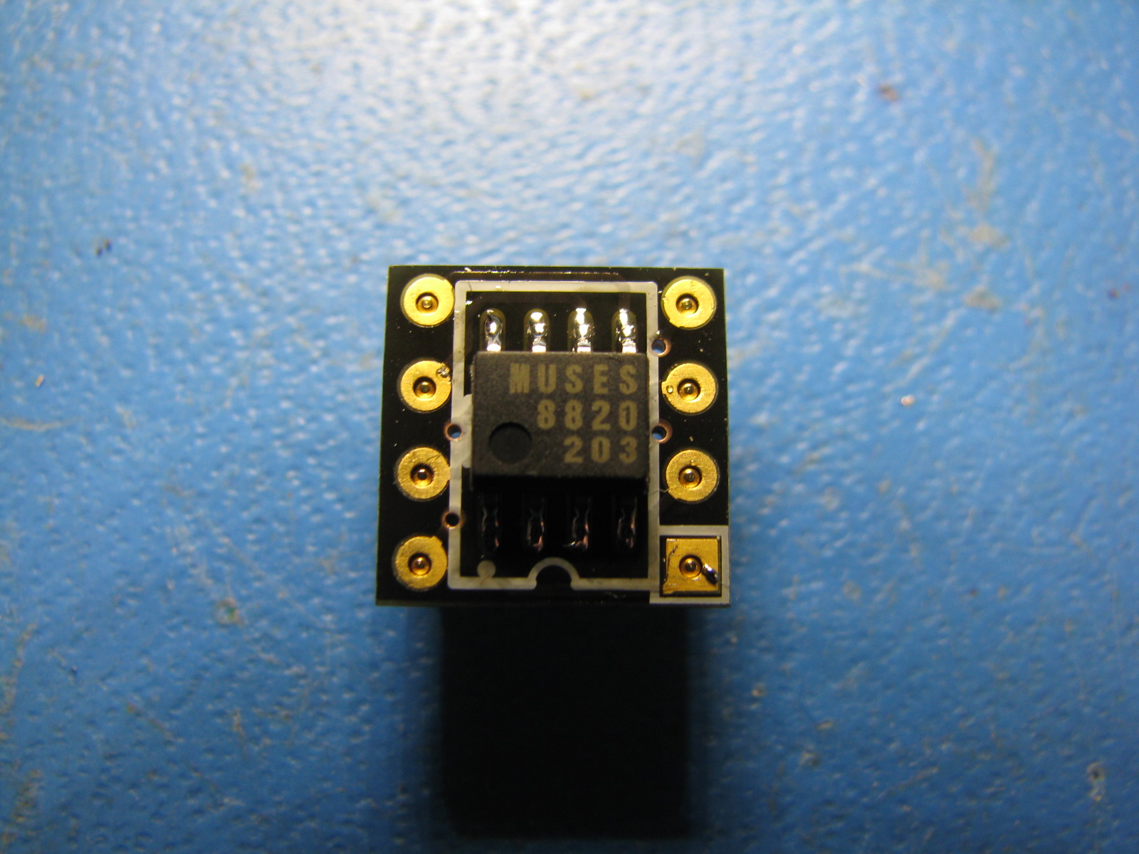

Hi, sorry about the delayed reply. :) I agree, the LM4562/LME49710 (same chip) & OPA2227 should work, although it might be a small downgrade, given NwAvGuy's testing comments.
Hey *very* good thoughts about the muses 8820! I had forgotten about that. It is the "offical" upgrade from NJM. No need to send one, I'm pretty sure I have one that has been sitting here for the better part of a year. I'll solder it on an adaptor and let's see what happens. This might turn into a fantastic upgrade. Great suggestion!
Just a quick summary on the muses chips (at Mouser) for anyone else reading this. NJM created this muses series a couple of years ago as their high end audio chips. The first ones were the muses01 (jfet) and muses02 (bipolar) in DIP8 packages that go for the rather breathtaking price of $46 each, with almost zero technical justification for the cost in the datasheet. Then they came out with what they describe as their "mass market" version of the muses (the 01 and 02 are supposed to be hand-trimmed during production according to some marketing material), the muses8820 (bipolar) and muses8920 (jfet) for a more reasonable $10 & $12. So if someone wanted to drop some serious money into their O2 as a test it would also be possible just to plug in a muses02 in place of the NJM2068. But again it may oscillate and you would be out $50. :) At $10 the muses 8820 is worth the test. The GBP of these chips are even less than the NJM2068, around 10MHz for the bipolar, so there should be a very good chance they won't oscillate in the O2.
No worries!
I got the DIP8 version of the 8820 and tried it in different diy-projects I have, among them, a riaa-preamp and my O2:s (with booster boards!) and it didn't get warmer than finger-warm, where the LME49990s on adapter would get boiling hot. So I guess it's doing fine. But I don't have the means (nor the knowledge) to do measurements.
In the end, I am back to using the 2068 in my desktop O2, and the OPA2277 in the battery powered low power version (both with booster board!).
Another thing that I am wondering about is whether or not it would be possible to use Li-Ion 9v batteries instead of the Ni-MH ones. I read somewhere that the ones that have a protection circuit should accept a charge as long as it is voltage constant, which, if I understand correctly, it is in the O2's charging circuit. Is that even remotely right?... Sorry if it is a dumb question!

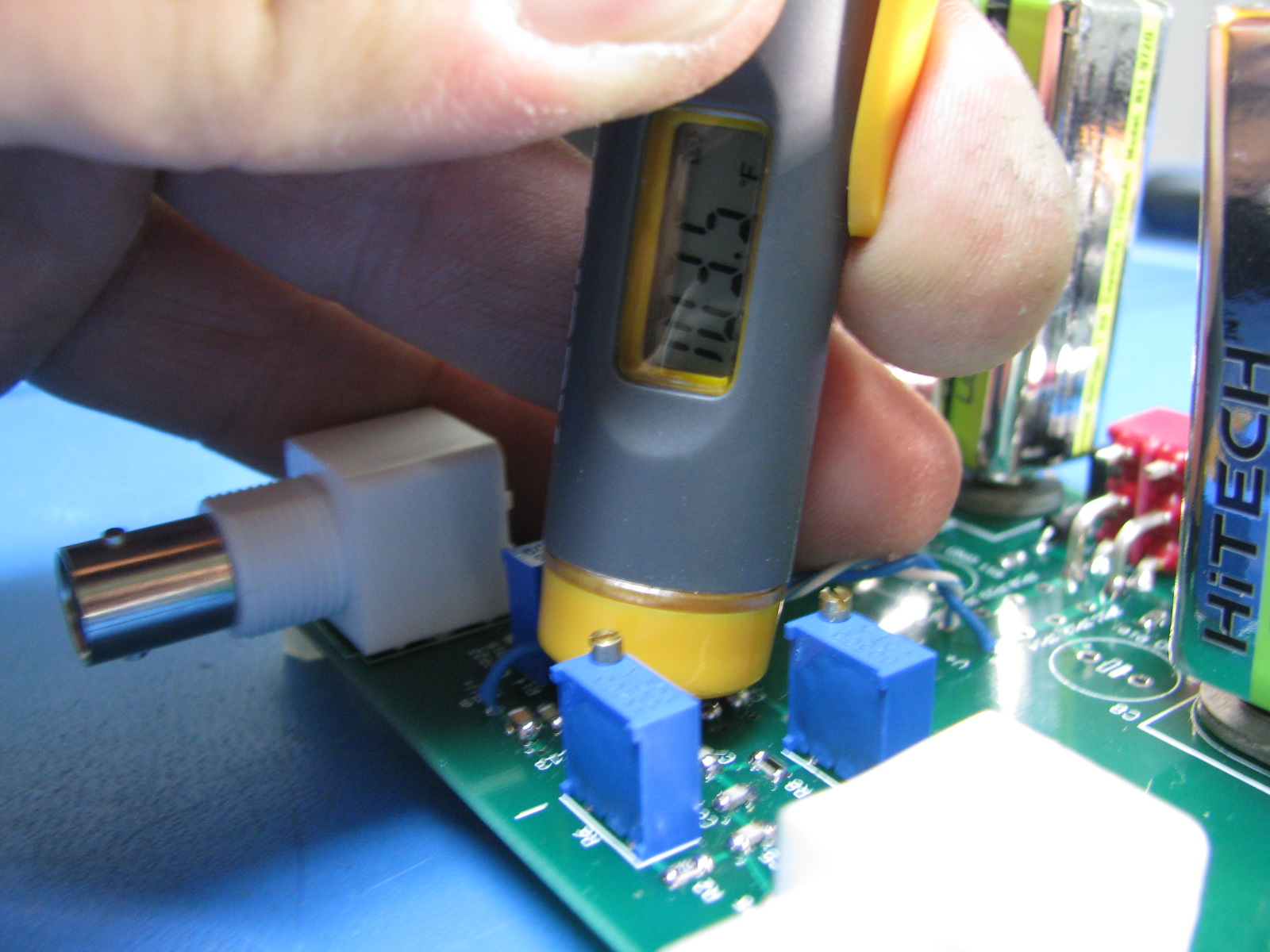

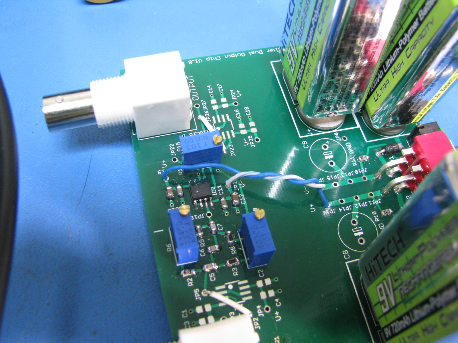

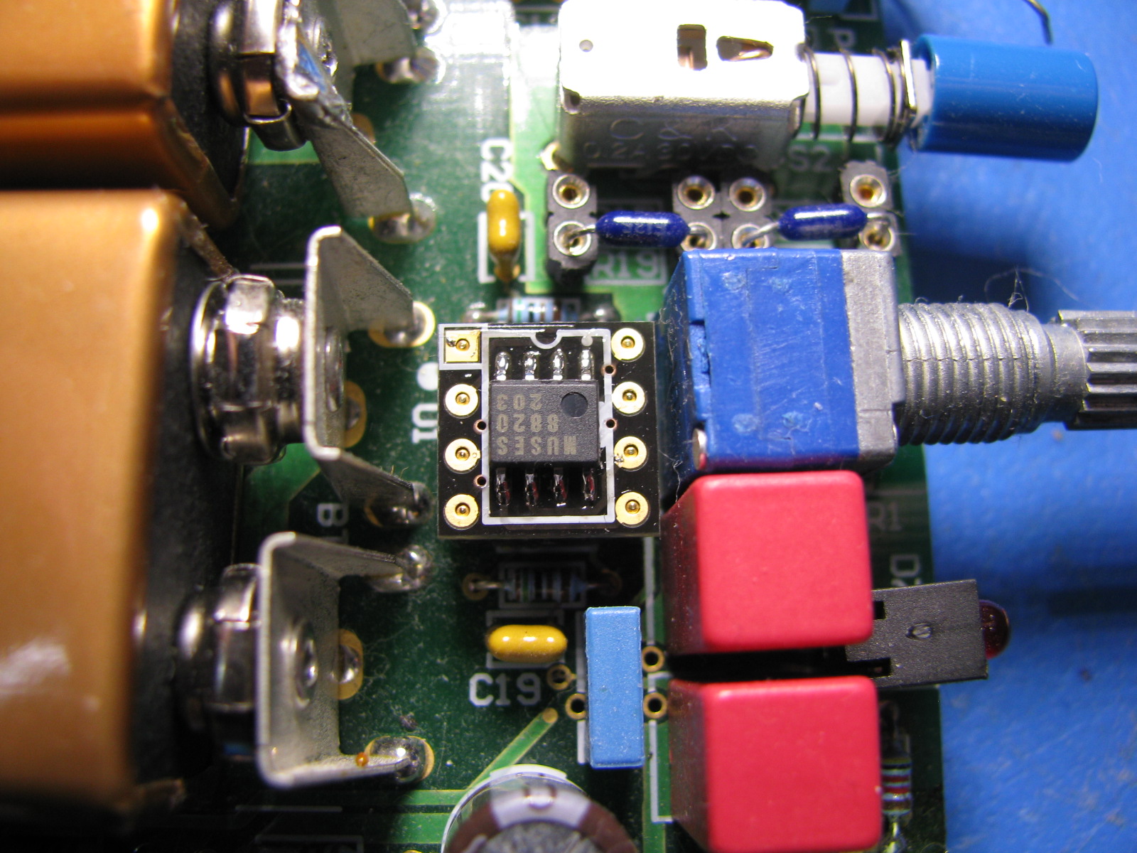

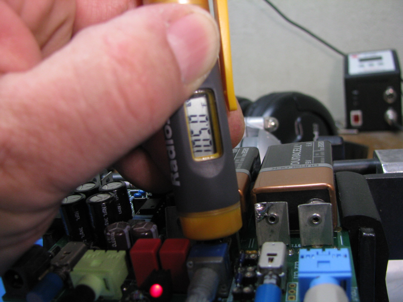

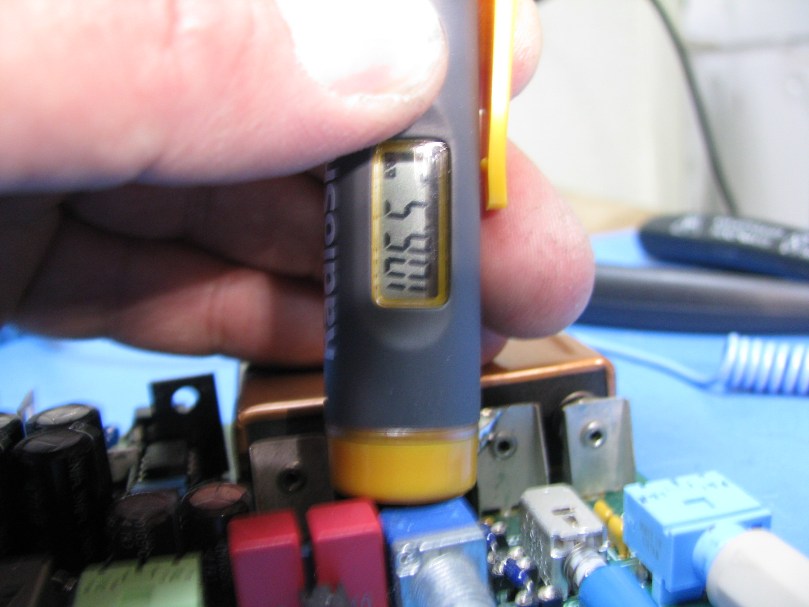

Chiroshi - the muses8820 works! :D Photos below.
Based on these results I'm going to revise my opinion about the OPA1612, I think it was working just fine too. Apparently 110F is OK, given the 1.5K load on both halves of the chip (the O2's feedback resistor). 40F less than the NJM49990 was running at! I don't see any oscillation on the scope, even when I probe right at the pins on the chip. Same was true with the OPA1612. I'm guessing the larger DIP8 package is dissipating heat better hence the lower package temperature for the NJM2068. I'll find some package thermal resistance numbers on a datasheet somewhere and verify. I see that the quiescent current in both the muses8820 and OPA1612 (x2 datasheet number to get both chip halves) is about 40% more than the NJM2068. That can account for some additional chip heating.
Photos:
* 4832 is the muses8820 soldered onto the adapter and 4833 is the adapter installed in an O2.
* 4334 is the 8820's temperature reading. The highest I measured was 107F, very similar to the 110F for the OPA1612 but miles away from the 150F for the LME49990.
* The final two are an OPA1612 soldered into a another project of mine, a Hall notch filter with much better decoupling, just as another data point on temperatures. The notch filter has a 0.1uF and 4.7uF X7R 0805-sized SMD ceramic on each power rail, with a solid ground plane on the board. Yet the temperature reading here is in the ballpark of the O2 readings at 103.5F. Especially given the much lighter load (around 7K) on the notch filter than the O2's 1.5K. The notch board is running at +/-16.4Vdc though vs. the +/-9.2Vdc in the O2. At this point I think those 100F-or-so O2 readings must be perfectly normal, no oscillation.
The muses8820 sounds great, as did the OPA1612! Both are viable "upgrade" chips to try in place of the NJM2068. :)

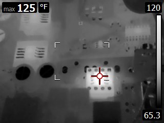

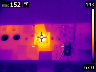

Parts finally came in - I soldered up a 1612 and swapped out the 2068.
Sounds good but it def does seem a bit toasty.
125F-130F where the 49990's were 150F-155F.
Wondering if I should of grabbed a muse while I was at it...
