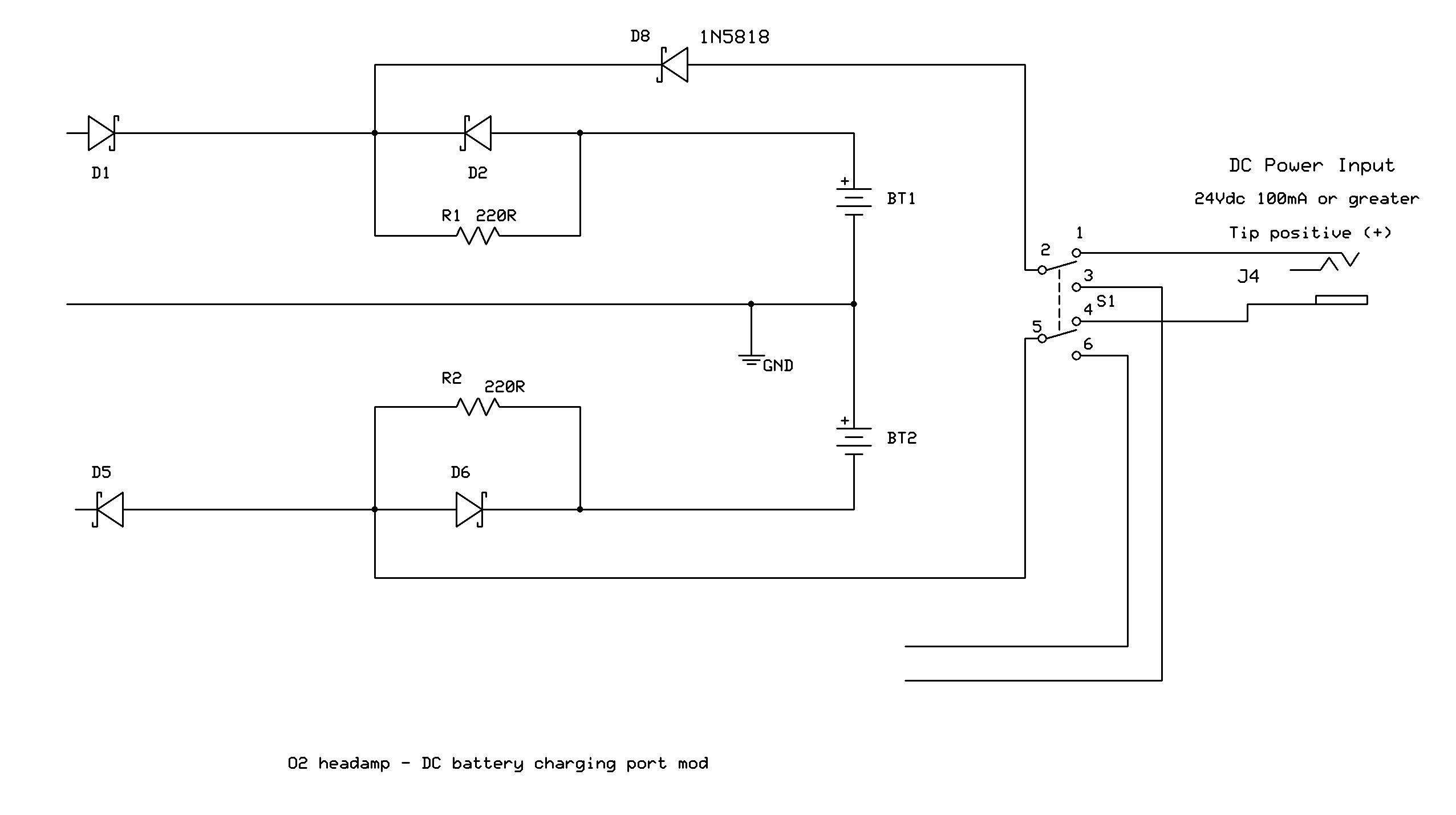

You would also need to change the battery charging circuit resistors.

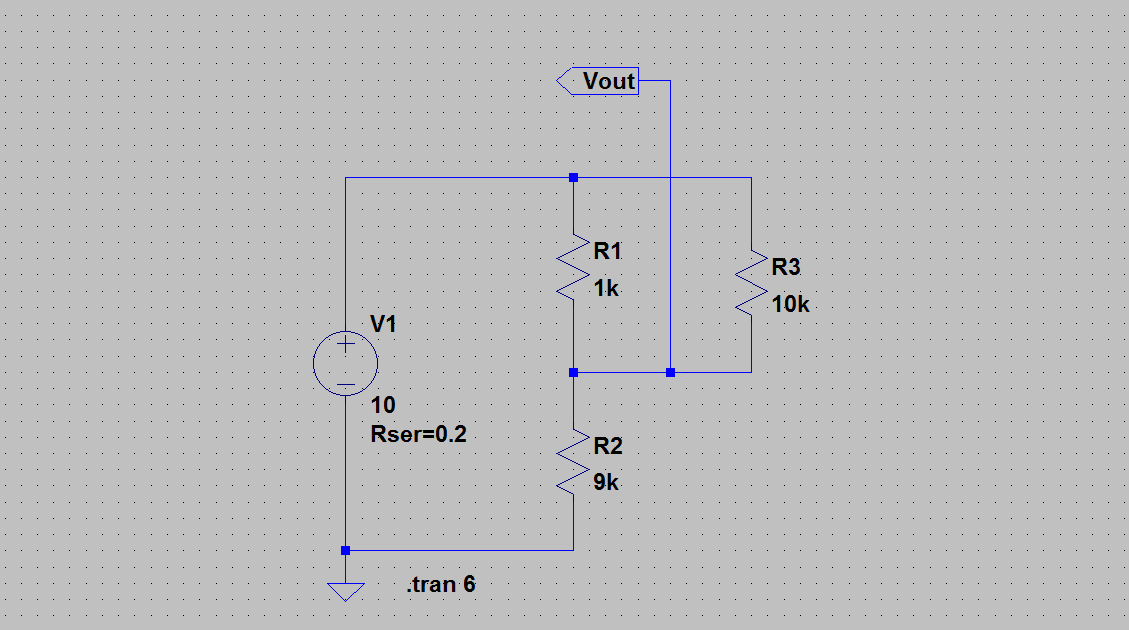

I was able to confirm the issue of lower R12/R13 values loading the pot. But flipping that around and doing it on purpose turns out to actually be worthy of another mod, so I'm writing this up that way. :D
As it turns out the coupling capacitor would make no difference on a reduced value R12/R13 loading the pot (vs. connecting the load resistor directly), at least between roughly 20Hz to 20kHz, since the capacitor is a short for all practical purposes at those frequencies. Conceptually just like connecting R12 or R13 to the pot directly. That means the lower value of R12 and R13 will affect the pot's taper curve, or how the resistance changes vs. rotation, the same as with a DC connection as far as the signal pass through is concerned. And as I remembered the effect is to convert a linear taper into more of a logarithmic (audio) taper.
But... flipping that around, a linear pot could actually be used on purpose in the O2 instead of the log pots specified in the BOM, and then "converted" into an audio taper by an even lower value of R12/R13. And those lower values would in turn produce even lower offset voltage numbers. Again, just a reminder here to anyone reading, lower offset voltage in the O2 is not needed in any way. The existing circuit already produces very low offset voltages. This is just messing around for modding fun. :)

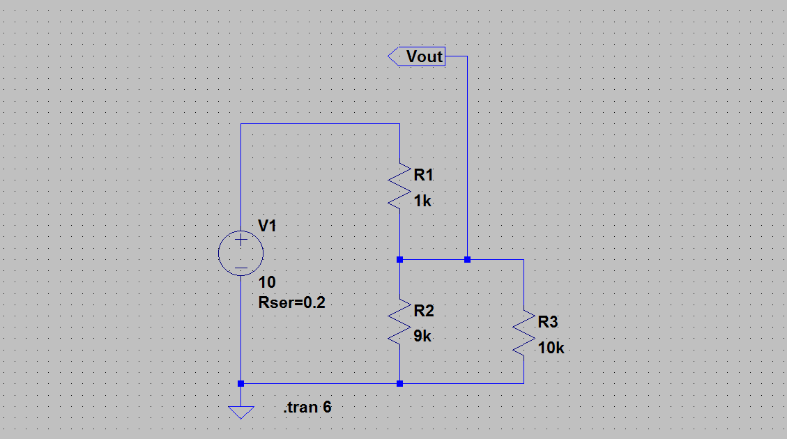

I couldn't find a way to produce a variable resistor in LT Spice to simulate the setup. Instead I did it the old fashioned way of setting up a test circuit sim, changing the resistor values manually, and then plotting and graphing the points.

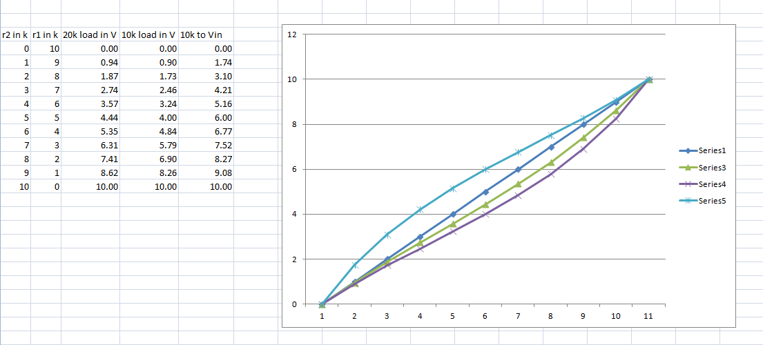

The first circuit below shows a pot (R1 + R2) in series with a load R3. To make the "pot" work when I increased R1 by 1K I would decrease R2 by 1k, etc., plotting 10 points from 0k to 10k. I did one set of plots for a 20k load (R12 and R13 reduced to 20K) and another set for a 10K load. The third set of plots shows the load returned to Vin rather than ground which would be useless for the O2, but shows how that configuration inverts the curve.
I then plotted the points, which can be compared with the Alps pot taper curve on bottom of page 359 of the datasheet here
http://www.alps.com/WebObjects/catalog.woa/E/PDF/Potentiometer/MetalShaft/RK097/RK097.PDF
From the graphs the 10k load is more-or-less similar to the 15A taper. None of the curves reproduce the 3B taper curve though that the original RK097122008T pot in the BOM has, as can be seen. Note that any of these tapers have the same endpoints (minimum volume of 0k and maximum volume of 10k) of course. The difference is just the shape of the curve between those two points. :)
So.. to summarize... the O2 pot could be replaced with a 10K linear taper
PTD902-2015K-B103 Bourns Potentiometers
http://www.bourns.com/data/global/pdfs/ptd90.pdf
and R12 and R13 replaced by 10K resistors to purposely load the pot and re-create an audio taper, while dropping the output offset voltage a bit. I couldn't find a suitable linear Alps pot - Alps only seems to have dual gang 10K in log tapers, except for one with a center detent - but Bourns did have a linear 10K here in their pro audio line.
Series 1 in the graph below is the value of R2 column, which is linear of course. The series 3 and series 4 graphs are the 3rd and 4th columns, the voltages across the 20k and 10k pots returned to ground (first circuit diagram) with 10Vdc coming in. 10V is roughly the peak input voltage to the pot with a 7Vrms signal output from the O2 first stage. The final graph, series 5, is the last column with 10K load now returned to Vin, as in the second circuit diagram.

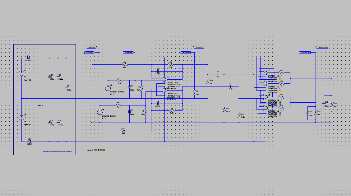

O2 +/-18V rail LME49860 600R headphone mod
After just posting an 18-20V power supply rail mod for the Wire amp, specifically with hard-to-drive 600R headphone models, I realized that a similar thing would work for the O2, so here goes. :D
The secret is that the higher impedance 600 ohm headphone load draws significantly less current. The amp really doesn't need much, if any, current buffer anymore for such a high impedance load. A single chip LME49860 CMOY would almost do the job. In other words, what is needed is more voltage rather than more current in this case. Another enabling factor is the LME49860 being unity-gain stable, so it can also be wired for the parallel output buffers in the O2 as well as the first stage gain chip.
A safety note up front. Best not to try this with less than 600 ohm headphones or a person stands a real chance of damaging their headphones if the volume were to be turned way up. And even with 600 ohm headphones this mod would be completely unneeded for moderate to good sensitivity headphones. It is just that magic hard-to-drive combination of 600 ohm and low sensitivity that this mod may have some value for.
The mod raises the power supply rails to +/-18v, replaces the NJM2068 and NJM4556 chips with higher voltage LME49860 dual low-distortion audio op amps (rated to 44V maximum, = +/-22V rails max) and the NJM2093D comparator with a higher voltage (40V maximum) LT1018 dual comparator. Here are the spec sheets for these parts:

The NJM2068 (U1) and the NJM4556s (U3, U4) are all replaced with LME49860 DIP-8 chips.
The gain resistors may need to be increased to take advantage of the new 14V maximum swing available. In the simulation below a 240R gain resistor with a 2Vpeak input signal (1.4Vrms) resulted in a 14Vpeak output (9.9Vrms) into 600 ohms.
I've tried replacing U1-U4 with the LT1018 and LME49860 chips with the regular +/-12V rails just now, so I know that much works OK for certain. :) I'll have to swap out the regulators and get in the 20V transformer to actually test things at +/-18V rails - so for now the higher +/-18v rails here are untested. Builder beware!
As for performance, the measurements for this mod shouldn't be any worse than the stock O2, and actually stand a chance of being just a tiny bit better (into 600 ohms ONLY!). The LME49860 chip shows either the same numbers or very slight improvements in all areas over the NJM2068 and NJM4556 chips. However, as RocketScientist has pointed out many times, the NJM chips are around 50 cents each while this chip is $4 a pop! But the main reason a very slight improvement may be had is that the output chips are also LME49860s. As RocketScientist has said, the NJM4556 output chips are really the limiting factor on one or more of the measured parameters, meaning just changing out the first stage gain chip alone isn't likely to improve anything regardless of how "good" that chip is. The NJM4556's are a slight trade-off for current capability. That wouldn't be the case here.
Again, good time to re-iterate, this mod only has use with 600 ohm hard-to-drive headphones. Any lower impedance headphone could be severely damaged if the volume were turned up and it was hit with the higher voltage available with this mod. So there is no performance improvement to be had here in general, just possibly some amount so small that it would only show up on RocketScientist's equipment (probably not even audible) and then only for 600R phones.

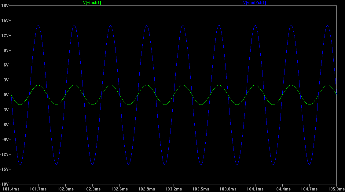

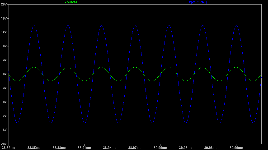

Sim results below. 14.0V is the highest output voltage swing before the chips clip into 600 ohms in parallel with 390pF (cable capacitance). 14v peak is only 14v / 600R = 23mA, which would actually be within the 28mA current capability of just one LME49860 chip, according to the datasheet. A person could do this whole thing as just a single chip CMOY! keeping the separate output design in the O2 though allows the use of the volume pot in the middle with the associated benefits. Since each output chip is in parallel with the O2 that is only 11.5mA through each half section of the output LME49860s, well within specifications.
The green is the 2V peak input signal and the blue the 14V peak output. The first plot is 2.5kHz, the second 25kHz and the third 10Hz.

O2 amp - DC power jack mod for battery charging only
Would it be possible to feed the amp with DC, mainly to charge the batteries. I don't mean necessary on the onboard AC connector, I could tap someware and add an extra DC input.
I'm posting this reply from the O2 thread here so as not to muck up RocketScientist's thread with modifications. :)
I should also note right up front that this project may not buy a whole lot over simply using the WAU12-200 AC adapter for the O2 that RocketScientist has specified in the BOM. That adapter is about the same size as most 24Vdc 100mA adapters. If all you are doing is charging the batteries it has plenty of power.
Here is one way to do it, although RocketScientist may have a slicker way. :) A DC input jack (J4) and Schottky diode (D8) could be connected as shown below to the unused pins 1 and 4 on the power switch, then fed with a DC adapter that is 24Vdc and at least 100mA capable. The adapter should be 24Vdc only - rated nothing higher or lower. This arrangement works for charging the batteries - your request - but would not run the amp to produce sound. You can get to the unused pins 1 and 4 on the power switch underneath the O2 PCB, then run the wires back up through one of the PCB holes if you need to wherever you intend to mount the DC jack.
Here are the details. This one is essentially a modification. :) This mod works because the DPDT power switch that RocketScientist specified is non-shorting, meaning that it breaks the connection to the rest of the O2 (power management circuit and signal path) before making the connection to the single-rail DC adapter. Since there is no ground wire coming in from the power source in this case (not a dual rail power adaptor) there would be no way to run the rest of the O2 properly, so the rest of the circuitry has to be switched out like this.
Then Maha Powerex tech support tells me that it is OK to charge two 8.4V NiMH cell in series like this if the charging currents are limited to essentially trickle rates, which is what the two 220 ohm resistors R1 and R2 that RocketScientist have in the circuit do. In this arrangement the power flows from the DC jack around the reverse-biased D2 and D6, through the 220R resistors to the batteries, just exactly as happens from the O2's voltage regulators when those are used on AC.
In this case through instead of 12Vdc across each battery individually with each having a 220R current limiter, we are applying 24Vdc across both batteries in series and using two 220Rs in series to limit the current. Equivalent circuits either way. The ground no longer works, or is used, but it doesn't matter just for charging in this arrangement.
D1 and D5 are reversed biased in this setup and block current flow back into the voltage regulator circuits. A new Schottky diode D8 is added to prevent current flow from the voltage regulators back to the DC adapter under a special circumstance. The issue here is that if both voltage regulators were at the high end of their specifications, +12.2V and -12.2V, that would give 24.4Vdc from negative to positive rail on the input side of D1 and D5. Minus the 0.2V Schottky drop that leaves 24Vdc on the other side of D1 and D5. If the DC adapter were then less than this, such as 23.6Vdc, current would flow from the O2 voltage regulators into the DC adapter.
So with D8 added it doesn't matter if the AC adapter is plugged in or not when the DC adaptor is plugged in. The Schottky diodes will figure it out. :) If the O2 voltage regulators produce a higher voltage they will be used to charge the batteries. Otherwise the DC adaptor will will win (which should be the case with the vast majority of "24Vdc" adapters from my experience, they usually run at 24.5Vdc - 28Vdc) and charge the batteries.
Please post a picture if you build it! :D
