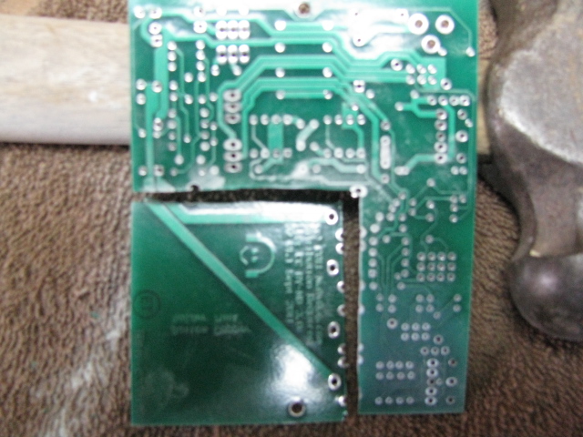

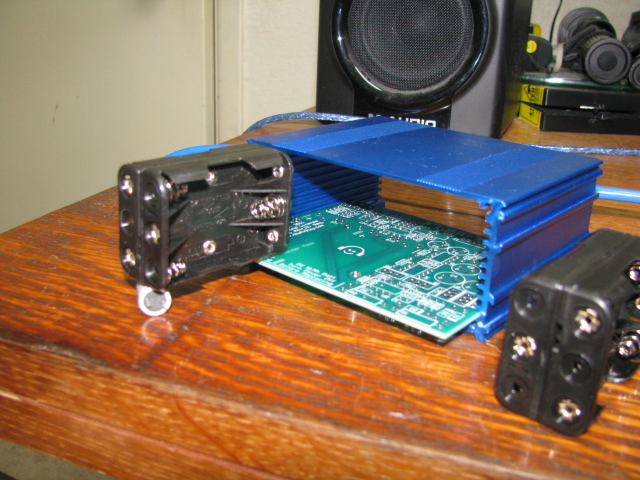

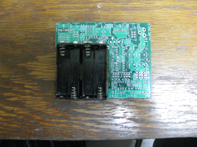

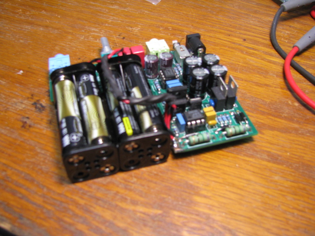

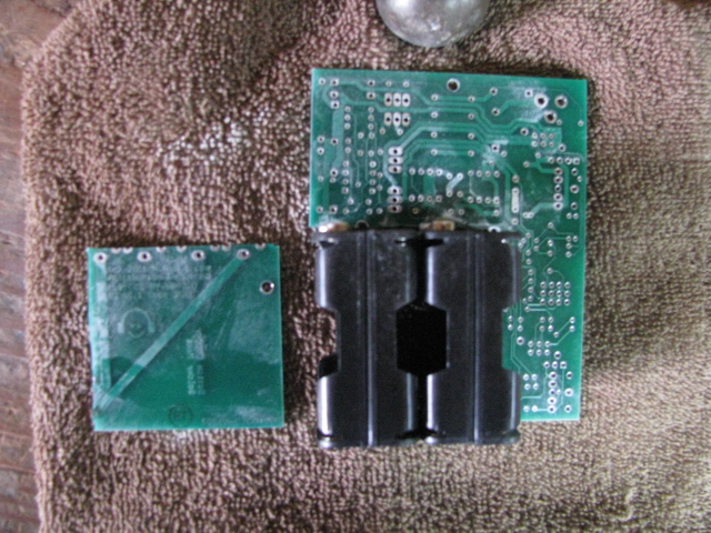

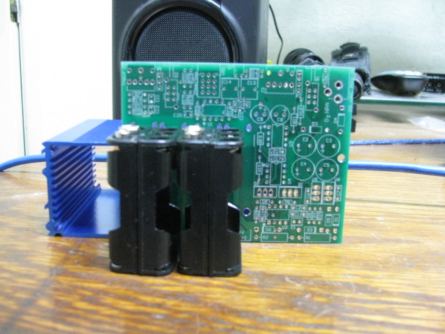

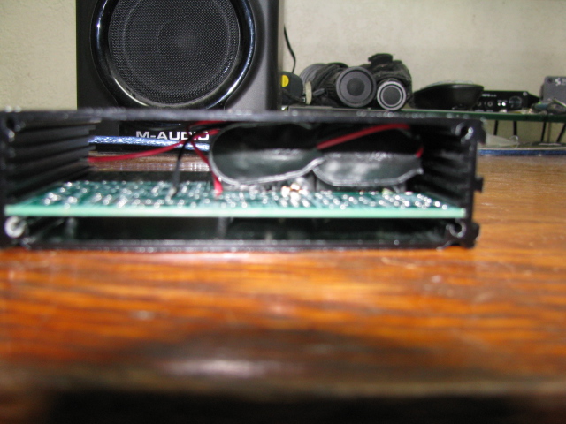

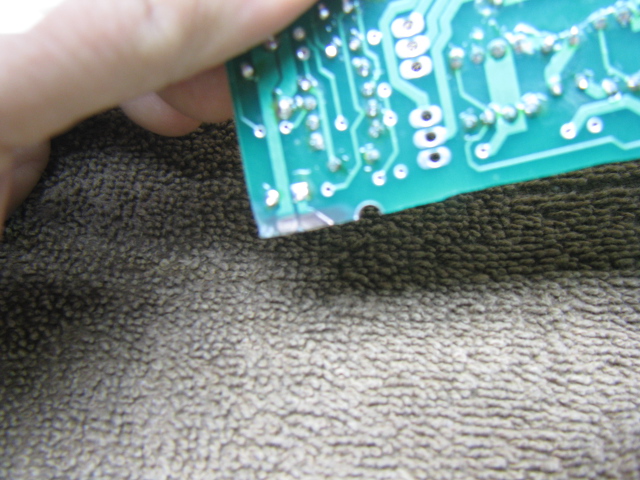

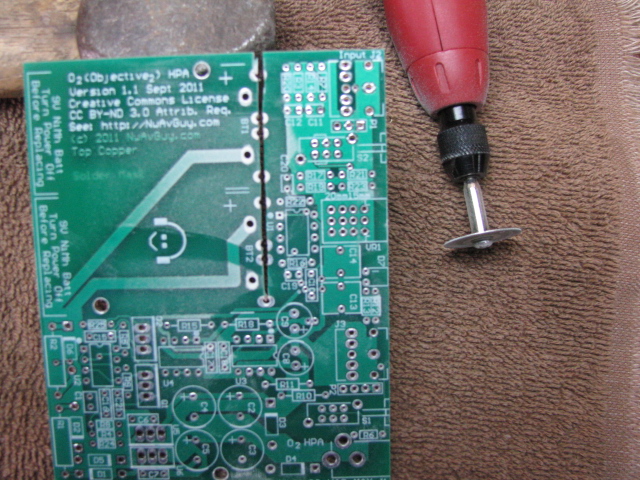

notching the O2 headphone amp PCB for AAA cell packs
I figured that I would give the notched-PCB mod I posted last November, above, a try. I'm going to build up a low(er) voltage unity gain version of the O2 with 4x the run-time of a standard O2 headphone amp using two 6-cell 1000mAhr NiMH battery packs.
The first photo shows a new O2 PCB (this one happens to be from JDS Labs), two 6-cell AAA battery holders with snap connections from Mouser
12BH463B-GR Eagle Plastic Devices | Mouser
and a B3-080 chassis from Allied. In the post above I gave a link for the same AAA pack at Mouser with wire leads coming out. That works too, but I figured that I would go with snaps to remove the packs easily if I want. The next photo shows why the O2 PCB has to be notched. The 6 cell AAA holder is just a bit too tall to fit in the B3-080 box sitting on top of the PCB board. The next photo shows what is going to happen to the PCB. A high speed hobby tool with a diamond cutting wheel.
The first cut in the next photo is right through the middle of all the O2's battery terminal pads, which makes lining up the cut super easy. I just free-handed the cut. It literally feels like cutting through soft butter, not very difficult. Note in this photo you can see the two large PCB traces on the top of the cut-out section that go from one terminal of each battery to connect together on the trace that goes under R2 to form ground. This is where the same two wire leads from the new battery packs should connect too also, forming a star ground.
The next photo shows the other side of the cut-out section. Here you can see the B+ and B- traces and where those two wires from the battery packs will need to connect. The notched out section only removed these power and ground traces going from the batteries. No signal lines needed to be cut!
The next two photos show how the 6 cell AAA packs fit right into the new notch. The final 3 photos show how the whole thing fits just perfectly into the B3-030 chassis.
The new 6 cell packs will be around 1.45Vdc x 6 = 8.70Vdc when full charged and around 0.9Vdc x 6 = 5.40Vdc when discharged, at the time the power management circuit should kick in to disconnect. To make the O2 work with the new slightly lower battery voltage the following in the O2 would have to be changed:
* R1 and R2 changed to hit a C/40 or C/30 trickle charge endpoint. AAA NiMH cells seem to be available in capacities (C) of around 700mAhr to 1000mAhr.
* R9 changed to make the power management circuit turn off at 0.9V x 6 x 2 rails = 10.8Vdc.
Everything else stays the same in the O2 amp. The chips are all rated to work OK at the minimum voltage +/-5.4Vdc power rails. The output voltage swing will be +/-1.2Vdc less of course, but the runtime will increase over the 250mAhr "8.4Vdc" cells by 2.8x (700mAhr NiMH AAA's) up to 4x (1000mAhr NiMH AAA's). If a standard O2 amp will run for around 8 hours on the two "8.4Vdc" NiMH batteries, that means increasing the run-time to 22 - 32 hours with these "7.2Vdc" nominal AAA cell packs!

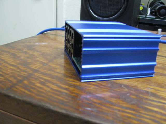

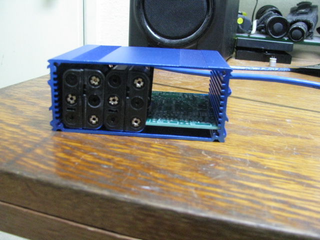

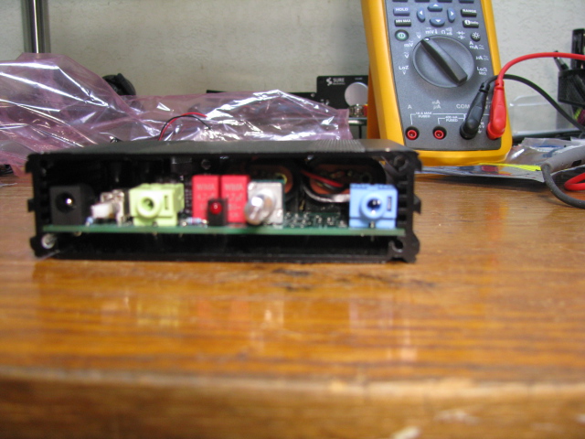

notched O2 headphone amp PCB with B2-080 and 4xAAA

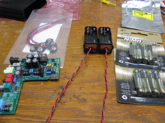

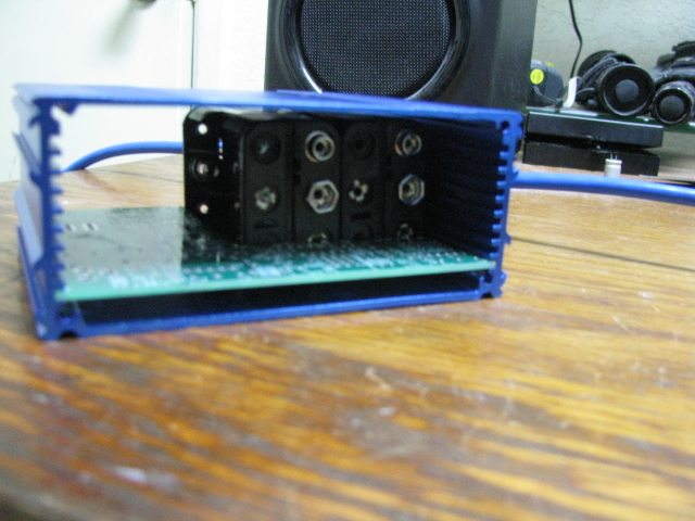

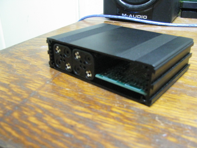

Here is something else that can be done with the notched-out O2 headphone amp PCB that I just posted above. Turns out that two 4-cell AAA battery packs will fit fine in the notch in a standard B2-080 chassis!
4 AAA NiMH cells lowers the nominal rail voltage to 1.2Vdc x 4 = 4.8Vdc each, reducing the maximum voltage swing on the output by at least 3.6Vdc, so this version is best suited to high-sensitivity low-impedance headphones that don't require a large voltage swing.

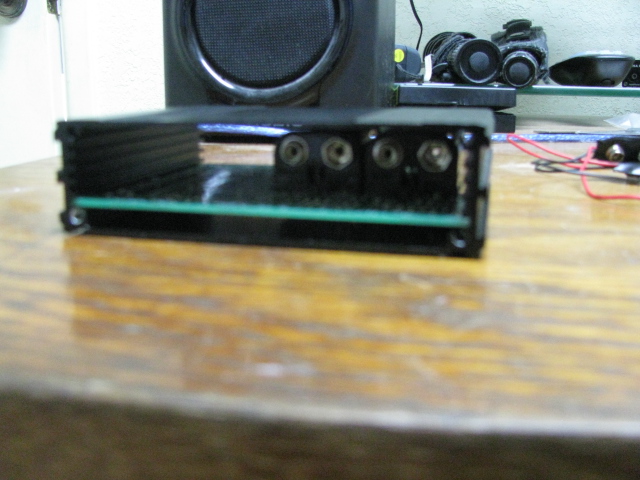

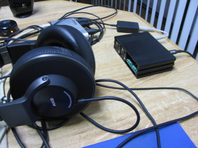

The first photo shows the B2-080 case (from Allied), battery holders (from Mouser), and notched PCB, same one as in the post above. I again used the battery holders with snaps so I could use them with wire-lead snap connectors for easy removal. But Mouser also has the version that just has wire leads coming out that can be soldered right to the PCB. Here is the Mouser part:
http://www.mouser.com/ProductDetail/Eagle-Plastic-Devices/12BH443B-GR/?qs=%2fha2pyFaduhzLyBTuuav3fDSqvHW%2ffl452QsSgmJ5%252b%2ftJ2u9lZbPKQ%3d%3d
The next photo shows how the two 4-cell AAA holders fit into the notched-out battery area on the PCB. This is the same notch I cut in the post above for the 6 cell holders, so the notch is a little bit wider than needed for the 4 cell holders as can be seen on the right side.
The next two photos show the whole assembly in the B2-080 case. Perfect fit! The final photo shows the wire lead battery snaps attached to the batteries. Each pair of two wires should be twisted together, then those bundles run on top of the batteries (there is room between the batteries and the top of the case for this) to the PCB trace connection points.
Making the 4 cell NiMH battery packs work with the O2 is similar to the above post for 6 cell packs, same three changes (R1, R2, & R9), but with two additional twists. The U1 NJM2068 chip is only rated down to +/-4Vdc rails, which isn't enough for the lowest battery-cutoff level of 0.9Vdc x 4 = +/-3.6Vdc. U1 would have to be replaced with a LME49720 chip which is rated down to +/- 2.5Vdc power rails. RocketScientist reviewed the LM49720 in his blog posts, as I recall, and it was at least at good as the NJM2068 in all areas (better in several). The only problem he noted was the cost - $2.50 vs. 0.50 for the NJM2068. The other difference is the voltage regulators have to be reduced to 9Vdc to make the O2's battery trickle charge resistor scheme work right - LM7809 and LM7909. That gives "on AC" power rails in this one of +/-9Vdc with nominal "on batteries" rails of +/-4.8Vdc.

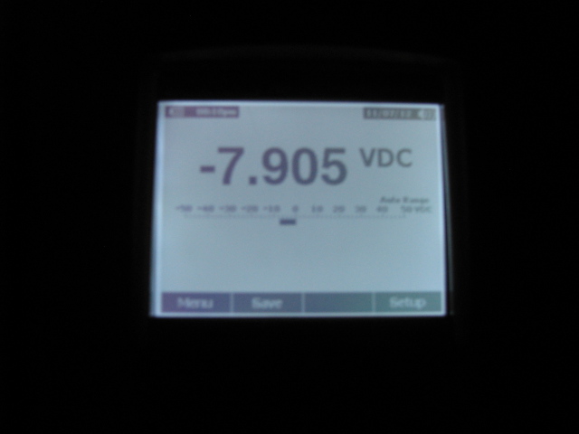

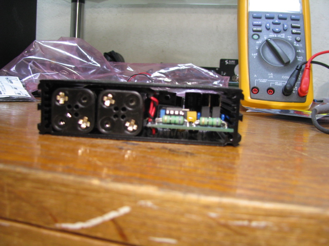

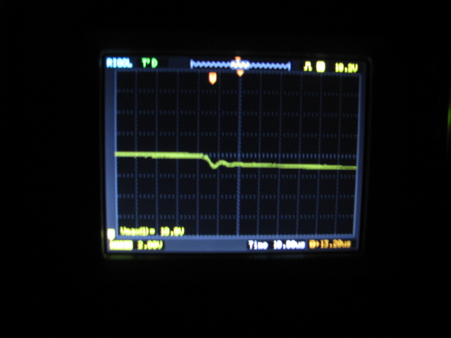

O2 amp 2x4 AAA +/-8Vdc power supply measurements

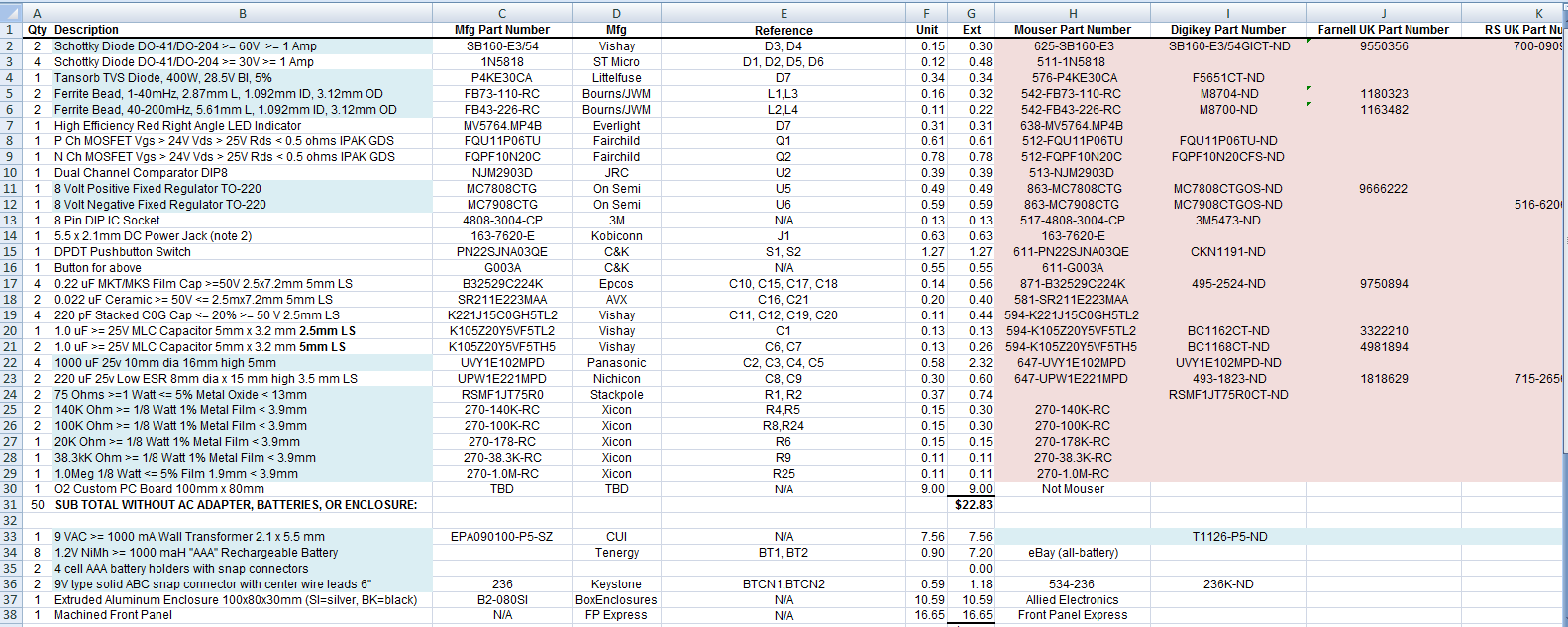

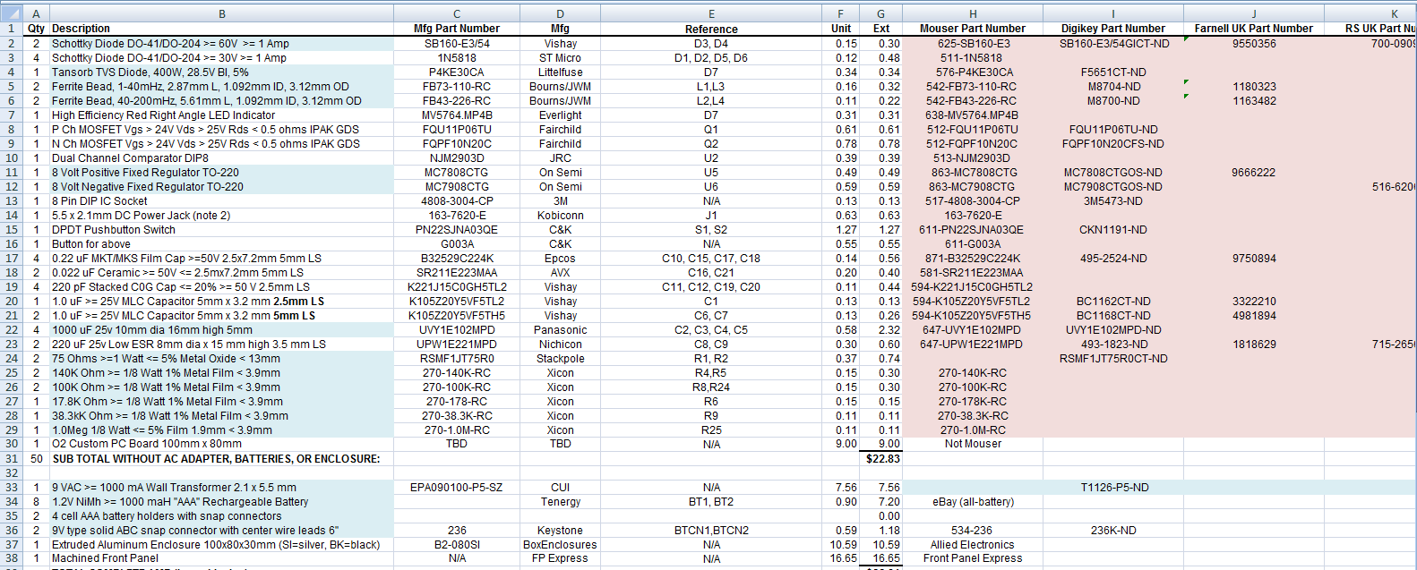

I decided to build up the 2 x 4-cell AAA NiMh RocketScientist O2 headphone amp in the B2-080 case, with the notched PCB above, rather than the 2 x 6-cell verson. None of my headphones need more than a couple of volts of output swing, so may as well go with the smaller B2 chassis. The DIY buildup of the 2 x 6-cell AAA NiMH version would be similar.
Attached is a modified version of RocketScientist's O2 BOM with the new/changed parts in blue if anyone else should want to try this DIY build. I wound up placing the order with Digikey because Mouser does not have 9VAC transformers. But I've included Mouser and some Farnell and RS Components crosses too.
Details...
Turns out +/-8V rails and regulators are a better choice than +/-9V, as I wrote above. Drops the voltage overhead to the NiMH cells to 2.0Vdc, same as the standard O2, which allows for the same trickle charge scheme. On the regulator input end the lower regulator voltage provides an extra volt of regulator overhead which, along with 1000uF caps and schottky rectifier diodes, allow just a 9VAC transformer to be used.
Since the 9Vac transformers have unloaded voltage of around 12vac - 13Vac, the highest peak voltage will be around 18V. That allows the filter capacitors to be dropped down to 25V from 35V, which in turn permits the capacitance to be increased to 1000uF each from 470uF in the standard O2. The higher cap in turn decreases the ripple voltage and increases the minimum voltage going into the regulator, preserving the data sheet recommended 2.5Vdc drop across the regulators.
To help reduce conducted EMI (cell phone radiation coming in on the power cable) and nuke line transients I've added ferrite beads to the rectifier diodes, which are now schottky to save 0.4V drop each. I've put a 28.6Vdc breakdown bidirectional Transorb (TVS) diode across the power input jack under the PCB (across the transformer secondary).
The battery manufacturer says continuous trickle charging of 10mA -30mA is OK for the AAA NiMh cells. I've picked 26mA, giving a value for R1 and R2 of [(8Vdc - 0.2Vdc schottky) - (4 cells x 1.45Vdc charge endpoint)] / 26mA = 75R. These are specified at 2W to cover the case where one AAA battery pack completely shorts out leaving 8V across the resistor.
The first two photos shows how the ferrite beads on the revised BOM are placed on the schottky recifiers diodes. BTW, this good idea is not mine! I learned about this from a DIY amp in another forum. The diodes are now mounted on end (tombstoned) with the beads on the flying lead. A 1-40mHz bead is stacked with a 40-200mHz bead to form a wideband filter, as per a JW Miller app note. The 200mHz bead is longer and is best placed on the top.
The next photo shows the TVS diode from the BOM soldered across the DC input jack. I bent the diode leads around the pins first, before soldering. Helps to solder the unused 3rd lead on the jack first to hold the jack, then solder the other two. The diode is bidirectional, so there is no "right way" or banded end.

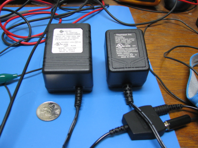

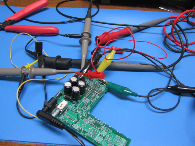

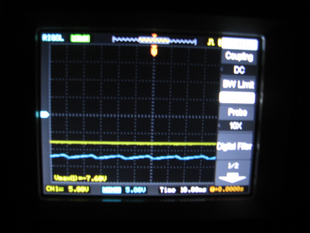

The next photo shows the test setup. I'm only building up and testing the AC power supply section now. Turns out every resistor in the power management circuit has to change to work correctly with the lower rail voltage. All those values are in the revised BOM and will be tested later. It is hard to see from the photo, but the "battery end" of R1 and R2 (now 75R) are grounded with test clips to supply a [(8V - 0.2V) / 75R] = 100mA load on each power supply rail. Dead batteries being charged will be about 50mA, the chip quiescent current with NJM4556s are about 22mA, and the headphone load is expected to be up to 25mA, for a total of about 100mA. Hence the 100mA dummy test load.
The next photo shows two 9Vac transformers being tested. The bigger one is the 9Vac 1A unit on the BOM. The smaller is a 9Vac 400mA sourced locally. Digikey has a 9Vac 500mA unit for just 70 cents less. I picked 1A to cover maximum secondary current de-rating for the half wave rectifiers, as per a Hammond rectifier app note.

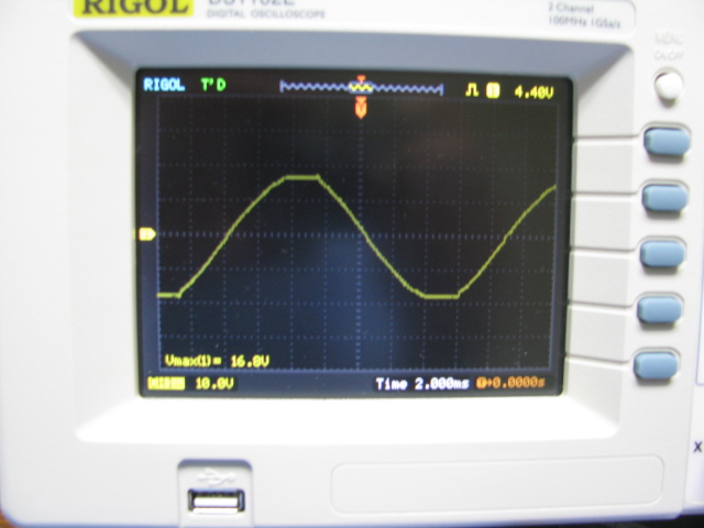

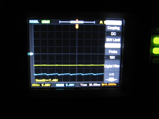

The next two photos show the negative rail scope traces for the MC7908 regulator output (yellow) and input (blue) for the smaller transformer, along with a DMM reading on the regulator output voltage. Minimum output voltage below the ripple with the 100mA load is about -11.7Vdc, leaving -11.7V - (-7.9V) = -3..8Vdc minimum across the regulator. The data sheet makes a big deal about maintaining 2.5Vdc across the regulators, even though their dropout at that low current is about 1Vdc. The incoming ripple with the two 1000uF caps is just -0.7Vdc from the scope trace. The positive rail readings are not shown but similar.
The next photo is the scope trace with the larger 9Vac 1A transformer. Note the output voltage (yellow) is the same, as it should be, but the minimum input voltage is now up to -13.9Vdc and the ripple has increased to -0.75Vdc. The power dissipation in the regulator though is still just (14 - 8) * 0.1A = 0.6 = 600mW, hardly enough to even make the regulator tabs slightly warm.
Given these readings a 12Vac transformer could also be used. The power dissipation in the regulators would go up to around 1.2W each.
The final two photos are about the issue of diode and transformer secondary ringing (snubbers) given that the rectifier diodes have changed to schottky. In the first scope photo you can see the slight drop at the top/bottom of each waveform, on the rightmost portion, where the diodes turn off and ringing occurs. The final photo zooms in on the ringing to show about 7uS period (150kHz) and about three cycles before being fully damped out. From Hagerman's snubber paper the goal of a parallel C + R snubber is to damp out the ring in 2-3 cycles. The goal of just a parallel capacitor is to shift the ringing to a lower frequency (than 500kHz in his paper). Since both are already true here, no snubbers are required.

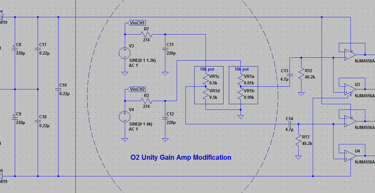

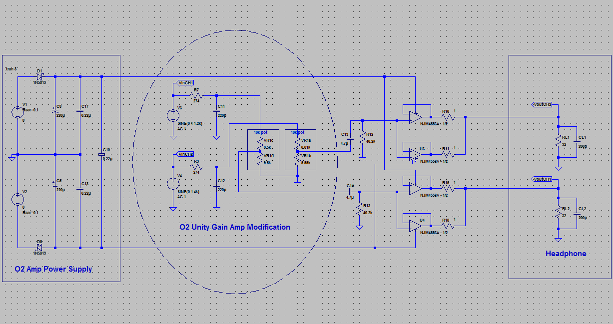

Here is the rest of the build-up of a 8-cell AAA RocketScientist O2 headphone amp with unity gain (no U1).
First a couple of corrections from above. First photo below is the missing test setup. I ran out of photo attachment slots on the post. The other is the datasheet recommended drop across the voltage regulators is 3.5Vdc, not 2.5, and the dropout is 2Vdc and not 1V.

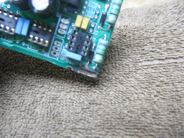

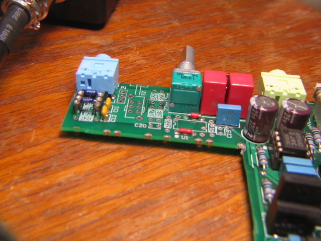

The next two photos show the PCB edges for the battery connections buffed down to the copper on both sides of the board with a wire wheel on a hobby tool. These are the traces that used to come from the battery connectors on the O2 PCB that were sliced when the board was cut. Here you just buff up the edges and solder the wires from the batteries right back on.
To wire the O2 for unity gain with U1 left off the board - input signal fed directly to the pot - the following parts are left off the board: R14, R16, R17, R19, R20, R21, R22, R23, S2, C19, C20. The PCB holes for U1 pins 1 and 3 are jumped, then 5 and 7 are jumpered.
The next photo shows the jumped U1 pins and all the parts above that are left off. The remaining resistors and caps in the input section photo are R3, R7, C11, and C12.
The next photo shows the DMM results with the amp running off the +/-8Vdc AC rails with a 32R AKG K550. About 3mV of DC offset, same as the standard O2 amp of course, and normal listing levels of about 50mV (rms).
The next photos show the battery holder and clip preparation. The center-wire 9V battery clips from Mouser point the wires down toward the PCB when attached, unfortunately. To solve that I cut off the ABS cover on the clips to allow the wires to go up and over the battery holders. Then twisted the leads and heat shrink tubing applied. Route the battery wire bundle over the top of the batteries and the down the right side to mate with the PCB edge contacts.
The two wires for "ground" are then soldered to the PCB edge pads on the top, with the positive and negative leads soldered to the pads on the bottom. The wires run down through the half-hole left from the PCB cutting.
The next two photos show how the finished battery holders + batteries fit into the B2-080 case.
The final photo is the finished modified amp, running on the 8 NiMH AAA cells and unity gain with no U1 chip (no NJM2068). Works great! From the simulations and sine wave scope shots that I'll post later, the maximum output swing into 32R is about 1V rms just before the (dead) batteries cut off by the power management circuit. Way more swing than is needed for the K550s at 50mV rms. On AC with the +/-8Vdc rails it will swing about 4V rms.

Below are attached the circuit diagram the input stage RocketScientist's O2 reduces to when the parts listed above are left off and the U1 part of the PCB is jumpered across. The input signal is applied directly across the pot (unity gain).
Although there is no gain, there is attentuation with the pot, which is what my sources require. I also left (and socketed) R3 and R7 which can be increased for further attentuation, to regain more range on the pot for higher voltage sources.
With the first stage U1 op amp gone the only clipping that can occur now is in the output stage, of course. C13 and C14 are still in place for DC blocking in both directions.
A revised version of RocketScientist's BOM is attached for the build. I made one change in a power management resistor from the BOM posted earlier. All the changed/added parts from RocketScientist's standard BOM are in blue.
