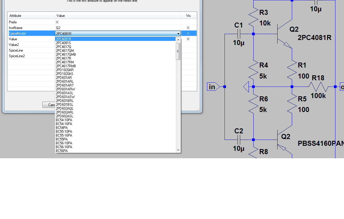

In case of the NXP-Model you have a NPN and PNP in the same *.SUB. For a "clean" NPN/PNP Library, you need to cut this Model in two pieces.
here is an example how to switch between different transistors ....
  • PBSS_Test.zip
