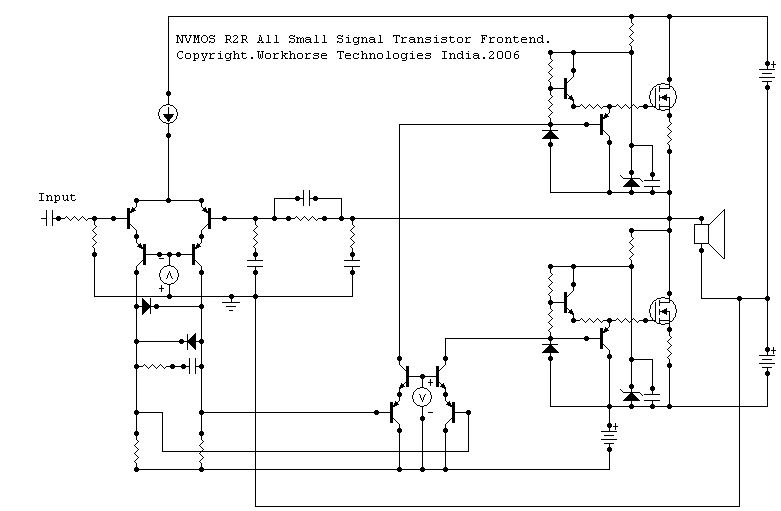

darkfenriz said:I guess bias adjustment and thermal sensing is in ccs, right?
Not at all, Its in the Rush Cascode...
Hi Kanwar
I do like it , the input and second stages look a little bit like an upside down version of the one I'm working on. I do particularly like the compound transistor / FET output stage. It seems as though you have the second stage driving into what is notionally a PNP output stage but is actually N-channel (if that makes any sense ..lol) and that is very clever. In conjuction with the associated NPN it must also provide very good control of the FET gate....very clever.
I don't know what rails you intend for this amp or what the resistor values are, but are there any heat issues for the MSA42/92 on the output stage?

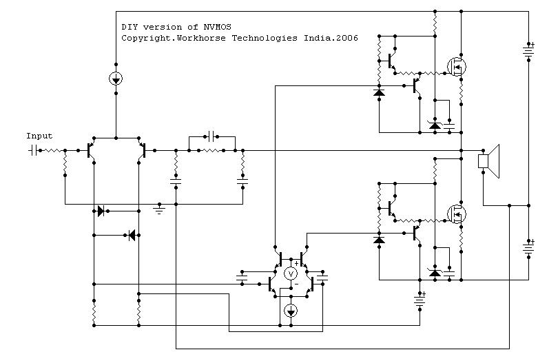

Workhorse said:Here's the DIY version.....
Where do you buy that circle component with an arrow inside it?
(Oh,.. and don't get me started on that circle component with a "V" inside it!)

quasi said:Hi Kanwar
Cheers
Hi Quasi,
Frontend differential runs at 1mA ..500uA each transistor...
Second Differential runs at 2mA..1mA each transistor...requires a copper clip heatsink for cascode only....
Drivers Run at 10mA with 12V max across them ..locked by 12V Zeners..Only the resistors feeding the zeners need to be around 5W rating....
Rails are +-120V...FETs are IRFP460....
Rail loss is 0.4Volts max with 16 OHM load.....
The Driver stage is actually a PUSH-PULL type..which ACTIVELY TURNS-OFF the FET, thus eliminating the Cross-Conduction and improves the Transient response at HF........
I am dreaming of an all SMD version of frontend for this amp...but i am busy very much...hope someone on this forum would make PCB design or I would have to do this all...pretty time consuming...
Thanks alot,
K a n w a r
+/- 120 volts ...oh my goodness !!
I like the Push Pull - that's what I meant by "In conjuction with the associated NPN it must also provide very good control of the FET gate....very clever."
Why do you have the resistor between the two emmitters of the push pull?
The 5 watt resistors explain where the heat goes, thanks.
If you like my PCB work ...I'd be happy to do the PCB for this one....but your gonna have to trade....lol
Anyway, nice work ...you the man!
Cheers
