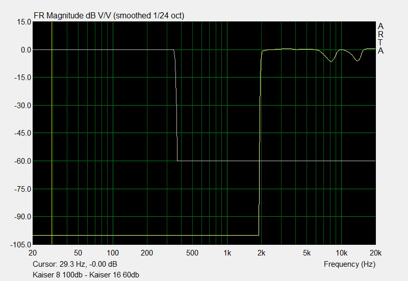

The FIR coefficient generator in your package is nice, thanks for sharing, I really like the EQ feature... however, I cant seem to make a filter with it that doesnt 'ring' horribly, changing kaiser window doesnt seem to do anything to the slope, as does reducing the target stopband attenuation, many attempts with different values of taps, alpha and attenuation all seem to result in increadibly steep cut off slopes... am I missing something obvious?

Just a quick arta grab to show what I mean, the low pass had a kaiser alpha value of 8 and a target stopband atten of -60db, the high pass has a kaiser alpha value of 16 and a target stopband atten of -100db, the cutoff slope is exactly the same.... ??
I thought kaiser window defined slope as well as stopband attenuation? I dont mind a 100db/octave filter, but the ones produced by your program seem to make filters with a much higher slope than that, moving 10-20db down within a few hertz.... I have searched through the source to find a variable to change to make the filter slope less sharp, couldnt find anything that worked....
Using DPS links, increasing the kaiser window alpha value not only increases stopband attenuation, but makes the curve less steep.
Have you not experienced 'ringing' with the filters from your program? To me its very audable.... but it could be something else wrong......
I thought the number of taps in a filter affected frequency resolution, which allows for a steeper slope, but does not create it.....

ok, tried 1024 tap filter, you are indeed correct that with your program fewer taps produce a shallower slope, but I then tried listening to these filters, they sound HORRIBLE..... just cant listen to them, (though the ringing almost disapeared).
So is there anyway to reduce the slope of the filters it produces while keeping tap count the same???? :)

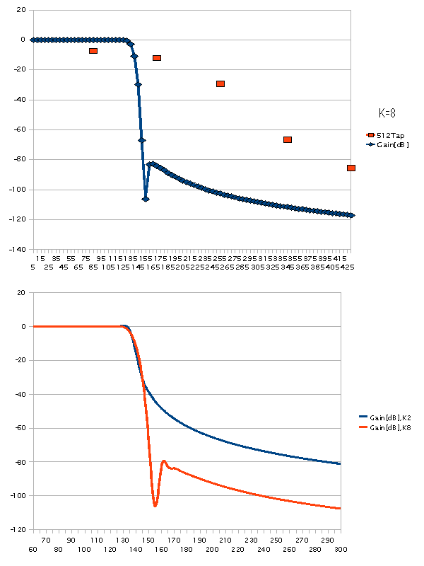

CreateFres() function only works to make "ON"/"OFF", then modify FreqResR[] by EQ parameter, in pass band.
I mean you need your source code to make some "dull curve" in FreqResR[]...

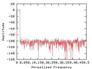

I don't know inside of brutefir, but I think brutefir can work with FIR coeffs which is made by brutefir itself. I'm wondering about you are using EQ functionallity. you should try my Coeffs : without EQ, can work in brutefir first.
http://momiji.i.ishikawa-nct.ac.jp/dfdesign_eng/gfir/fir.shtml
here is some FIR filter analyzer, not made by me / not related to brutefir. So you can compare both (mine / brutefir) coeffs here.
You're right, there. With most window types, the number of taps is directly proportional to the "product" (I can't think of a better word for it) of the steepness and stopband attenuation. In the case of the Kaiser window, the (alpha) parameter allows you to pretty much just trade off one for the other. The length of the filter dictates how much slope/attenuation you get overall, but not the balance. It is perfectly possible, with lots of taps, to get a shallow filter with a lot of stopband attenuation.
Incidentally, I find that provided you use enough taps, you get a stopband attenuation of approximately 10 * beta. Using less taps than required gives less attenuation, and using more taps than required gives the same attenuation with a steeper slope. My normal method with the Kaiser window is to specify a parameter of 10-15 (for between 100dB and 150dB of stopband attenuation), then scale the number of taps to get the sort of slope I'm looking for.
