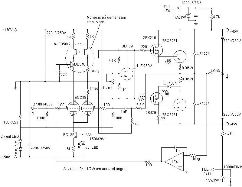

Hi!
This is my first (of hopefully many) post to this forum, I am running a Quasi output 2SC3281 and 2SK216/SJ79 mosfets as drivers, input and voltageamp is a tube diff-stage. i came up with this idea about a year ago since i dont like mosfet OPS and wanted a simple, easy to drive BJT OPS. I have looked all over for something similar but have come up with zero so far!
/Anders
/Anders

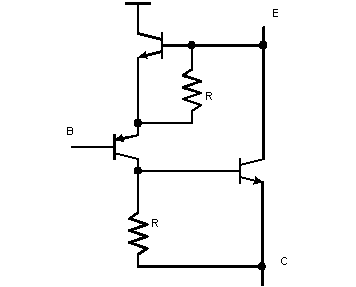

Mirlo,
I don't have a drawing package so I'll describe it. The quasi has a pnp driver and an npn power transistor. You need a diode in parallel with a resistor connected between pnp emitter and npn collector. You need the same value resistor between npn base and emitter. The pnp collector connects to the npn base.
AKSA,
No, no, no on all counts! Do you have a circuit simulator? - this will make it clearer. I think you are focussing too much on the pin connections of the power transistors.
Anyhow, I've said all I can. Take it or leave it.
AKSA,

Check out this Thred to see early schematics from the RCA Manual that showes Both types http://www.diyaudio.com/forums/showthread.php?threadid=6828 It should make this topic easy to understand.
Mirlo,
Your idea of using an npn instead of a diode is creative. Indeed, the pnp emitter current, which is also mostly npn base current, would be sourced from elsewhere than the output. The question is what benefit does this provide? Also, remember the idea is to make the quasi electrically equivalent to the darlington; the darlington driver current flows to the output.
As for removing the diode you must ask what you are trying to achieve. It's removal makes the quasi less like the darlington. And what makes you think it's removal improves stability? The non-diode and resistor form may have better performance in some respects, yes, but it deviates from the goal.
BAM
BAM
