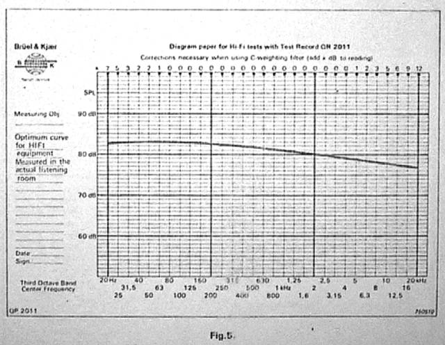

An RTA in-room response should be rolled off in the highs. First, the reflected highs aren't hitting the mic directly on axis. Second, the room generally absorbs more highs than lows. You're measuring the room as much as the speaker with an RTA.
That's part of the answer. The ear includes vast amounts of processing the brain does to fix on sound from the forward hemisphere, which means microphones pick up sound quite differently from how humans perceive it. Try taping the output from these mikes at the same time as you listen to music - I think you'll be amazed at how terrible the tape sounds. It's not the microphone's fault, it's doing exactly what it was designed to do: pick up sounds from all directions, including sound the ear normally ignores.
Now, speakers get more directional in the highs so room energy diminishes the further up you go, but the ear doesn't pick that up as dullness because the Haas precedence effect makes sure direct sound is perceived over the various reflections. Meanwhile, the mike's response curve knows nothing about Haas precedence, so EQing flat means the on-axis curve rises with frequency to the extent the speaker beams and room surfaces absorb highs over lows. EQing for perceived flatness actually means the room curve picked up by an omni microphone should roll off in the top end.
The -1 db/octave rolloff is an approximation which seems to work well for most rooms, so that's why many RTA/EQ combos include it as an option.
