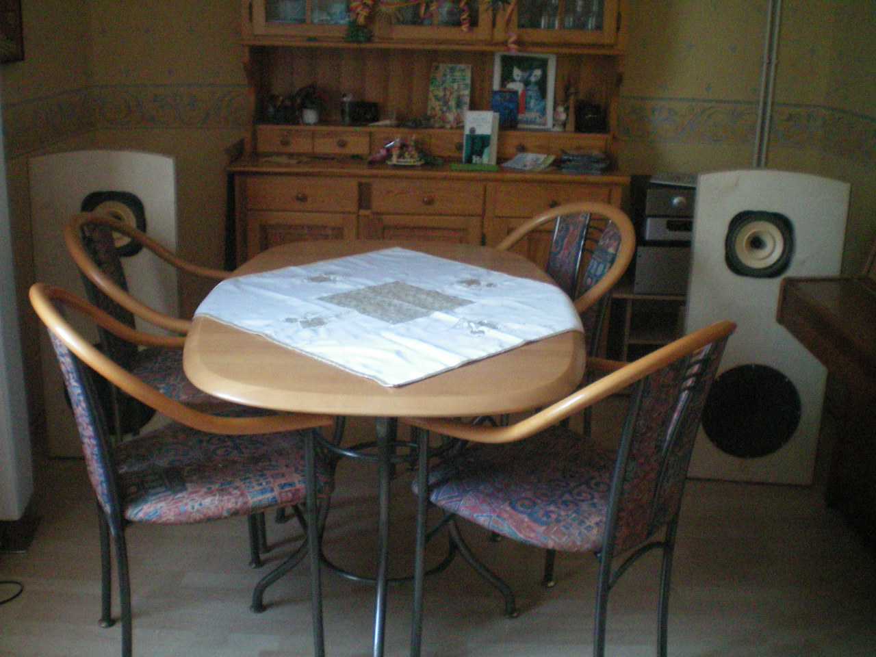

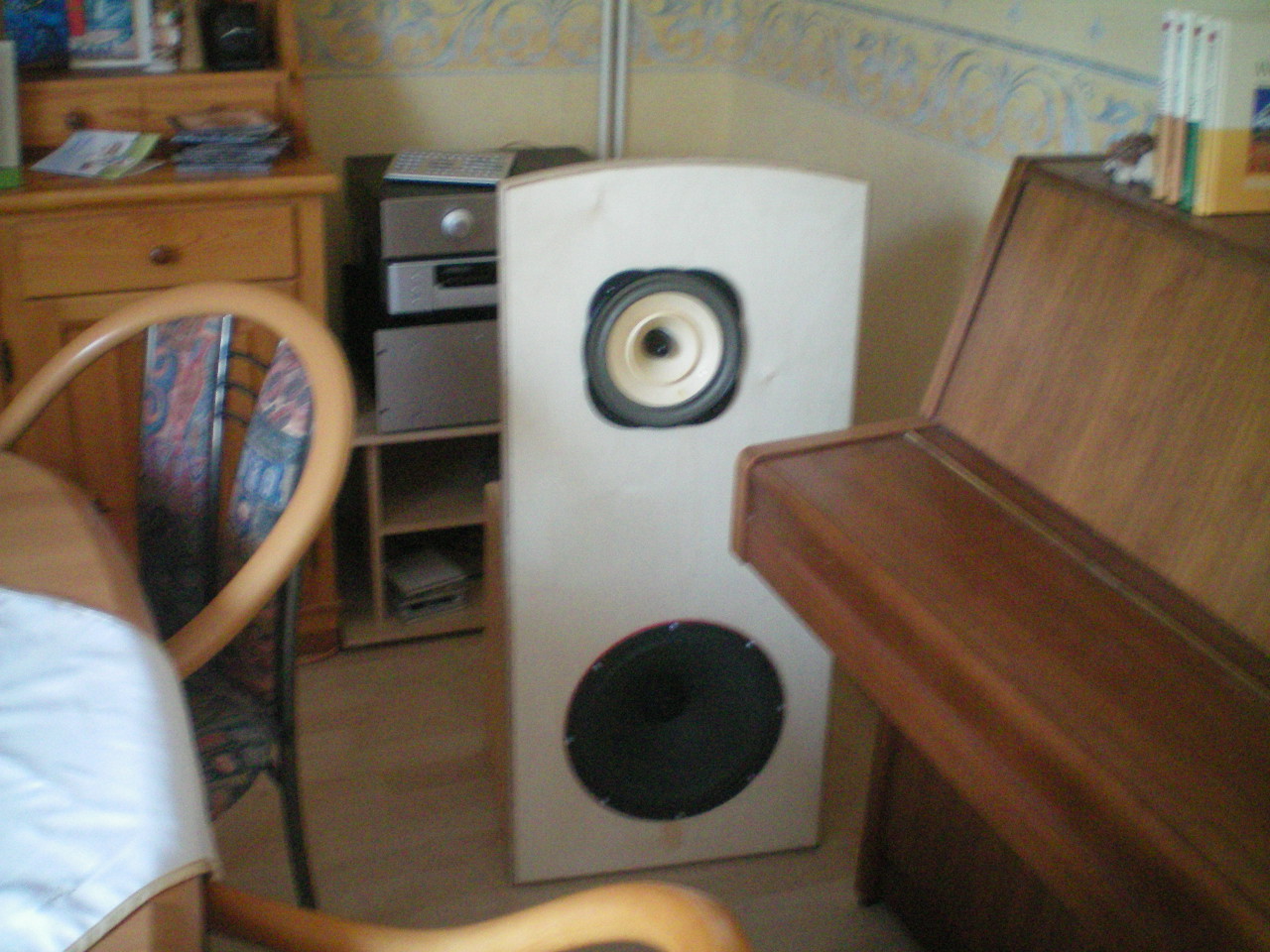

now I am a real First Watt guy......
Joined 2009
After two years of building different First Watt and Pass Labs amps (F1J, F2J, F4, F4 with SS100, F5, Aleph P, Pumpkin, UGS v3, BA-1, BA-1 with SS100, BA-2, Aleph3,Aleph 30, Aleph60 and Babelfish J2) I had much pleasure, but could not fix the problem that my speakers Thiel SCS4 (3,9 Ohm, 87 db) did not match in the right way with the First Watt line and the Alephs giving more power had not the effortless sound of the Semisouth solutions.
So I sold my beloved Thiel and looked for some Lowthers. I found an offer, two Acousta 115 with PM6A for half the price... I asked my wife.... she agreed and drove me to the merchant and back with the precious speakers on board.
:D
Fine sound, very detailed and lively, but the bass was small and clumsy.
I was a bit disappointed......
searching for a solution I found Jon Ver Halens TOA (Tiny Open Baffle Alnico) and it solved the rest of the problem.
Tone Tubby 12´´ for the bass and PM6A .... what a wonderful combination! I do not understand why this solution can reproduce effortless Stanley Clarks bass lines, going down to the same point to about 70 Hz and Acoustas could not.
I have only small rooms and I doubted if the baffles would work.
Big surprise, no problem at all... best sound ever, huge stage and wonderfull voices, fast details.
The recommended ASC oil caps are good for shouty Lowther, I first used Obbligato, not bad too... a bit more stressing in long time hearing.
In the background you see my Pumpkin Pre and Babelfish J2....
Please excuse this a bit off topic writing, but I had to place it in the Pass forum, giving me the help I needed to go along this way...
special thanks to Mr. Pass, Zen Mod, tea-bag, flg, Bill Fuss, Melon Head and some guys from the diyaudio.rs forum (especially spavlesky)for good advices on the way.

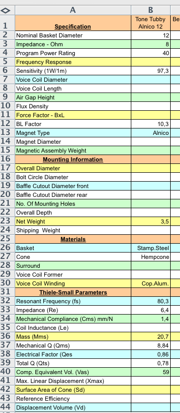

considering PM6A - 8 Ohms , Al coil ?
PM6A Drive Unit
Theile Small Parameters for PM6A with 8 ohm Aluminium Voice Coil DC Resistance of Voice Coil Re 7.4 ohms
Free Air Resonance Fo 61.980 Hz
Emission Piston Area Sd 0.021M²
Equivalent Volume Suspension Vas 47.192 Ltrs
Suspension Compliance Cms 753.6 u M/N
Mass of Cone Mmd 7.0 g
Mass of Moving Parts Mms 8.75 g
Force Factor Bl 7.27 T-M
Mechanical Q Factor Qms 1.578
Electrical Q Factor Qes 0.477
Total Q Factor Qts 0.366
Voice Coil Inductance @ 1 kHz Le 148.2 uH
Reference Efficiency No 2.278%
Sound Pressure Level SPL 95.593 Db
what I also need is :
dimensions of OB and exact position of drivers
