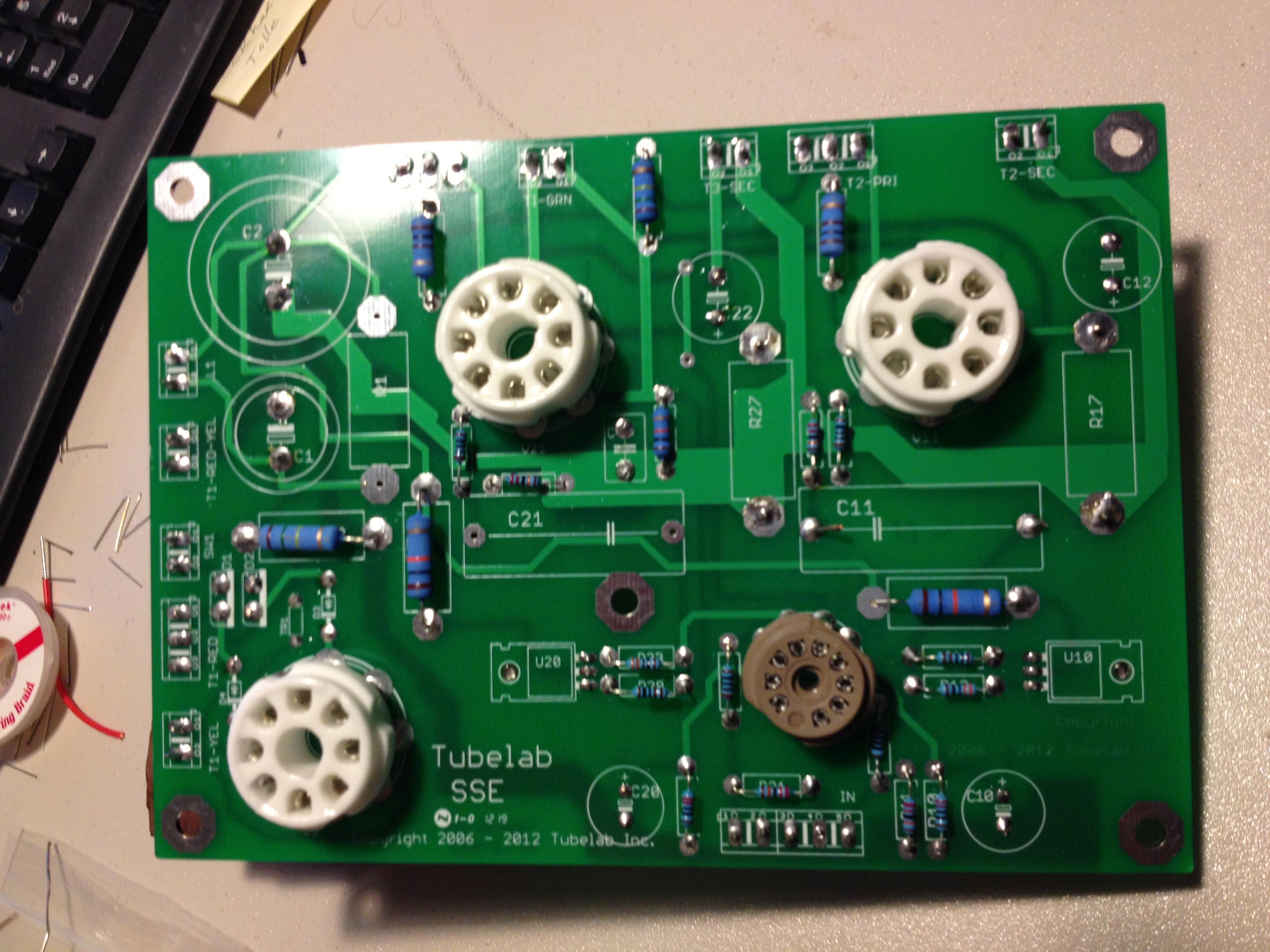

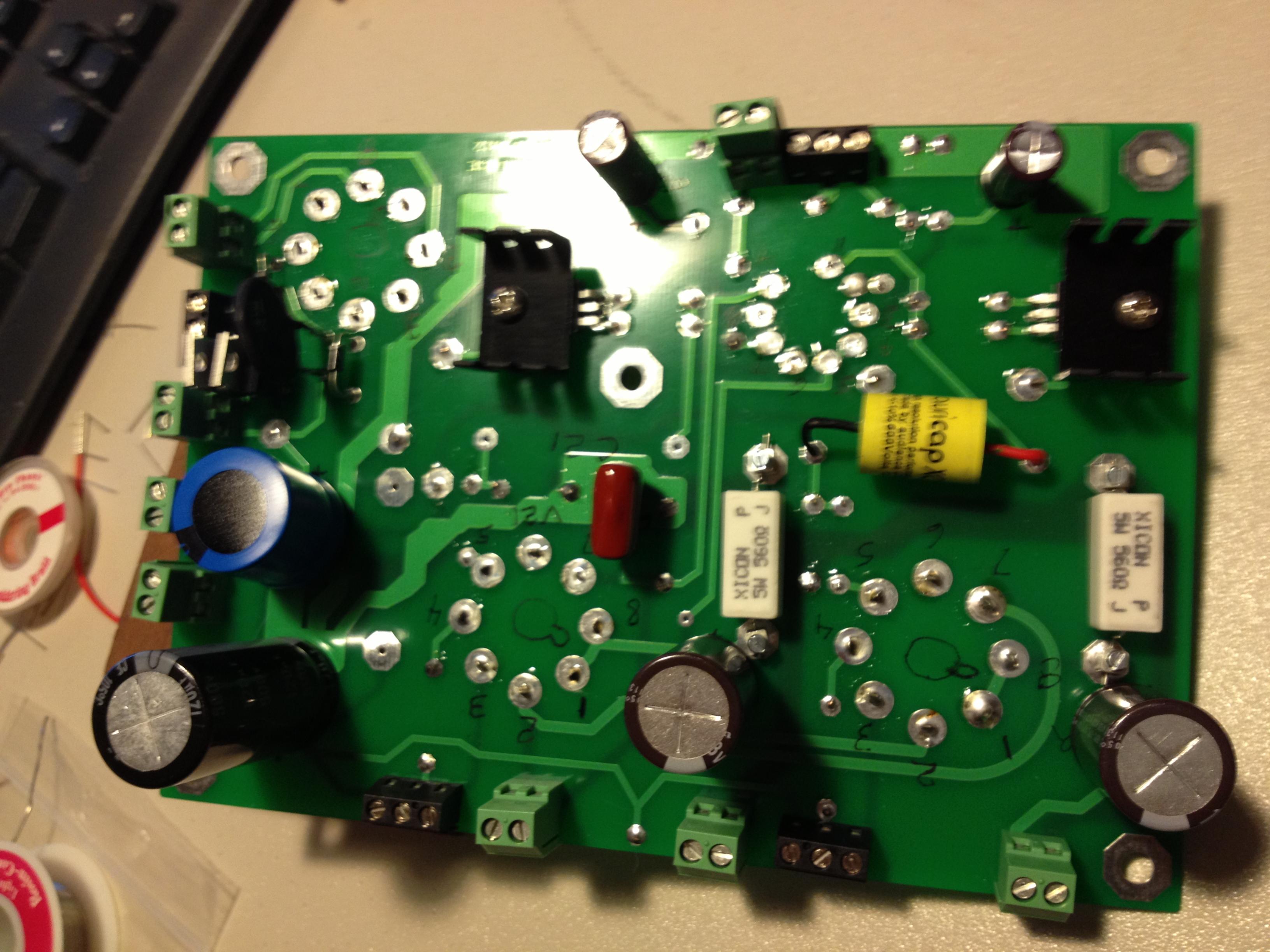

Sorry to jump in on your thead but we seem to be in about the same place. started soldering, I am going to use a switch to vary my bias so I can tube role. my edcors xpwr035 and cxse25-8-25 also there 10h choke should arrive fri. Thinking of using the CSS 7.3 speakers
Your not intruding in the least bit. A bias switch sounds pretty useful but is above my skill lvl to make, unless I had diagram slap me in the face. I briefly thought about rolling rectifier tubes to change bias, which I have not researched yet. I actually made DIY speakers, the design is called the Lyra, 3 ways. No idea what the sensitivity is on them. Guessing around 90. They turned out very nice.
