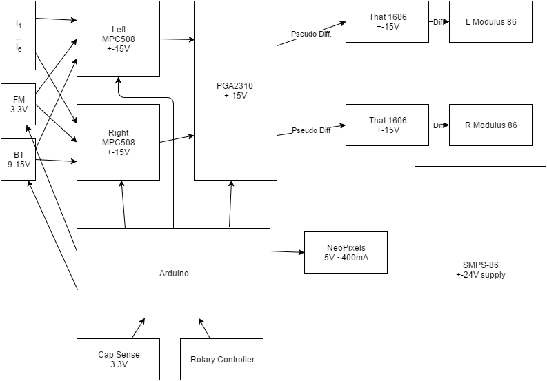

Pre-amp help
Hello again!
After buying and assembling my pair of Modulus 86s I've been musing on my pre-amp for too long. I've done a lot of reading and a little bit of understanding. Now I've got either a good plan, way too much scope creep, or both!
Attached is a pseudo schematic for my idea.
I realize that all my sources will be single ended. So, I've selected ICs that handle single ended signals. I'm using a pair of MPC508As for switching between signals. From there I'm going to a PGA2310 or PGA2311 for digital volume control. From there I am going to use a pseudo differential signal and connect to a THAT 1606s to buffer the output before sending the signal my Modulus 86s.
Two of my inputs will be internal to my design. One FM reciever & one bluetooth reciever.
Blue tooth: Sure Electronics' webstore Bluetooth V4.0 Audio Receiver Board w APT-X - BRB3
I'm considering this Bluetooth reciever. It's not the highest end receiver, but will do for my purposes. It will need 9-15V (12V typical)
FM Receiver: https://www.sparkfun.com/products/11083
Both the input switching and the volume control will be controlled by an arduino. The arduino will interpret signals from a set of capacitance touch buttons and a rotary encoder.
Open questions
Power: I currently have an SMPS-86 from Tom @ Neurochrome. It provides +-24V for the Modulus-86s.
I think after evaluating my needs, I'll need a second power supply. As I understand it, I'll need +-15V for the PGA2310 and the MPC508A. The Arduino runs on 5V and has a internal regulator to handle 7-12V recommended or 6-20V min/max. A few internet sources say that above 12V for too long is bad, so I'd prefer to have a 12V rail for it. It can produce a regulated 5V and 3.3V(used in the FM receiver & the cap Sense). The neopixels need 5V+ and will draw about 400mA. This is within the ability of the arduino to provide(500mA - 1A) but I'm not sure I love it(https://www.youtube.com/watch?v=6-_AgqpjOiU). So, how can I use a +-15V source like the meanwell RS-25-15(http://www.mouser.com/search/ProductDetail.aspx?R=0virtualkey0virtualkeyRS-25-15) to also provide the 12V DC for the Bluetooth receiver & the Arduino and the 5V DC that I need for the neopixels. If I use the 15V+ to ground with some voltage regulator will it be a problem?
PGA2310 or PGA2311: The main difference for me is the operating voltage. 5 vs 15. Some suggest having the 15V version provides better "headroom", but I don't really understand the implications of this. http://www.diyaudio.com/forums/chip-amps/115684-pga2310-vs-pga2320.html
I suppose that if I'm already going to need +-15V for the MPC508A, I might as well use the PGA2310.
THAT1606 & source/load impedances: Is this the right place to use these? Everywhere I look I see that having a low impedance source for the power amp is the preferable solution. When I suggested I was going to use an ALPs pot as the attenuator, I got the feedback that it would be a good idea to buffer the output. It looks like the PGA231x would be a low impedance source, so maybe this part is uncessary. Perhaps they are necessary between other stages?
Alternatives to the MPC508As: The MPC508A switches mono single ended signals. I looked at other chips in the family, but they all seemed to switch mono sources (either single ended or differential). Does anyone know any suitable chips that would switch both left and right with a single chip?
