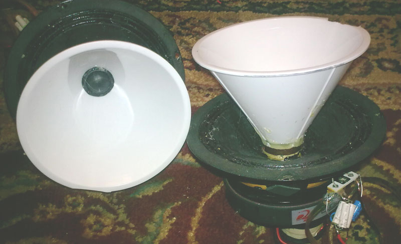

Since my first stab at this was fairly successful, I started optimizing things. That led to the design I posted a couple days ago, basically a dome tweeter with a waveguide mounted coaxially with a woofer in a bandpass box.
See page 1 for details.
I scrapped that idea, because we want the depth to be very VERY shallow. The width of our baffle is dictated by the depth of our baffle, because it's in the corner.
So if the design is six inches deep, than the baffle will have to be almost a foot wide.
Not acceptable, so back to the drawing board.
The new version uses a conventional layout, so we can get the depth as shallow as possible, and minimize the width at the same time. The new one is about 4" deep, the old one was 5.5".
I do all my designs on the computer first, here's a pic of side view:
A view from the front.
The whole thing fits on a single sheet of paper. I literally print it out, copy it onto the wood, and cut.
The Misco woofer is sandwiched in between an inch of MDF on either side. One of the issues I had with my Unity horn clone is that the fiberglass waveguide would buzz at high volumes. This solves that problem nicely.
The dome on the baffle on the left is to reduce the airspace in front of the woofer. We have to use a very VERY small front chamber, otherwise our bandpass enclosure will have a bandwidth that's too narrow. As you shrink the front chamber you lose efficiency but gain bandwidth.
We want wide bandwidth, so the front chamber needs to be small.
Did I mention it's shallow? I want this thing to be stealth. Soda can for comparison.
Here you can see the four holes for the midranges, spaced six inches apart, which creates a 90 degree lobe at 1125hz.
My flash was not cooperating.
The four holes create a 90 degree lobe at 1125hz. Ideally we'd match that with a 90 degree waveguide that's 12 inches in diameter. (speed of sound / 1125hz = 12")
But we don't have room for a 12" waveguide. However the floor and the door continue the curve nicely, and should restrict directivity to some extent below 2khz.
In order to do this, the baffle must be absolutely flush with the floor and the side, which is why the depth is so critical.

I am afraid this project did not work out. When I measured the midrange response, I found that it was unusable. The front chamber of the bandpass enclosure is simply too big.
While there may be a way to reduce the volume, I've decided to take a different approach to the problem.
You can read about the next project here:
http://www.diyaudio.com/forums/showthread.php?s=&postid=1887657
