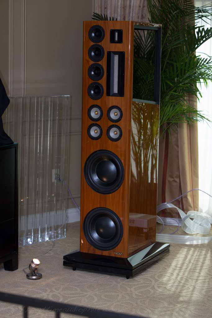

Now, is anybody interested in array of four linaeum tweeters? Well, should have made them slightly curved. There is high end speaker...will try to find the pic.
music soothes the savage beast
Joined 2004
to me this would be a nice compromise...you get mid array with low floor bounce due to the vertical focus, you get point source for heights...wait, for the high frequencies, much shorter distance classifies as array, relative to wavelength, so you get tweeter with low floor bounce too if its a long ribbon, just not too narrow
its important to have smooth directionality of axis, no sudden changes
