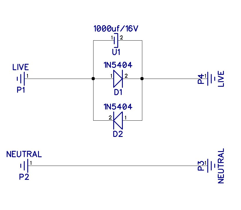

Last night I powered up the 300 VA toroidal and it is making a quiet hum/buzz. On smaller toroidals this usually means there is a short somewhere, but in my case the buzz persists with the transformer bolted down, or with bolt removed, at a different location, and with bridge+filters connected or not.
Any idea what could be causing this noise?

It could be a mechanical issue in the transformer. That happens, and isn't something to be overly concerned about (other than the sound being obnouxious). However, a very small DC component on the mains will easily saturate the core, which results in larger current draw and leaking magnetic field. The larger the transformer the bigger the issue.
Two large low-voltage electrolytics is enough to test that hypothesis. Add two diodes for continous use.

First,
power the transformer through a mains bulb tester.
If the bulb stays on you have a wiring fault.
Next, TAKE CARE - the blocker is at mains voltage!!!!
build a mains DC blocker, fit it in the primary, in the Neutral or the Live, but not both. Remember that you must be able to pass AC through the DC blocker and that start up current peaks and abusive usage overloads must also be able to pass without damaging the DC blocker.
All you need are a pair of large low voltage electrolytics (~10mF 10V) and a pair of 400V 1n5404 diodes.
If both wiring faults and DC have been eliminated as the cause and the noise is still heard, then you have a badly manufactured transformer.

if you decide to implement the DC blocker for some or all of your toroids then the caps must be a series pair of back to back polarised electrolytics.
For 50Hz the cap impedance of two 1000uF back to back is Imp = 1/2/Pi/F/C = 6.3ohms
The peak voltage across the caps will be sqrt(2) * 1.5A * 6.3ohms = 13.5Vpk.
The caps for 1.5Arms need to be about 20 times bigger to get the voltage below the Vf of the single diodes.
You can use pairs of series diodes in each direction to double the voltage capacity of the blocker but that still leaves you needing 10mF+10mF and 4diodes for 1.5Arms @ 50Hz.
