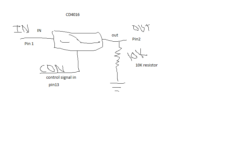

I wish the cap resi arrangement should solve the problem. but in case it dosent work and you need to work on CD4016, then here is the suggested connection.
the drawing is made quick using paint brush. it looks dirty. but this moment here had no alternative.

I am just confirming if you have done what i suggested ( if i was able to tell you correctly )
option 1.
Keep your old arrangement with 74HCT14 & SSM2412 untouched. Then connect resistor as suggested( resi can be between 1E to 10E), in parallel to the capacitor at the output of NE5532 and input of SSM2412. and check if the click persists.
option 2.
keep your 74HCT14 in place. and replace the SSM2412 with the CD4016 ckt shown in above diagram. and check for click noise.

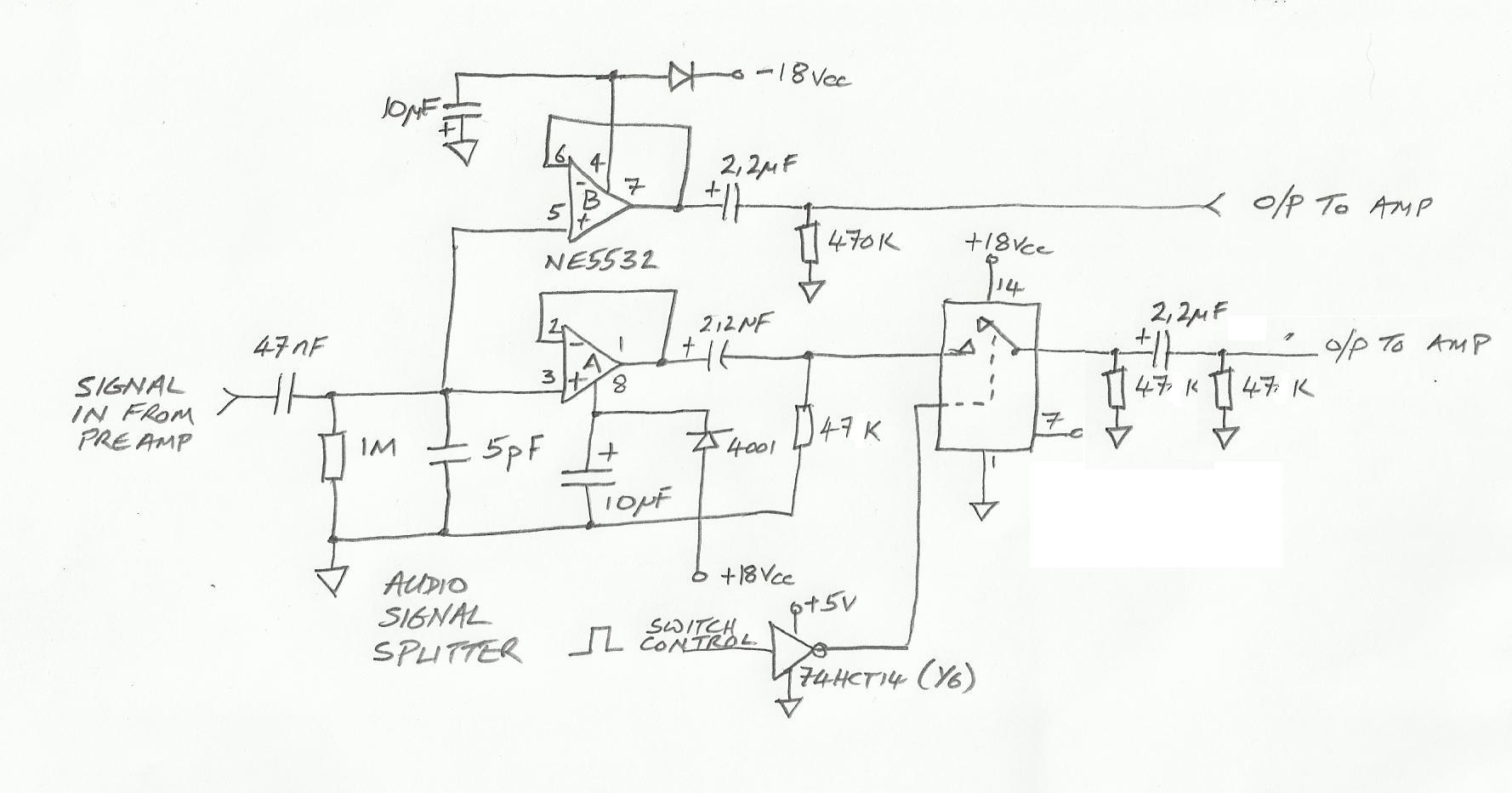

On pulsing the switch. You may have two problems here. The control signal from the logic breaking through is one. A separate issue could be this,
If the clicking gets less and less then that suggests there is a slight DC differential across the switch that is becoming less as time goes on. That would fit in with any coupling caps charging and slowly settling to a steady state value.
Looking at the circuit in post #5 the switch is AC coupled at the input side with the 2.2uf cap and 470k to ground. Try reducing the value of the 470K by a factor of 10 or so. That will allow the cap to charge that much quicker.
The same things apply on the output side of the switch. It would help to see what this is connected to but as an experiment you could repeat the 2.2uf and resistor/s (47K) on the output.
The polarity of the caps depends on what is actually measured in the real circuit. Whether the final 47K is needed also depends on what is connected here.

EUREKA!
Last night I reconfigured the splitter/buffer circuit feeding the audio signal to the analogue switch. I used the component values suggested by stratus46 but I have had very similar advice recently from Mooly and Aucosticraft. The rework did reduce the switch noise slightly, but it did not remove it completely.
Your latest message Mooly hit the nail on the head. The output from the analogue switch will be connected to an external amplifier and as such I've been simply measuring the output signals directly from the IC pins; no additional componects have been included. With the extra cap and resistors not only the clicks have disappeared but also the hum that was present when the analogue switch was in the off state.
I'm certain that many of the modification along the way have been beneficial but this final addition was something I obviously overlooked and should have included. Aucosticraft kindly sent me a schematic for an improved circuit and the same output configuration is also shown on his design.
Thank you Mooly and thank you Aucosticraft for all your help on getting this circuit to function correctly. It would have taken me quite a while to have found the solution without your aid; I am very grateful. The sound is now clear and there's silence between the pulses; there are more no clicks or pops to worry about.
