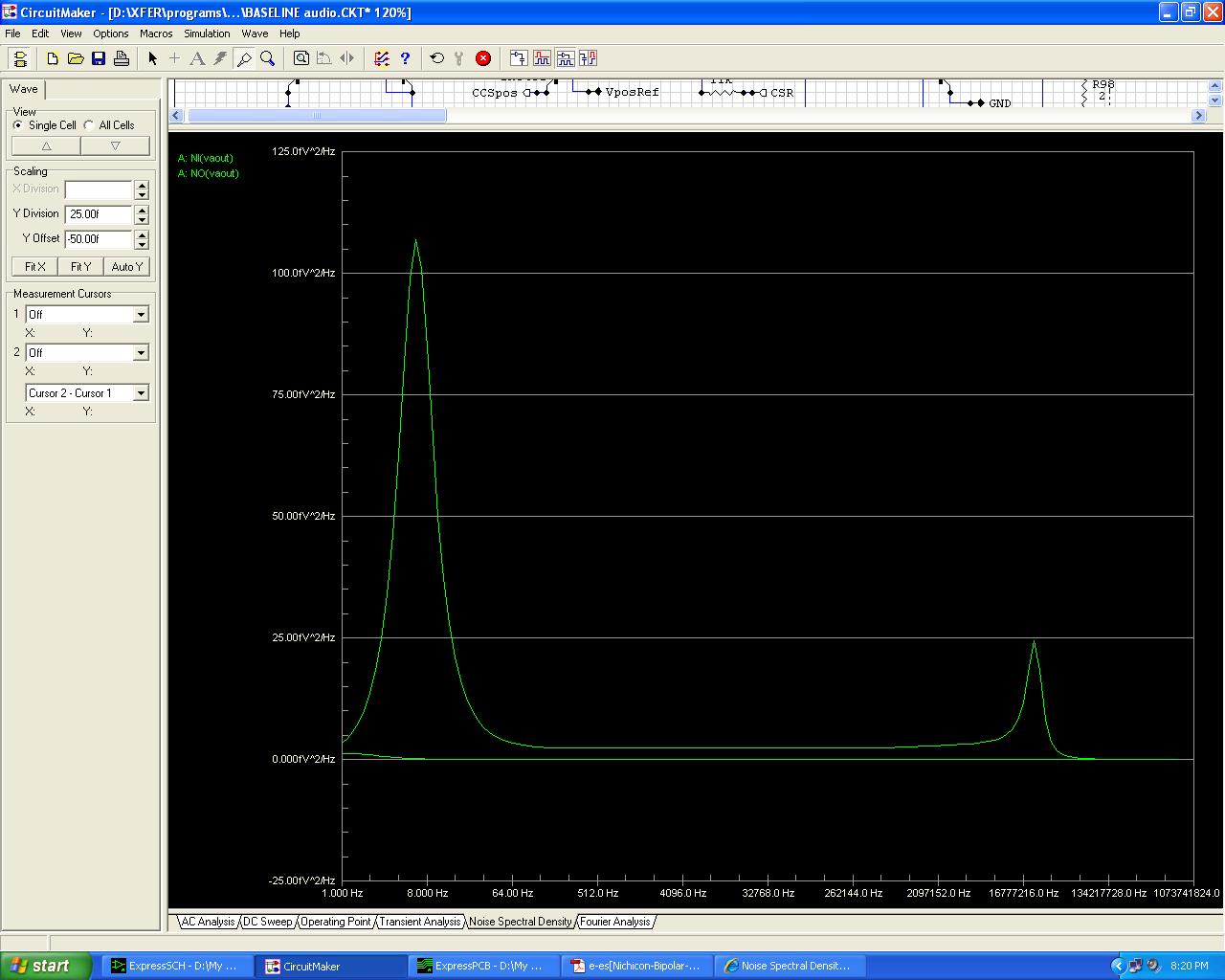

In my amplifier design the NSD displays a nice smooth ramp from 0 to 2.000fV^2/Hz @ 16hz then tapers to a flat 2.250fV^2/Hz @ 64hz then at 131.072khz it slowly ramps up to 3.250fV^2/Hz @ 4.2meghz and of course rises sharply to peak 24.50fV^2/Hz @ 24meghz then sharply declines to 0.500fV^2/Hz @ 42meghz then to a smooth decline down to 0 @ 264.4meghz.:confused:
On the Fourier Analysis tab my amp shows it starting out at 34mV then droping straight down to 0mV @ .1Hz then obviously flat at 0mV all the way across.

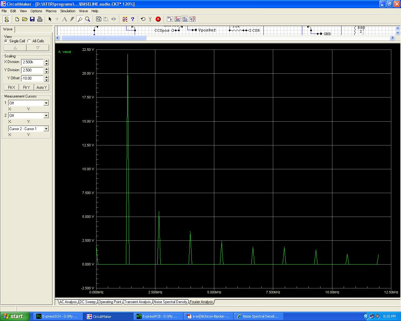

Screen shots of NSD and Fourier:
The circuit in question uses a simple LTP with CMs, active CCS with a buffered VAS all mirrored topo with bias . No OPS at the moment.
Reference input and node is a sign wave 2Vp-p the output node is taken from the input of a generic 1:1 gain stage block feeding the NFB.
using +/- 27.6V Rails decoupled.

It may be more useful to set the axes on the fourier graph to logarithmic. That is how most attachments on DIYAudio are formatted. In most amps, harmonics above the 3rd aren't visible on a non-logarithmic graph. This may be a sign of improper operation.
Same goes for the noise graph, you will see more information. Also, those spikes look like resonance peaks. It looks to me like the resolution (number of data points) taken by the graph isn't large enough to show how high they really are, as you can see by the blunted misshapen peaks. If you turn up the resolution it may be more accurate.

It seems as though the Fourier is inhearantly dead set on a linear X axis (non-changeable, log selections are greyed out), y axis has various selections that seem to only change the y side bar designations, no change in the displayed data. (user input can only change freq to be tested and # of harmonics desired)
I even changed the # of cycles to be ran, and nada-no change.
The only parameters allowable to be changed in the NSD is fundamental freq (this is of course used to see at a specific freq, so I did not want to change this), test points (I changed from 5-10-50-100-200-500), Linear-Decade-Octave (checked with all 3). always gives the same graph shape except on linear scale (linear definitly usless at this point).

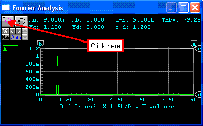

I use an old "Student" version of Circuitmaker.
On the output screen there's a button that brings up a "Settings" screen, where you can select "Decibels" for the vertical scale. Perhaps your version has something similar?
Btw, I wouldn't recommend the old "Student" version as it's more than slightly buggy (but very easy to use). In comparison LTSpice is very good, but an absolute pain to use.
Cheers - Godfrey
