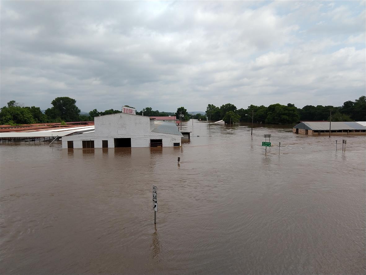

It got pretty bad here.
The first ( bad ) pic is from my car - the base of the billboard seen through the window is normally about 16 feet above dry ground. This road was closed a few hours later.
Second pic is a few hundred yards from a property I own across the line in Oklahoma. The river is supposed to be miles from here ...
Third pic is a town - I think that rooftop sticking out of the water is a school or city hall. This is from another closed road into town; I walked it out until it became underwater.

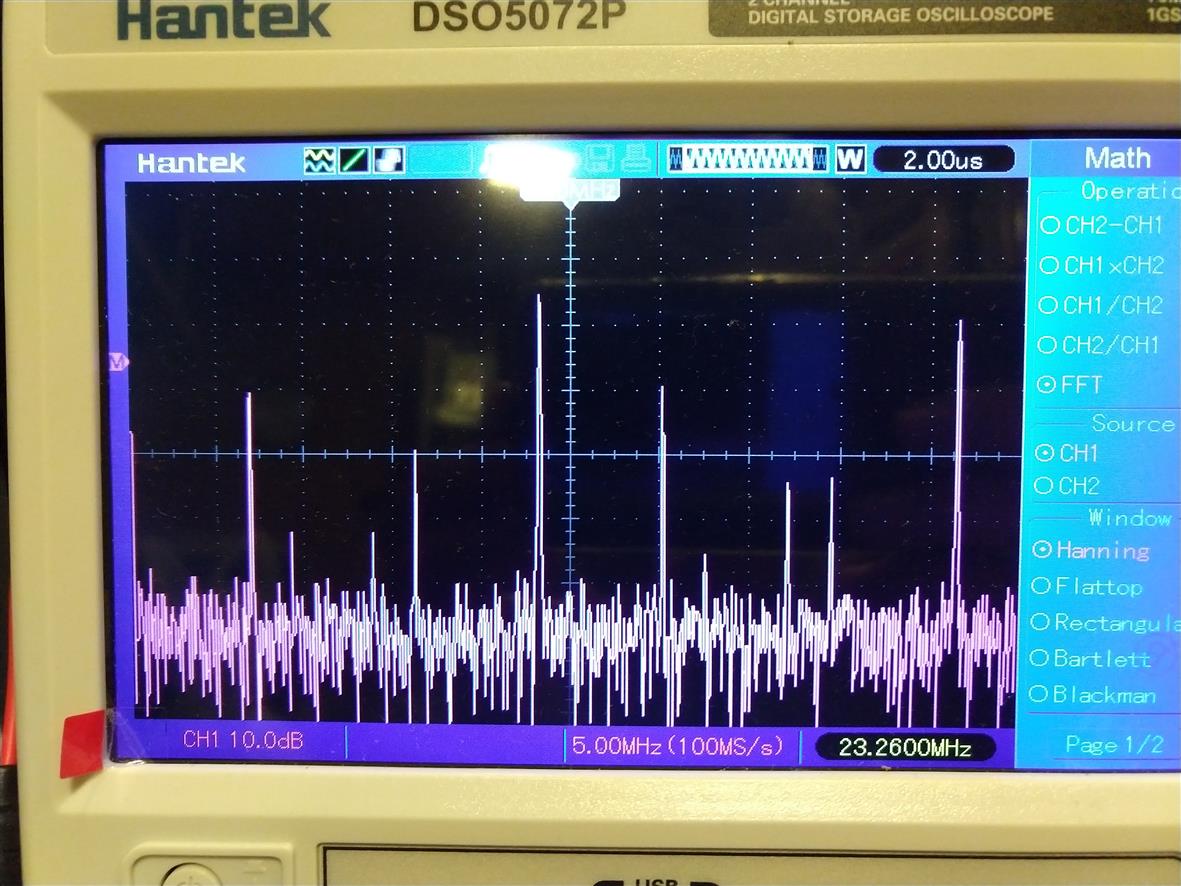

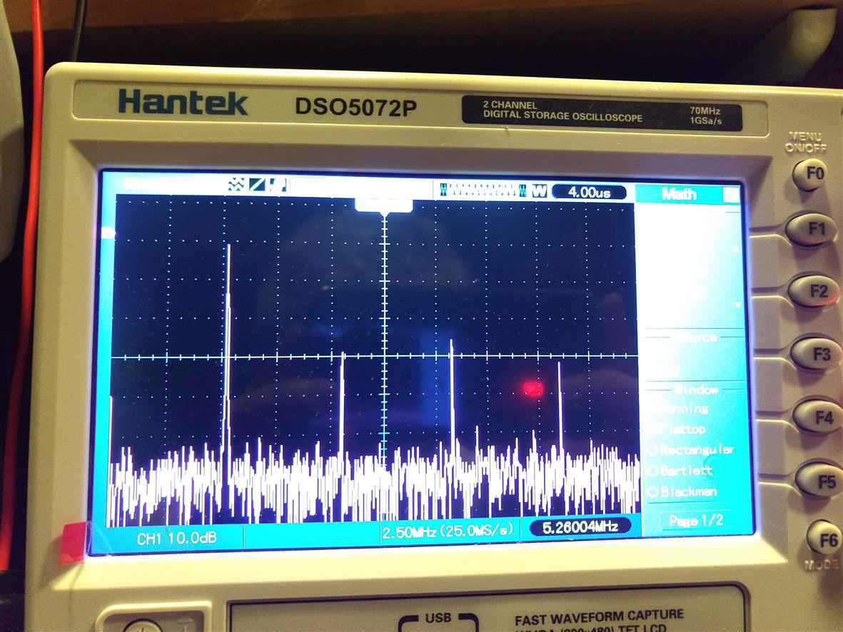

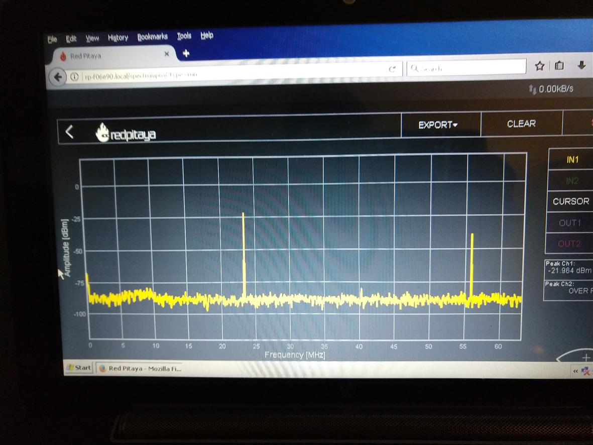

Otherwise, it has been suggested to me that the Hantek FFT's could be deceiving me. I brought the Si5351 thing down to the office and looked at it with the 14 bit Red Pitaya. And there are some significant differences to be seen.
The first pic is 5.2 MHz, between 4 and 6 MHz. This shows a lot of crud, more or less, mostly more, consistent with the Hantek FFT.
The second pic is 23.2 MHz - those vexing spurs around 15 -16 MHz are absent. Very inconsistent with the Hantek FFT.
The third pic is 59 MHz. This is more or less, mostly more, consistent with the Hantek FFT.
One possible variable is the power supply for the Si5351 device. I was using a wall wart at home, and here at the office, because all my linear supplies were / are being used for other bits of the apparatus. Here at the office, I had difficulty getting a good wireless connection to the RP, which I traced to interference from the Lenovorola wall wart the Si5351 was plugged into. Switching to another wall wart fixed this. So, to state the obvious, not all wall warts are created equal. I think I need to build a 5 volt linear supply for the work bench, just to eliminate bad power on the bench as an unresolved variable.
So, I'm not sure what to make of this, other than that the RP seems to be a neat device.

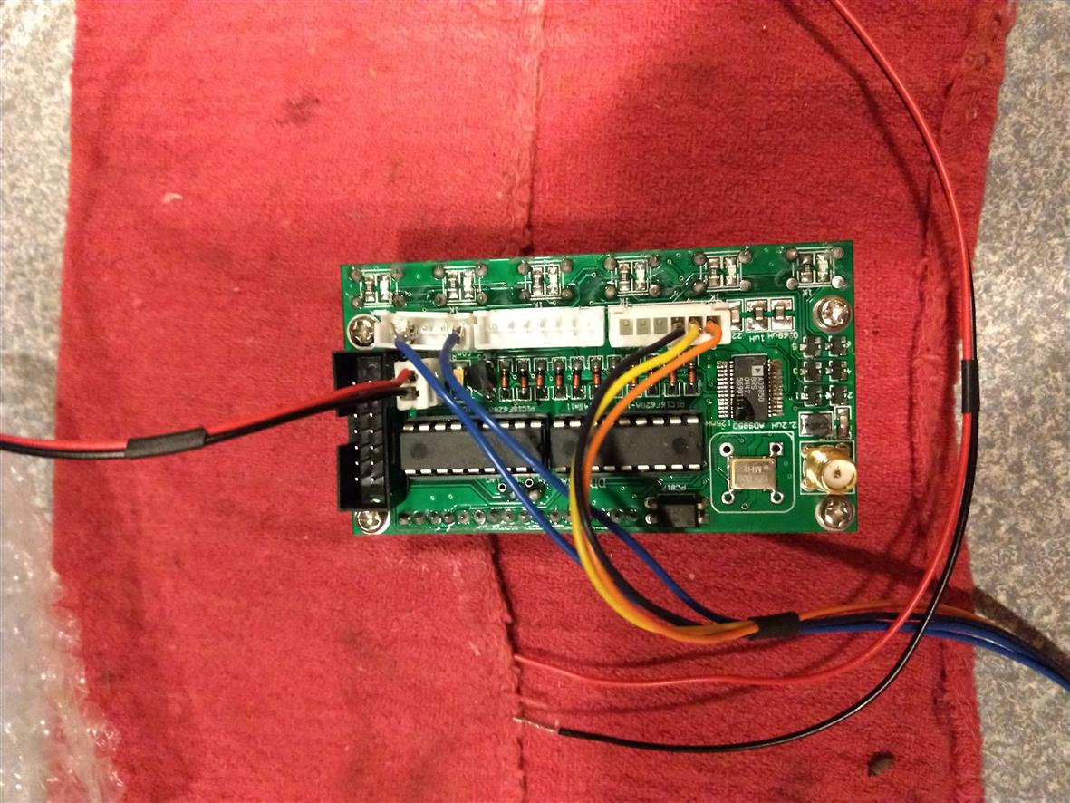

I hooked up the cheap eBay AD9850 DDS module last night.
It comes with nothing, no instructions, no pigtails, no encoder, so I had to spend a bit of time hooking that stuff up, which kept me from being able to spend much time playing with it.
I don't know what the correct voltage is, but this one is best at about 8 VDC. Below that, you get output, but can't see the display. Above that, the display will fade after a minute or so.
These are advertised as 0-55 MHz, but this one has only a 125 MHz clock chip, and the useful upper limit maxes out at about 41 MHz, or so. So, it should really be advertised as 0 - 40 Mhz.
This one has kind of an interesting feature, in that as the the encoder is spun faster, the tuning rate advances, much like a real radio. I installed a non detent encoder on this ( because it is what I had in stock ) so it has a nice feel, but for mobile use, I think a detent encoder will be a better choice.
There is an RF board on the back of the DDS board. This one has a non descript SOT-89 chip that just says "RF" on it. THe gain is set wrong for frequencies around 20 MHz, as shown in the FFT. There is a jumper that can be removed to turn the gain down in this range, but I have not played with that, yet.
FFT's attached in the 5 MHz and 23 MHz range ( low and high side injection for converting 14 MHz to 9 MHz ) and you can see that the 23 MHz signal is about ten fold stronger than the 5 Mhz side, and horribly distorted as a result. 5.X Mhz looks good, only harmonics of the fundamental show up on the FFT.
