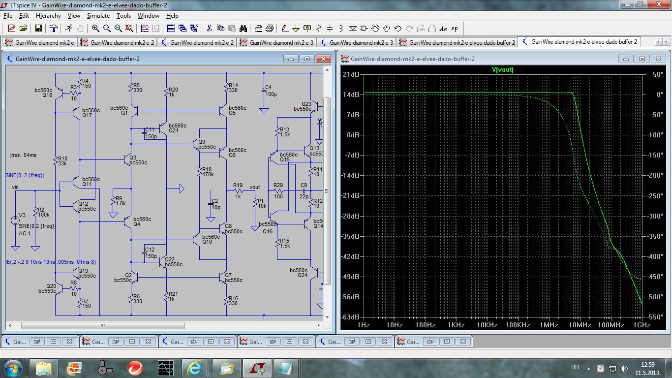

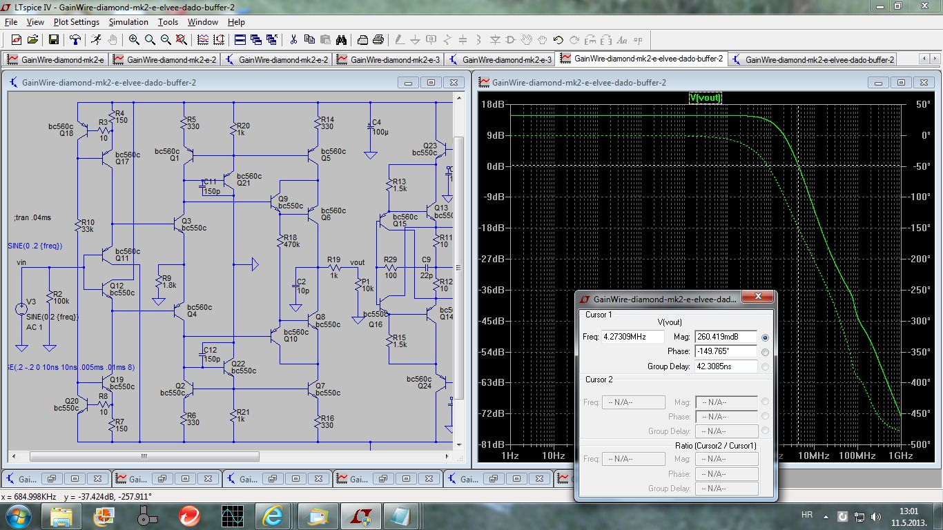

Here is the gain plot without output buffer. First one is without C2 and second with C2.
BR damir

Hi Matthias,
BR damir

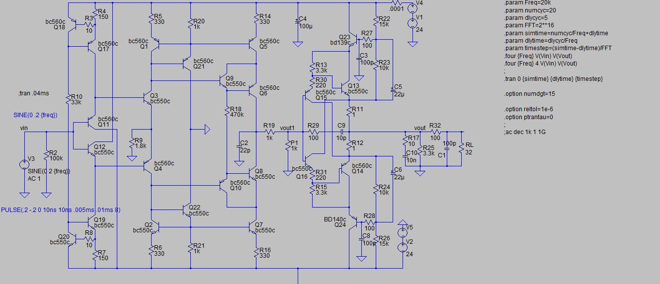

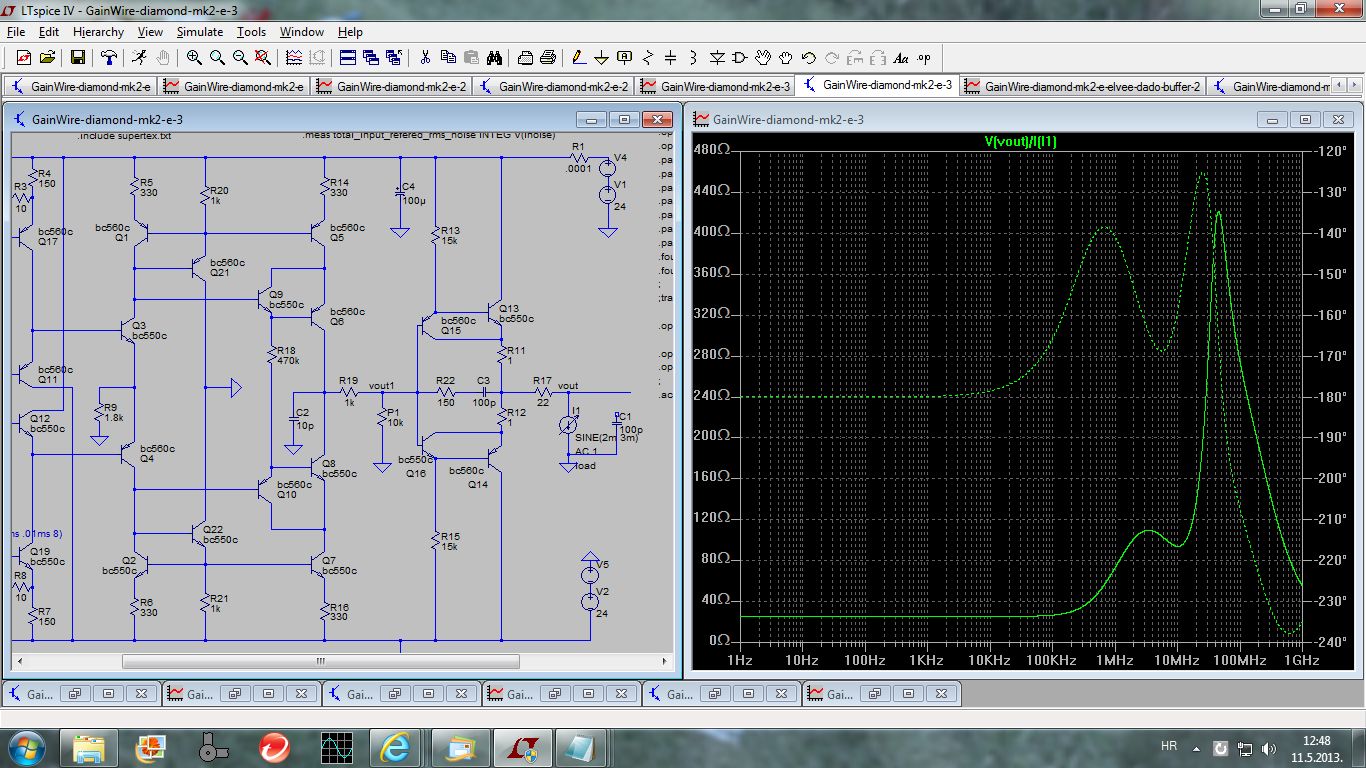

I have to wonder whether that peaking is not coming from the current mirrors. All current mirrors have some peaking around the 2-15 Mhz. The EF assisted mirror has much higher peaking than the standard one.
You could try placing small value cap from base to emitter of Q21 and Q22.
Interesting, some performance is lost. Can it be made stable if you remove the zobel and only the RC in place ??
I think it's possible, but I am more interested in simpler output buffer and I will show you what I've found later.
It helps, the peaking no more, but I don't like the brick wall like plot, and if I keep C2 connected it looks much smoother.
Damir

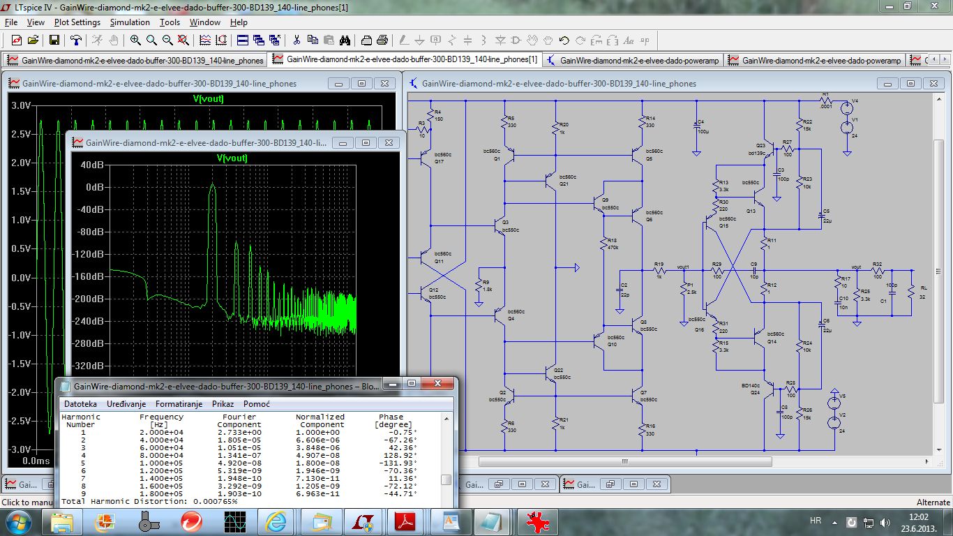

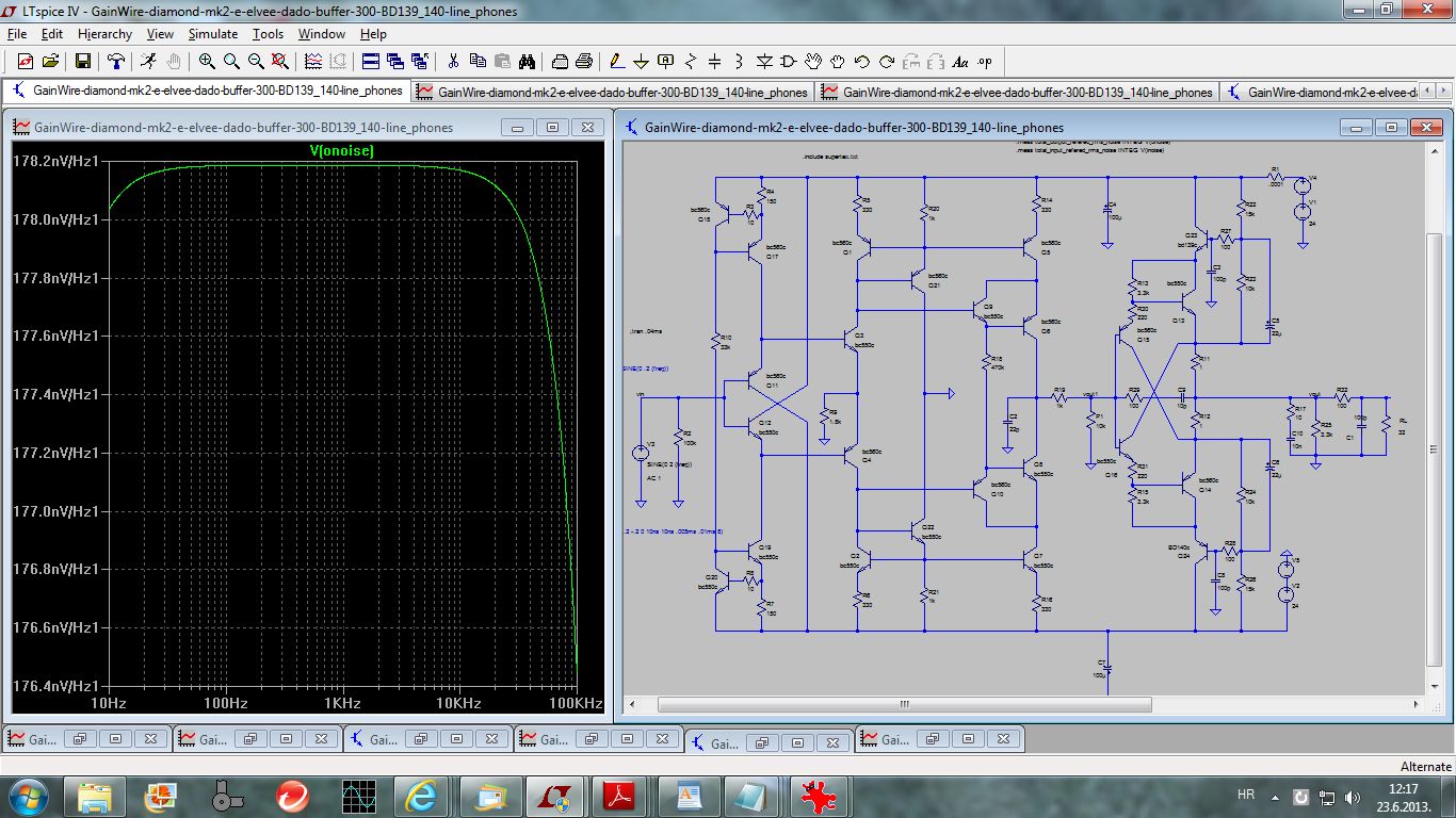

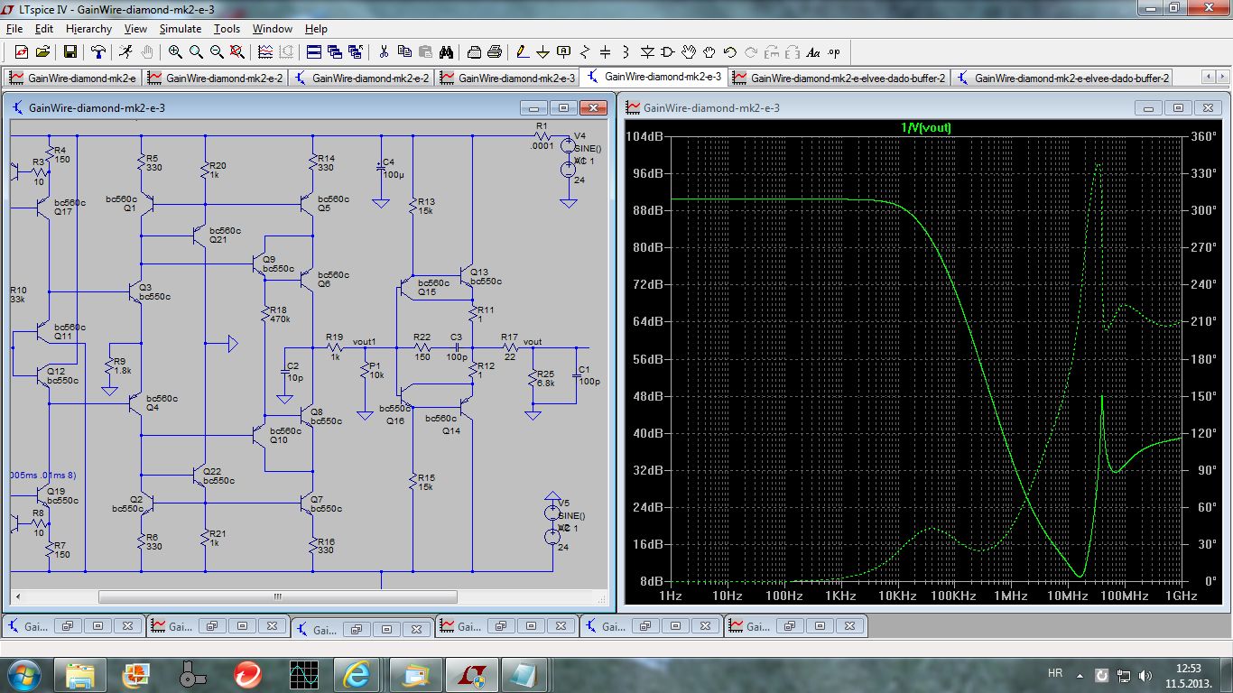

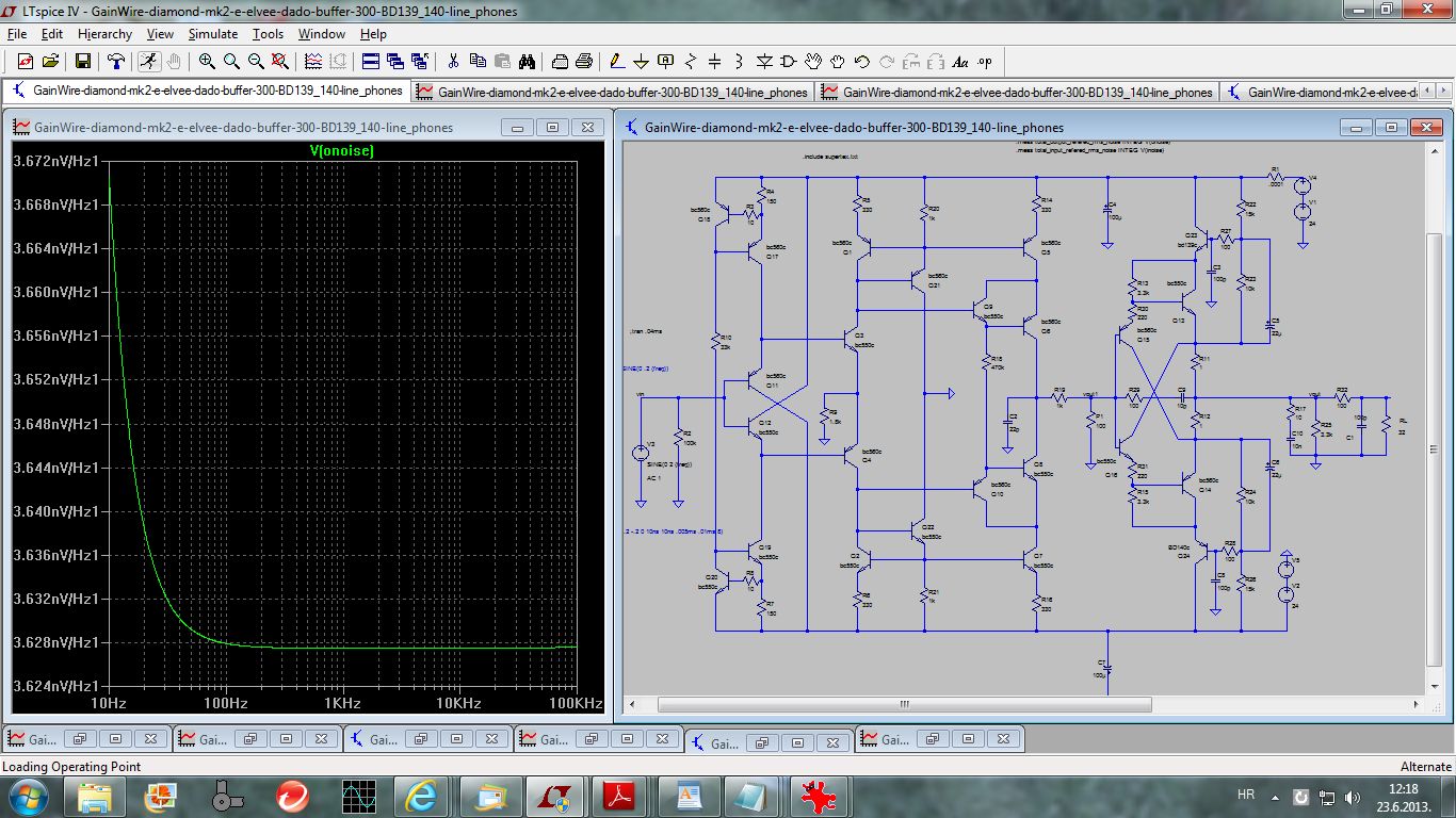

This is schematic I like the most, with simple output buffer.
THD1k at 2 V output is just 0.000066%
Output impedance is 23 ohm flat from DC up to 100 kHz
I kept output resistor, now lower at 22 ohm, to be less sensitive to the long cable capacitance
PSRR abouth 90 dB
Damir
PSRR abouth 90 dB

This one can drive the headphones from 32ohm(Grado) and up to 300ohm(Sennheiser) with very low distortion(second and third harmonics only).
Damir
are you closer and closer to poweramp with this technique? ;-)
You are right, I am thinking haw to do that. There are some power amp of similar kind but with to high distortion.

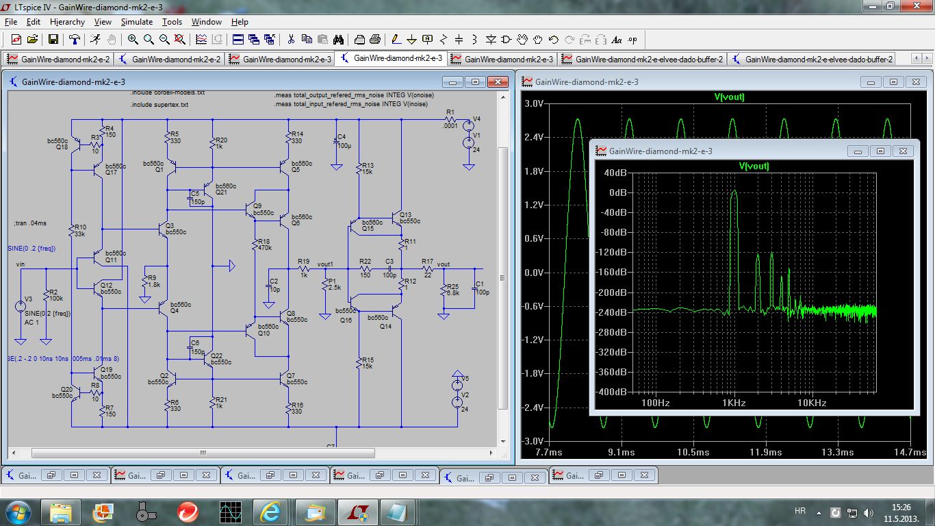

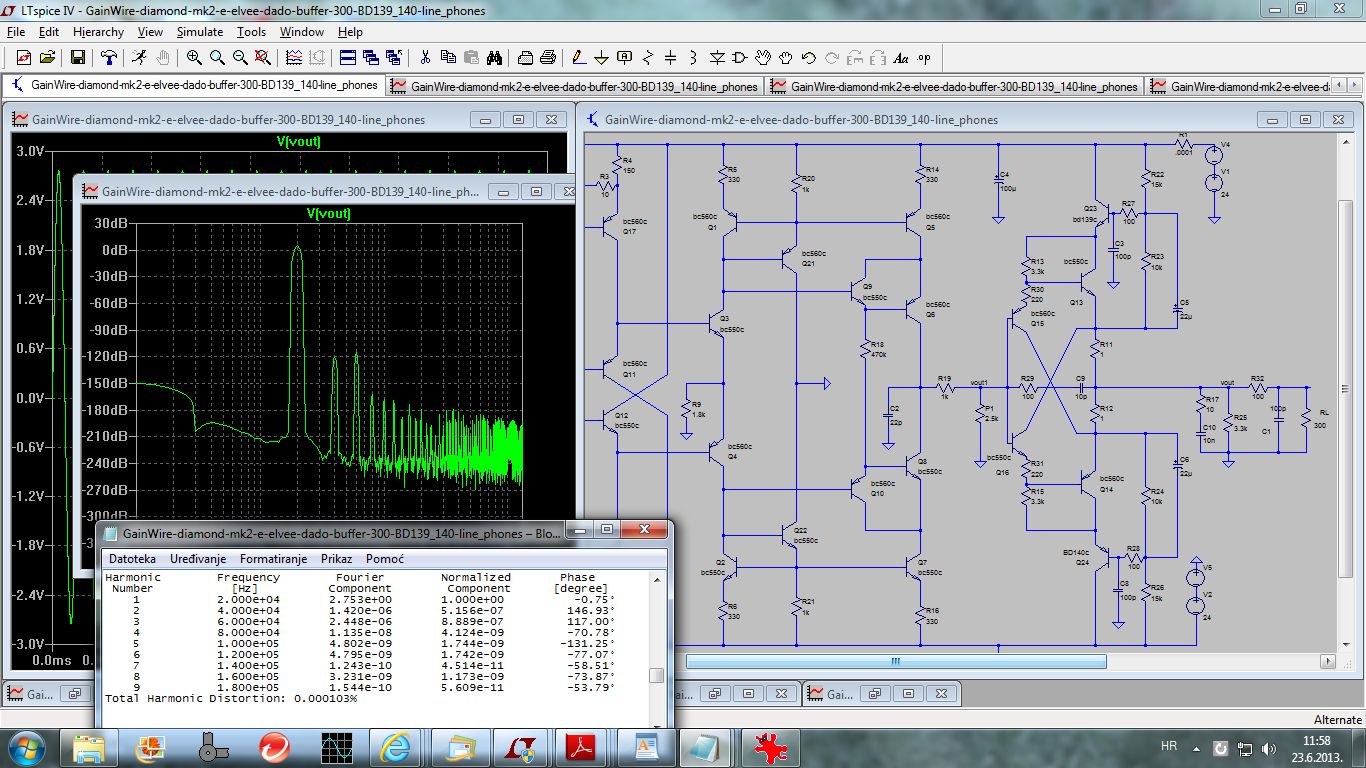

This is simulated THD20k with 300 ohm load(SENNHEISER phones) and THD20k with 32 ohm load(GRADO phones). I don't have time before autumn to make working prototype, that is pity as it should be excellent preamp and no need for exotic components just BC550/560 and BD139/140(or KSA1381/KSC3503 or BF470/471) transistors.
