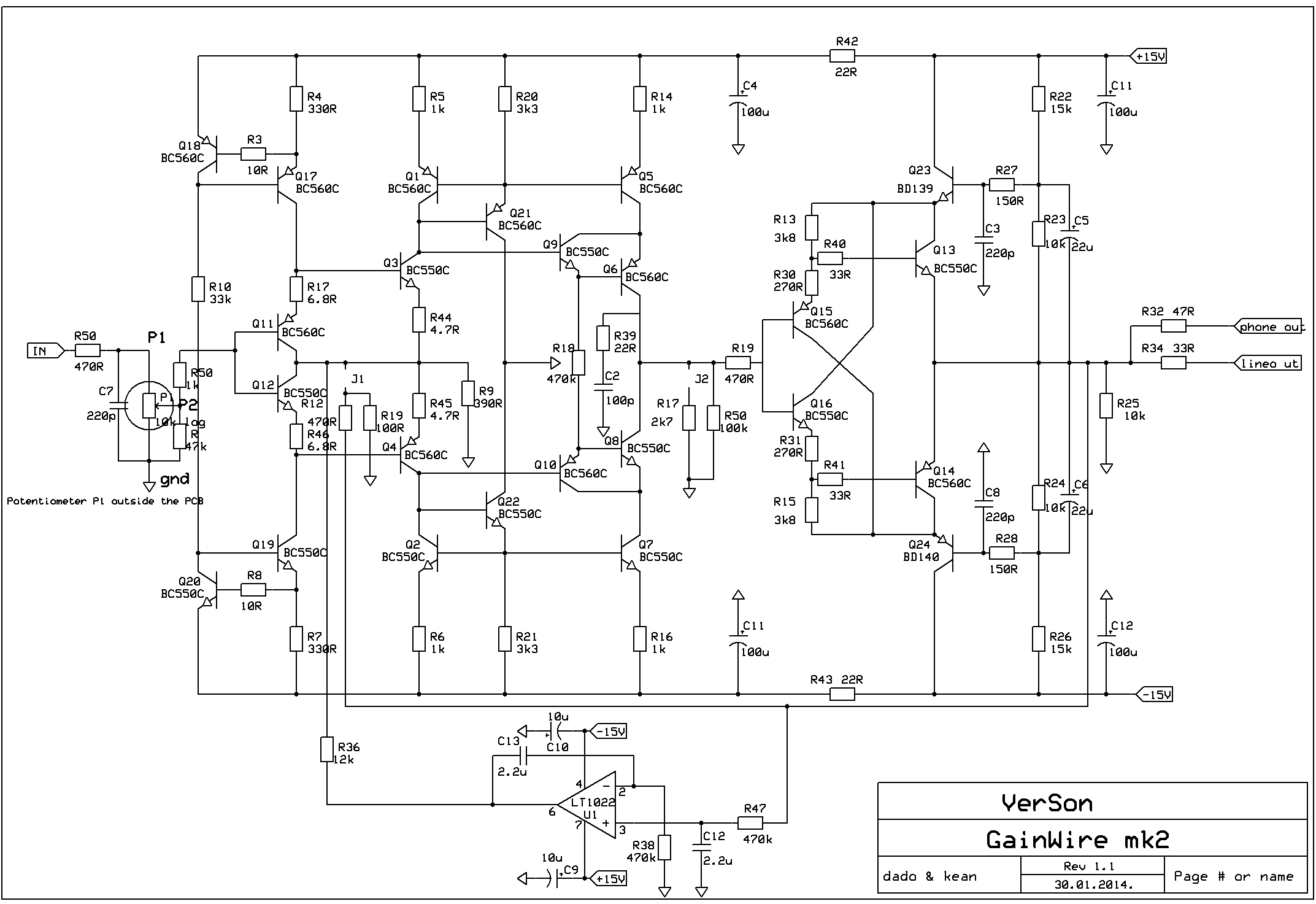

No NFB line amp (GainWire mk2)
Damir,
Wonderful, creative work! Very nicely laid out too.......
How is the sound?
Hugh
Tank you Hugh,
I like the sound a lot, but need more listening, it was just short one.
I know that you like simple elegant work and this one is quite complicate, but ones the layout is set then number of transistors is not important(to me, as small transistors are so cheap).
cheers Damir

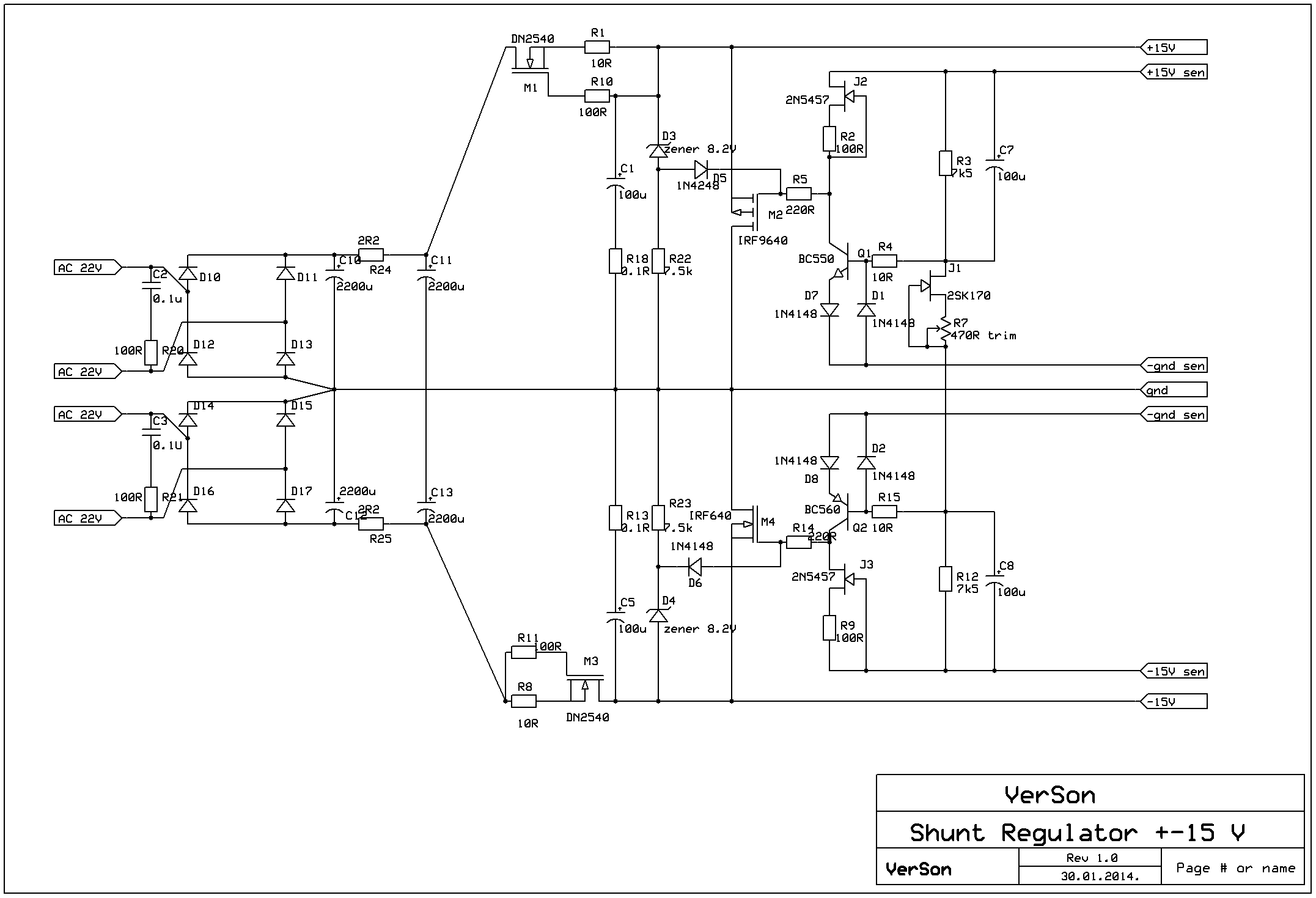

This is tested version and last schematics. During the test I have found some minor layouts faults, and that is now corrected in the new PCB. The PCB contain two pure mono blocks with separate power supply(shunt regulators) common part is the rectifier with big caps.

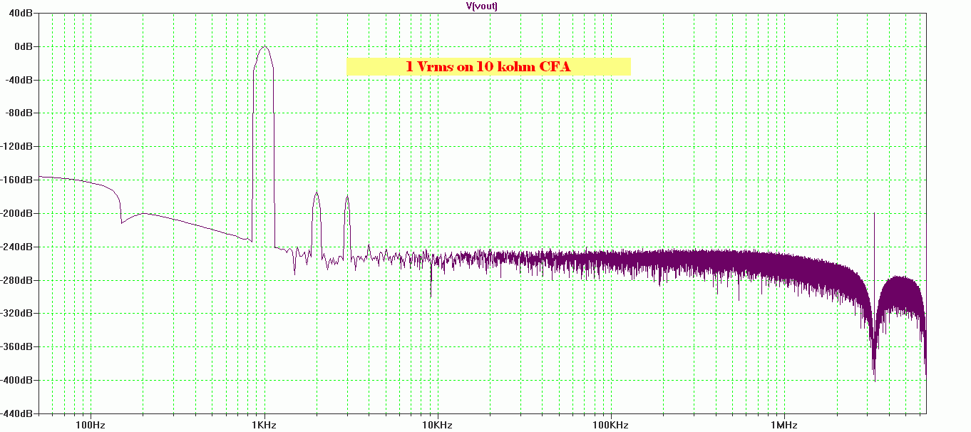

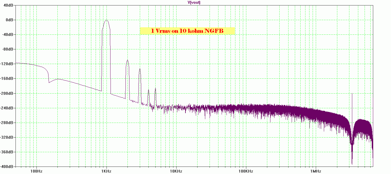

Today I did some more listening, mostly Chesky CDs and SACDs, and some more DVD audio. More I am listening more I come to conclusion that this pre amp is of extraordinary quality. And it shows the strength of my power TT amp too. It did not sound so good never before.
