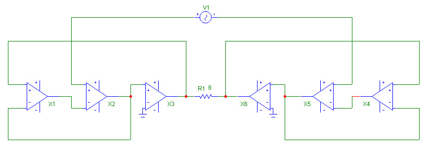

I looked through the thread and realized that I never posted my enhanced circuit which might be similar to this one. I forgot. And never fiddled values to see how low thd can go in the sim No time for that yet.
Can't find my attempts to have signal swing on both sides...
Here my extended version K2 -175 K3 -160 without fiddling.
Fiddling would take a day because the sim is slow on this schematic.
The reasons why I did not post it are obvious :cannotbe:
Try to understand that... If you look on the left side only, it's easy.
The main input is subtracted from the left output = error of left side, and this error is again subtracted from the main input.
Same on the right side plus error of the left side is reamplified to cancel across the load.
[img]http://www.beautyphoto.de/extended.jpg
Here is unitygain's version changed to non-inverting:
All op amp symbols means differential amp: +input - -input = output.
In the sim with real circuit I get best values ever for non fiddled resistor values.
Gain = 1 but same output voltage like in other circuits:
Vop = 4V referred to ground on each side.
K2 = -220dB
K3 = -175dB
new topo
Here is a new circuit, simplified as in above posting:
What is very interesting is that the distortion numbers are absolutely identical with the topo of above posting.
K2 = -232 dB Sorry, typo error in above posting...
K3 = -175 dB
higher orders also -175 dB.
Still had no time for fiddling values.
I believe it is worth to do all permutations of possibilities and that will sooner or later result in zero distortion.
Already with 1 Vop K2 = -247 dB = same as sine source. :xeye:
Re: Now this is strange.
Bernhard said:
The new circuit does not have a connection to the other side, except for the source and the load.
Both sides output stages have K2 and higher of -128dB
But across the load it is -232dB. :confused:
Bernhard, this is simulation. In real life the sides do not match perfectly. In this situation I think cross-coupled topo will win. Try to introduce a little asymmetry to the sim and see.
If you have some chip amps you can try to conduct a quick experiment with them. I'm waiting for my samples...

yes, the symmetrical harmonics cancels out on the output (with a "bridged" amp)
but I don't understant why the 4th, 6th, 8th... aren't also -232dB down
