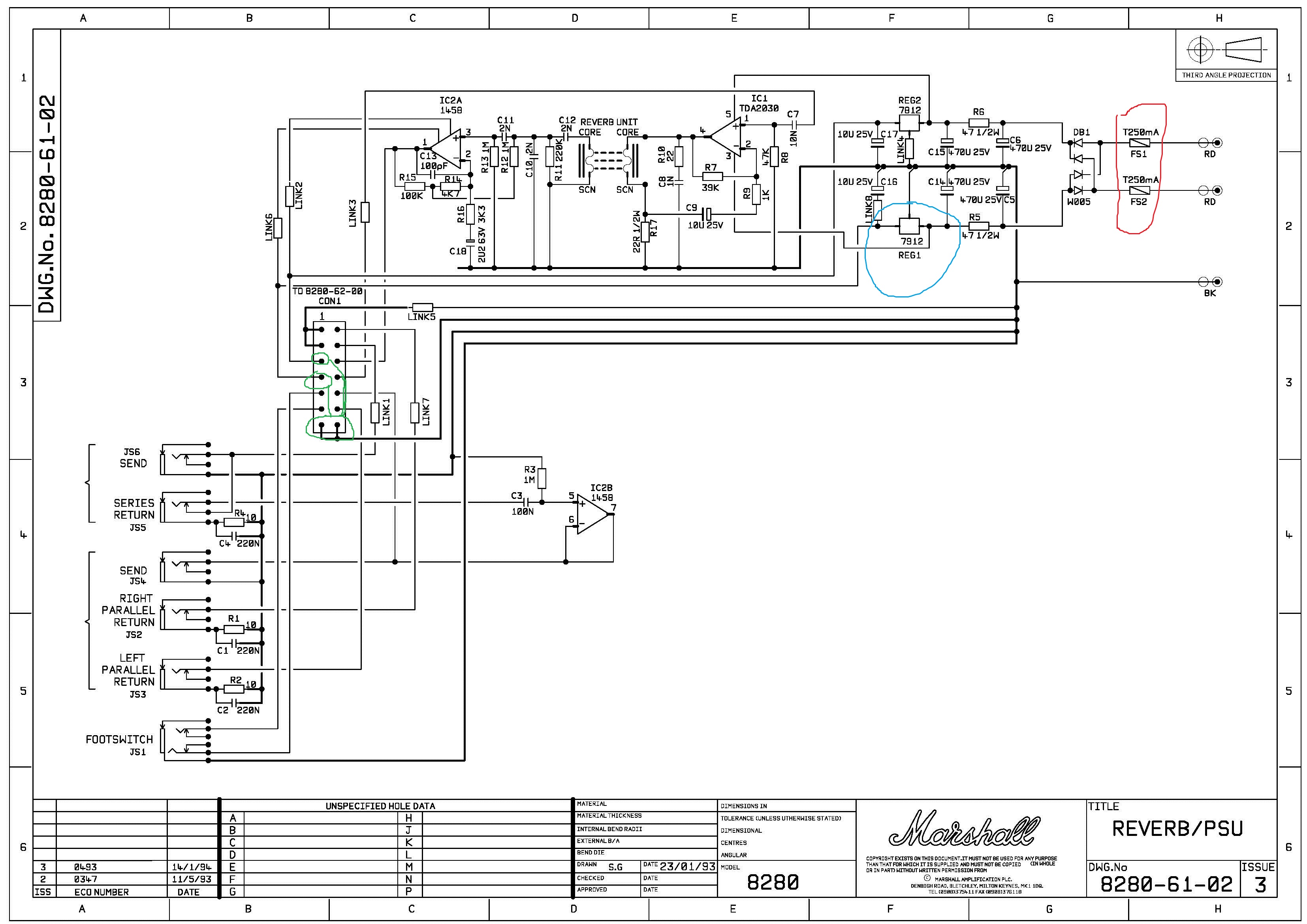

I found a schematic on the net which I included below.
I measued on the Reverb/PSU board.
It is 12VAC in from the transformer.
FS1 and FS2 have high resistance. Don't know which values it should be.
REG1 is possible to move so it needs to be resoldered.
No voltage between pin 3 or 4 and 8 in connector 1(pins on the left hand side).
If high value on FS1 and FS2 indicates that they are gone, can the problem with REG1 causes that?
Replace REG1 as well?
They seem to be fuses. Resistance should be very low (fraction of an ohm.) High resistance tells you that both fuses have blown.
Since the fuses that supply power to the board are blown, this is to be expected. You won't find any voltage anywhere on the board till the fuses are replaced, and the fault fixed so they don't blow again.

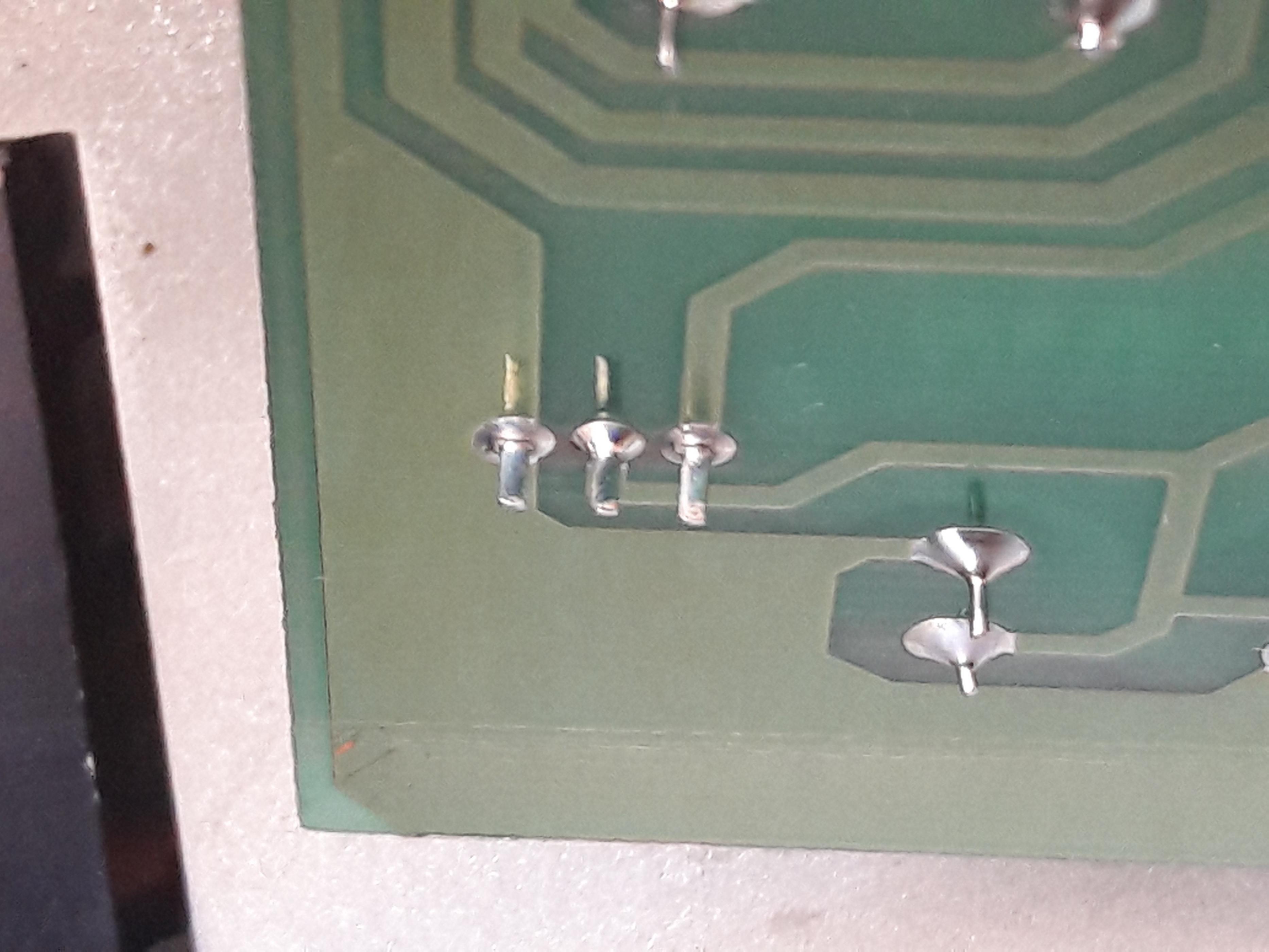

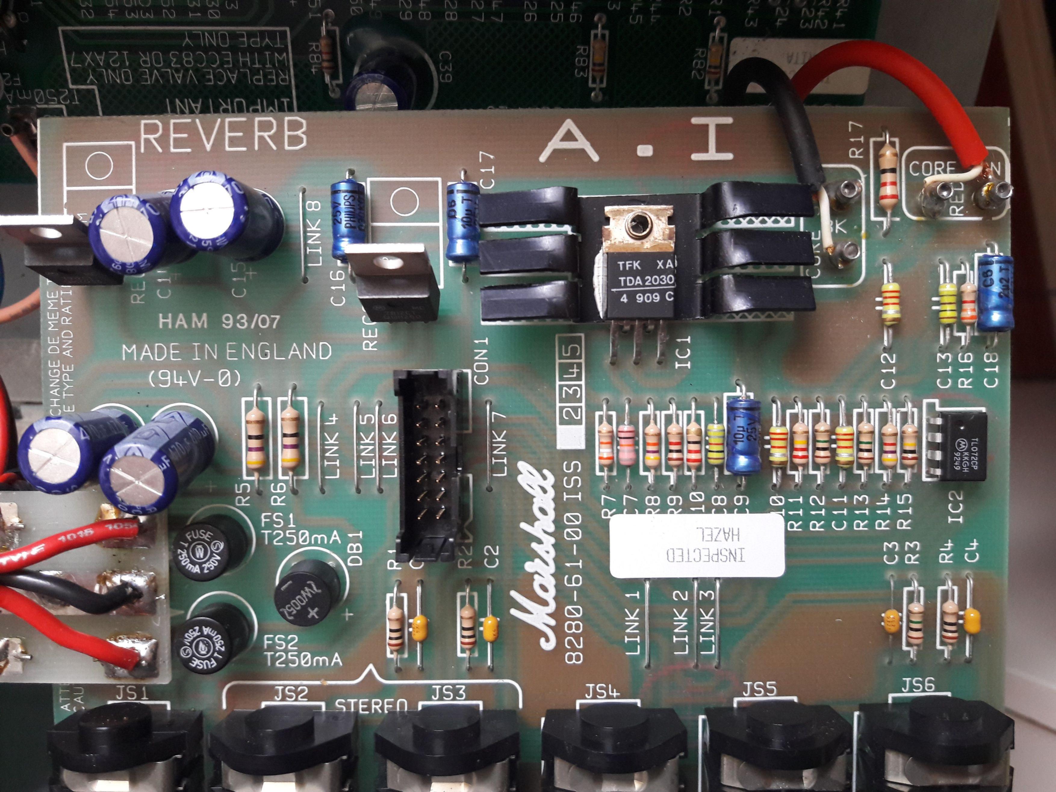

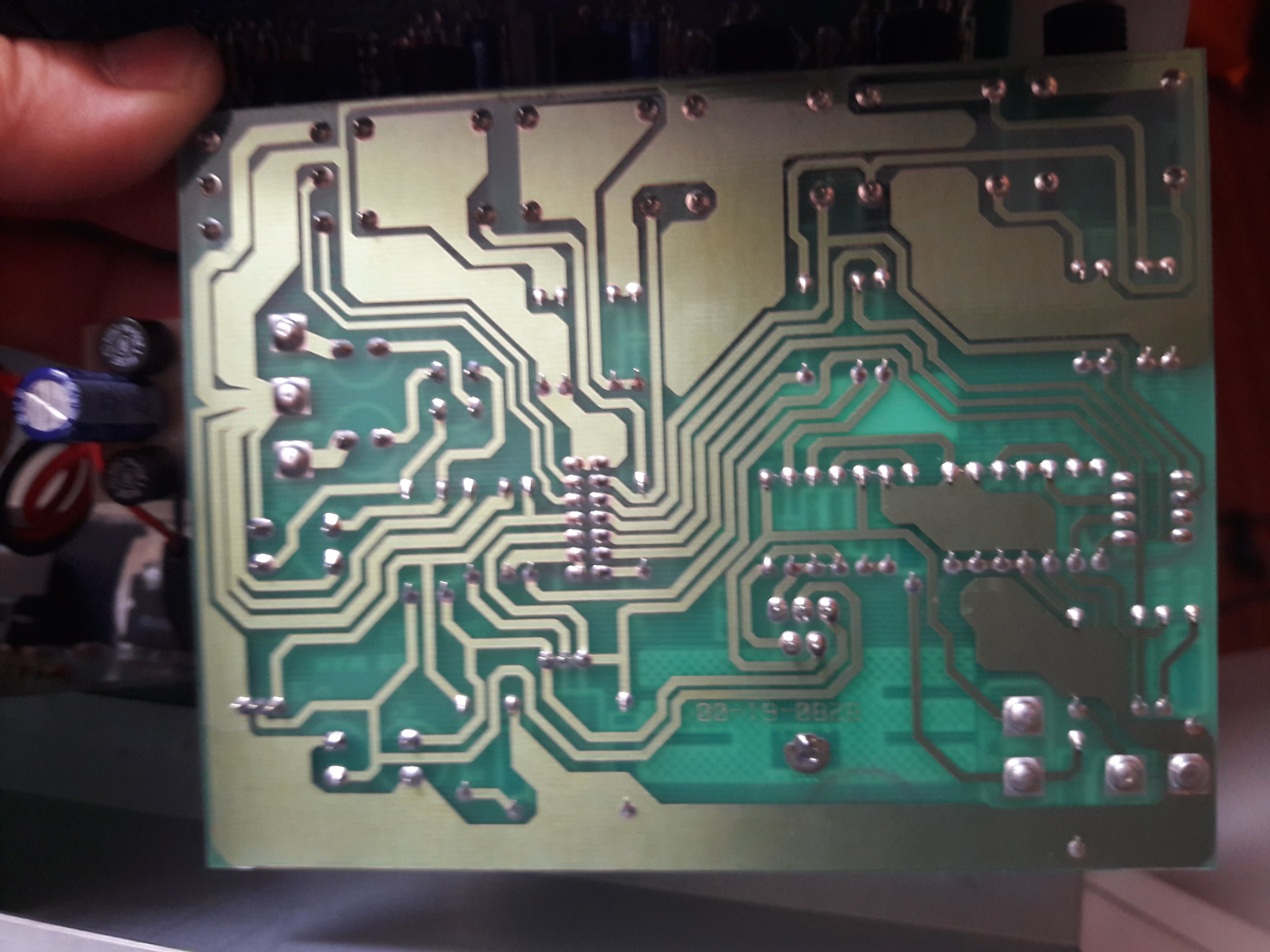

Now I have had possibility to included photos.
PCB1 and 2 is the reverb/PSU.
Solder crack is close up on the Reg1 solder there cracks are visible.
Otherwise, no visible damage on the PCB.
Good starting point, at a minimum, those solder joints need to be heated up and re-flowed.
The big question is why those joints failed. Did the regulator overheat enough to unsolder itself? Or was there some heavy physical strain placed on it (vibration, bending, etc) that cracked the solder joints? Did it repeatedly overheat and cool, so that thermal cycling cracked the solder joints?
There may be a clue in your sense of smell: sniff that area of the PCB. Does it smell burned or charred?
If there is evidence of overheating, you might consider replacing that regulator. But the other question then is, why did the regulator overheat? Did something else on the board draw too much current?
I suggest using an ohmmeter, and checking between pins 3 and 5 of the TDA2030 to see if they are shorted or not. They should not be shorted - if they are, the IC may have failed, or there is another problem somewhere else on the PCB causing a short between the positive and negative supply rails.
-Gnobuddy
Those regulators are just sticking up from the board, no support.
I noticed that, and the PCB markings that suggest the regulator body was intended to lie flat on top of the PCB. No through-hole in the PCB to bolt down the regulator's heat-sink tab, but at least it wouldn't be so tall and prone to vibration.
I wonder if those regulators have already been replaced once?

As you see in the pic there are visible cracks at pin 1 and 3. When wiggle the reg pin 1 and 3 moves on the back of the PCB but not pin 2. I removed the reg and as I suspected, pin 2 is broken at the PCB. Interesting that it could work flawless but break next power on.
