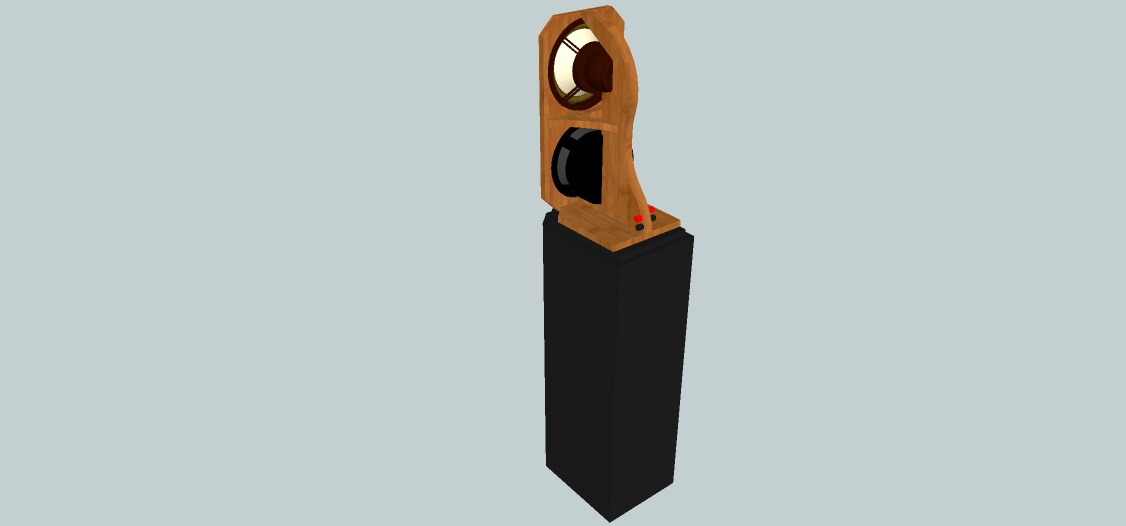

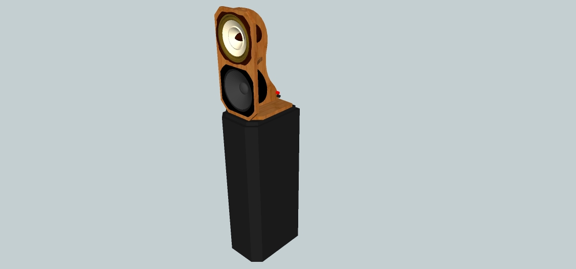

I have attached my own take on the ultimate Lowther speaker. Pm6A nude crossed to an Eminnence Delta 8 and a cardioid loaded U baffle and two Tang Band woofers also in Cardioid. Cross over will be from a reworked Berringer DCX 2496 with op amps replaced with 24 step isolation style transformer attenuators, for level matching out to a triamp set up. Another stepped attenuator for the master volume control.
We will see how this works out by misd summer, work on the DCX begins after Christmas, along with the relatively simple cabinetry work. The drivers are all EnABL'd, of course.

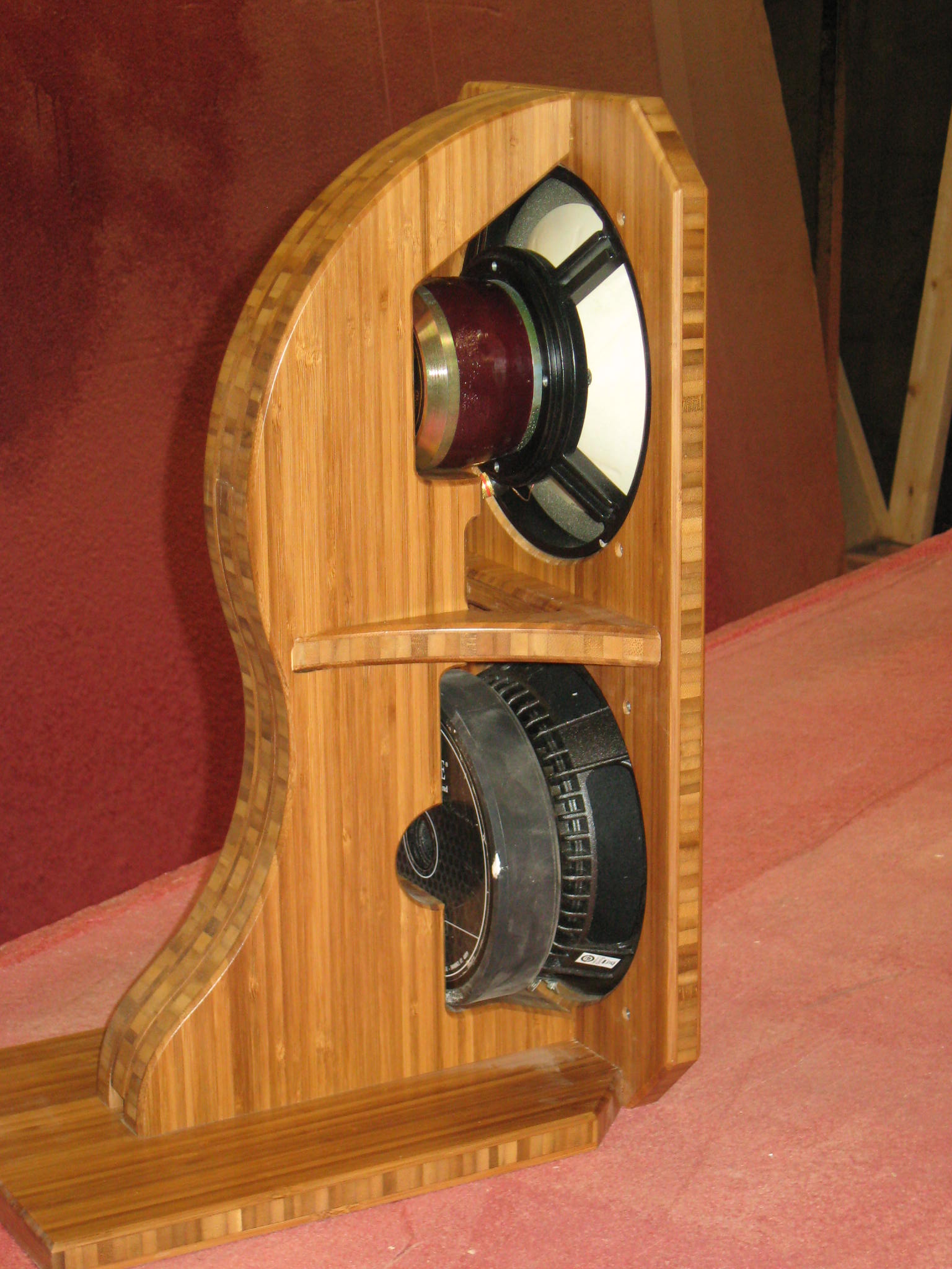

Well, a few years and concept revisions later, the initial build of the OB section looks something like below (reconfigured to match different woofer design) - I'm looking forward to making the trip to hear final results myself (and perhaps another crazy good Rene Jaeger amplifier) :

I just wish the rest of you could come and see the workmanship Chris and his crew of northern elves manage. I have, actually, quite a few examples by now and this latest is a testimony to his sense of compassion, forgiveness and humor.
As to the sound. Imagine a loudspeaker that isn't confined in any meaningful way and you have the start. Gen 2 EnABL has proven to be more than a match for the PM6A and the Delta 8, though that one has struggled long and hard. The sound is all of the usual cute phrases. Especially the one's about 90 db down coherence. Unconfined and ebullient come to mind. Sounding just like music and not at all like speakers might be the only drawback for some folks.

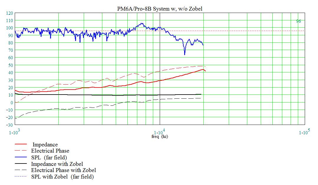

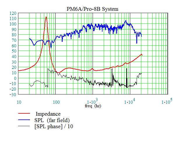

Even more fun, the measured response is just as correct. The graph below, taken by a Boeing engineer who frequents this site, is unsmoothed. He suggested an electrical phase correction Zobel for the Lowther and that was a remarkable step towards music. He has also suggested a notch filter for the 7 to 11 k hump. A -3 db notch yet to be applied. He also designs contest winning speaker systems that use series crossovers, which is what Jon VerHalen has provided for open baffle Lowther PM6A drivers and Tone Tubby Alnico 10" drivers. Works a charm here too, though there are some interesting absolute phase issues to work through. The second graph are his expected plots, not an actual measurement, though the FR plot is real enough.
