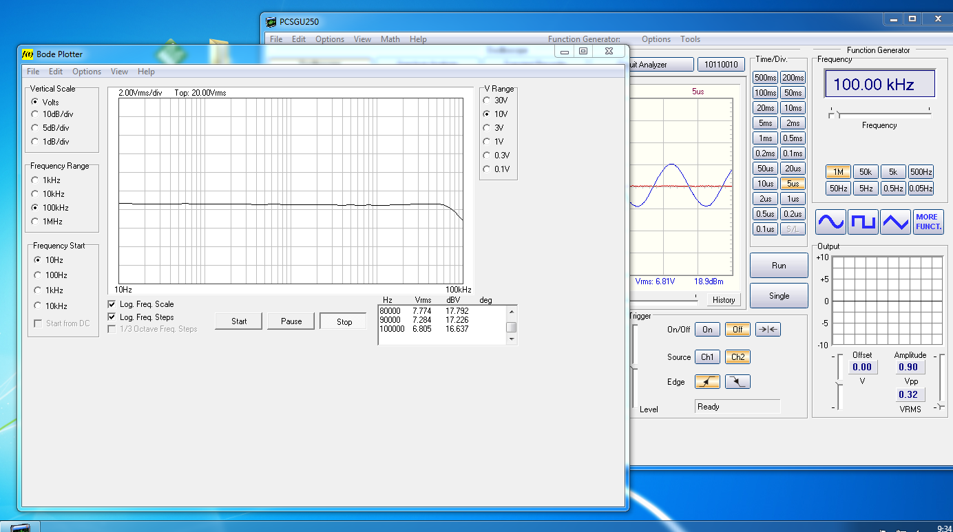

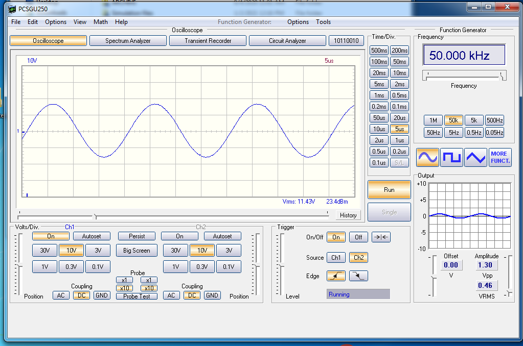

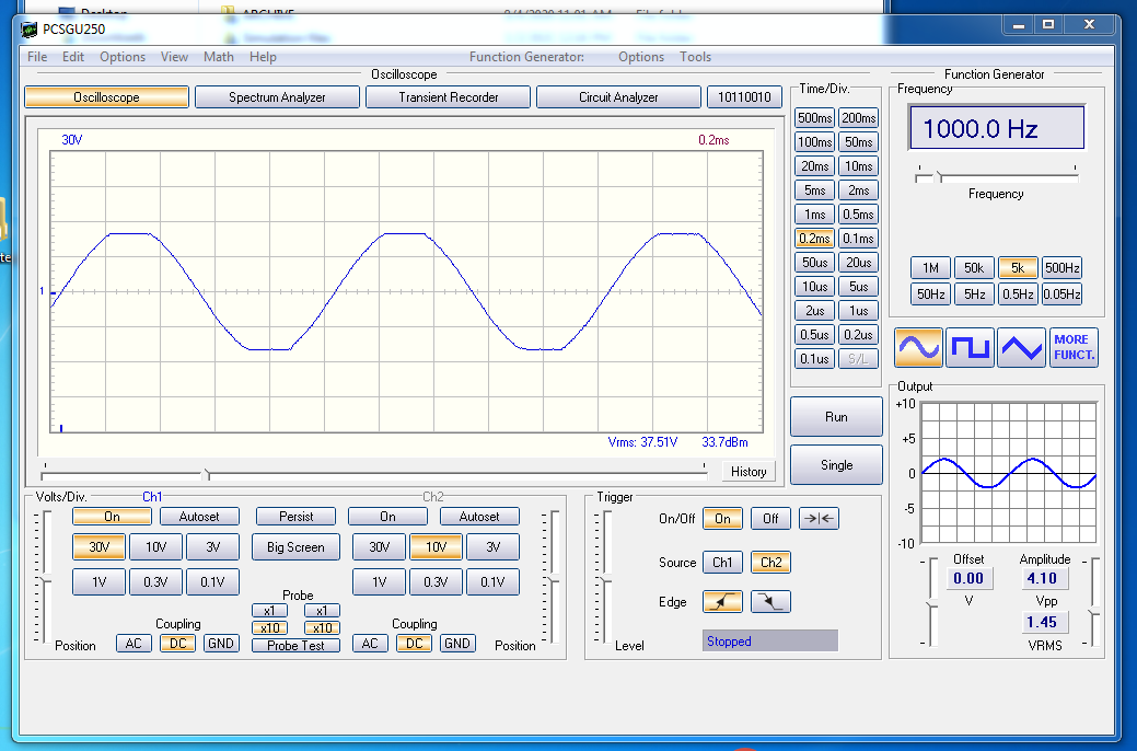

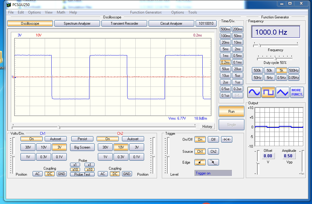

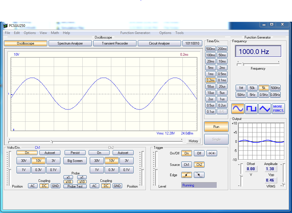

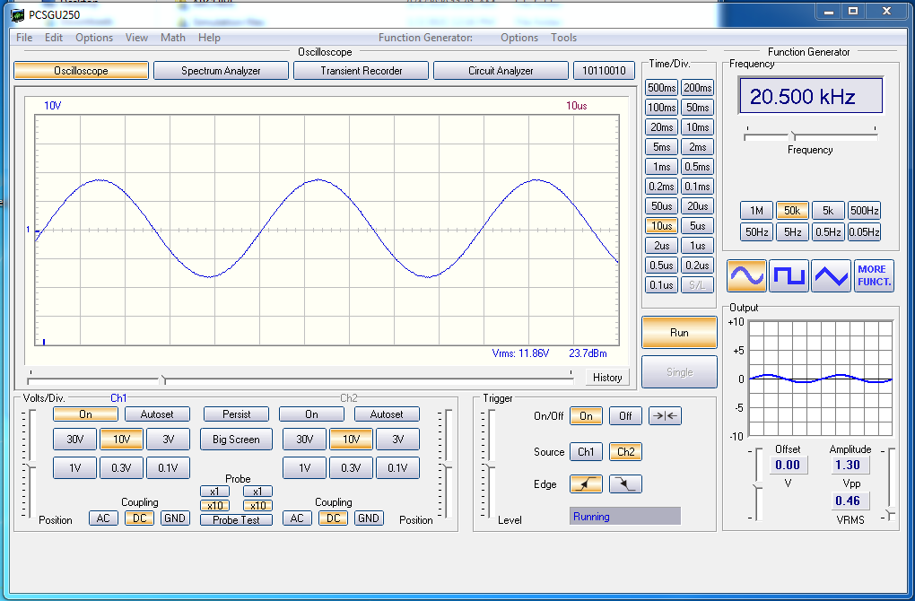

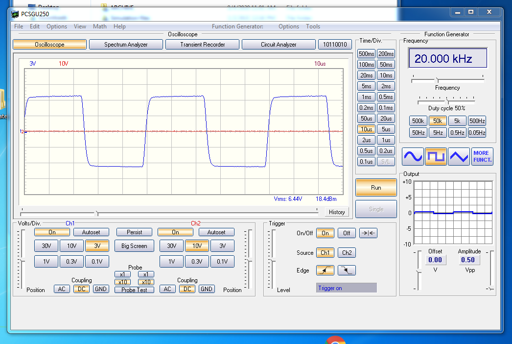

I've managed o get back to doing some testing on the AX-3 amp. I tested with +/- 56VDC supplies. It's very well behaved and clips nicely at 150W output. Surprisingly with a dozen output devices it doesn't generate a lot of heat on the scrap metal heat sink I'm using so I should be able to thrash it harder. I'll have to figure out where I put my high voltage supplies.
As Valery suggested it's running with OPA2134. My current test speakers in the lab are pretty much embarrassing but the amp sounds good with no sign of hum or hiss when playing through them. Next on the list is to design some power supplies for these monsters and test a new concept in protection system for it.

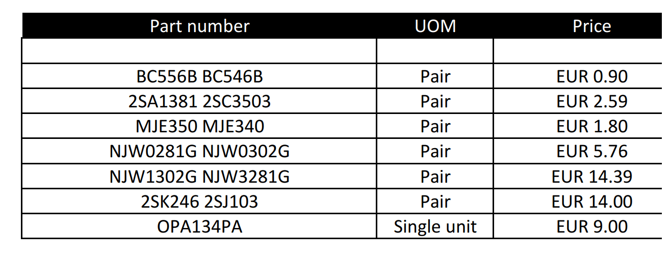

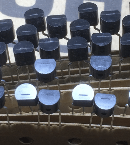

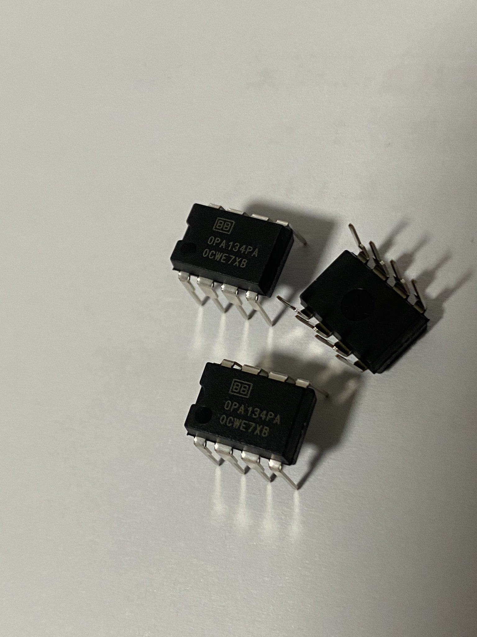

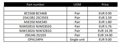

Simpelstark amplifier rare components are available in addition to other components.
All components are 100% genuine no fakes.
Anyone interested please PM, there will be a fixed shipping fee of $25 via DHL or FEDEX & 5.5% PayPal fees.
BC556B BC546B |
2SA1381 2SC3503 |
MJE350 MJE340 |
NJW0281G NJW0302G |
NJW1302G NJW3281G |
2SK246 2SJ103 |
OPA134PA |

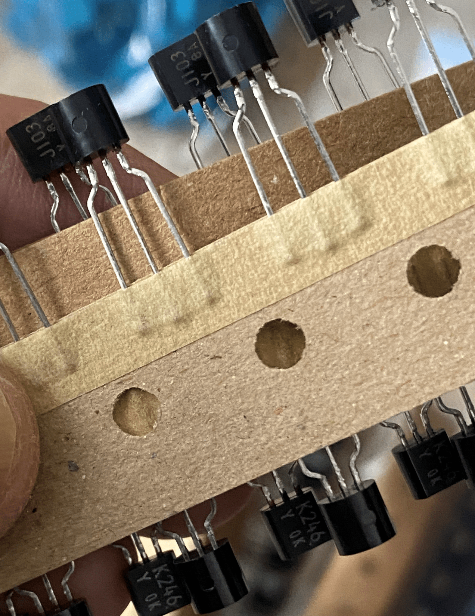

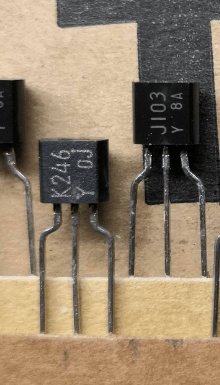

Hi to all of you.
I wish a happy New Year!
Resently i'm in troubles with my Simpelstark.
Protection activieted as a result of 4v d.c offset.
I come to the conclusion that the problem is due to the input pair.
The fact that the input fet class is not specified adds a difficulty too.
I would be very happy if anyone can recognize and analyze the input stage topology.

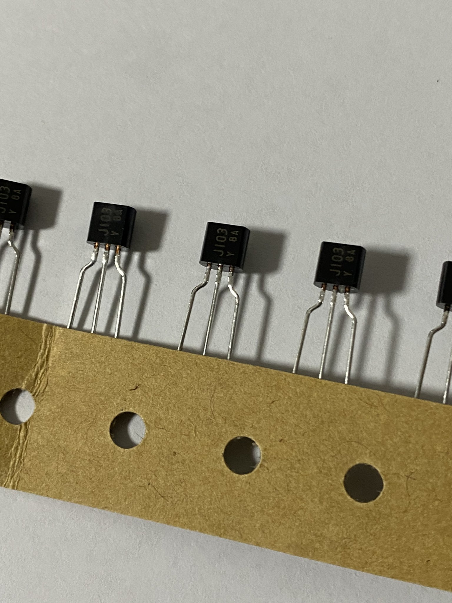

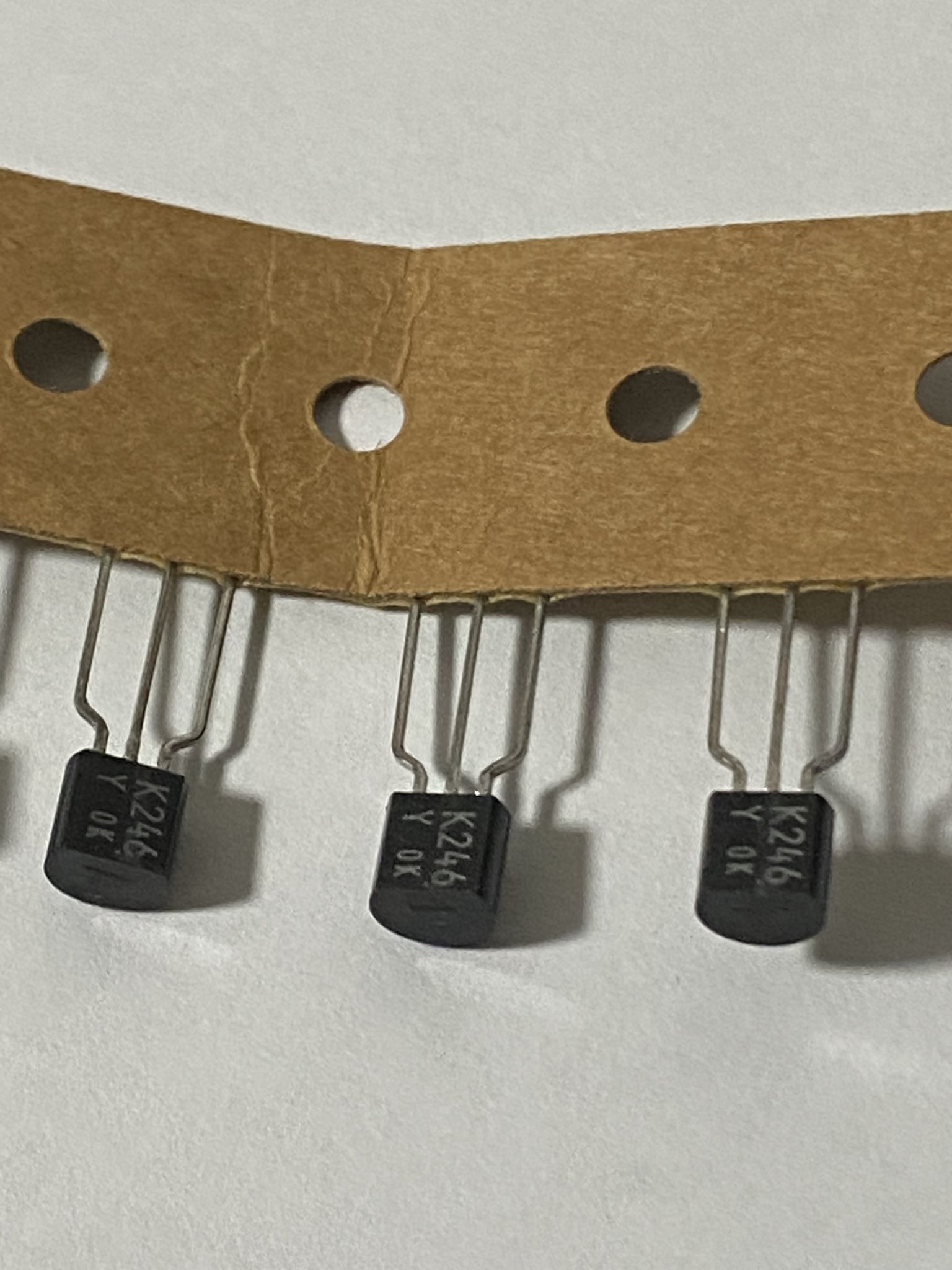

Hi Jeff,i have measured across R9,R14.where are you measuring the current flow in the input stage?
Using 2SK246-J103 Y grade VR9=1.4V IR9=VR9/R9=1.4/560=2.5mA
VR14=1.4V I=2.5mA
VAS current across R22.R23 VR22=1.4V IR22=VR22/R22=1.4/220= 6.3mA
Using 2SK246-J103 GR grade VR9=1.9V IR9=VR9/R9=1.9/560=3.3mA
VR14=1.9V 3.3mA
VAS current across R22.R23 VR22=1.9V IR22=VR22/R22=1.9/220=8.6mA
Using 2SK246-J103 BL grade VR9=4.4V IR9=VR9/R9=4.4/560=7.8mA
VR14=4.4V 7.8mA
VAS current across R22,R23 VR22=4.4V IR22=VR22/R22=4.4/220=20mA
Power Supply=+/-45V
Yes,i beleive Y would be the right grade.From your measurements it looks like y grade are the correct fets. Valery usually designed inputs to operate around 2.5mA and VAS to run between 5 - 7 mA
