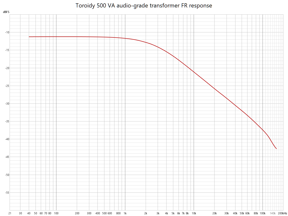

Here is measurement taken on the audio grade 230 V / 500 VA toroidal PS transformer. Primary was driven from high bandwidth amplifier and secondary was loaded with some 80 mΩ resistor. Actual transferred power was only 2 W, but enough for a meaningful measurement.
Connecting static screen to PE ground, didn’t change result even for a fraction of dB. Looks like static screen would have no effect on possible SMPS noise.
I was before also examining power supply noise spectrum up to 380 kHz (LNA + ADC + REW) and there was no difference at all, in that frequency range, disabling RF mains filter (Schurter) or disconnecting static screen on transformer.
However, I’m certain that differences in the MHz range would be considerable.

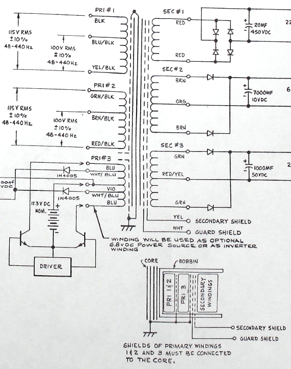

For a screen to be effective, it needs to dump the crap it intercepts somewhere; lots of people think that PE is ideally suited to that purpose, but PE is generally as dirty or dirtier than its companion mains: they follow the same route, are heavily inductively and capacitively coupled, and in addition PE is used to conveniently dump the crap collected by omnipresent Y caps.
What a screen can do is to convert all the differential perturbations into common-mode ones; is it useful? It was when AM radio sets ruled, but nowadays, CM problems have become the hardest to solve.
The best option, if you really want to use screens is to have a primary and secondary screen: the primary screen is connected to the PE or to two X or Y connected to the mains, and the secondary screen is connected to the secondary GND.
If the PE is connected to GND (like in class I devices), dual screens make no sense.
For an effectiveness measurement to make sense, it needs to measure the conversion from primary CM to the secondary DM, and the secondary DM is not the secondary winding (which can be shunted by a 100n ceramic anyway), but the signal of the secondary-fed circuitry; much less obvious, and much trickier
