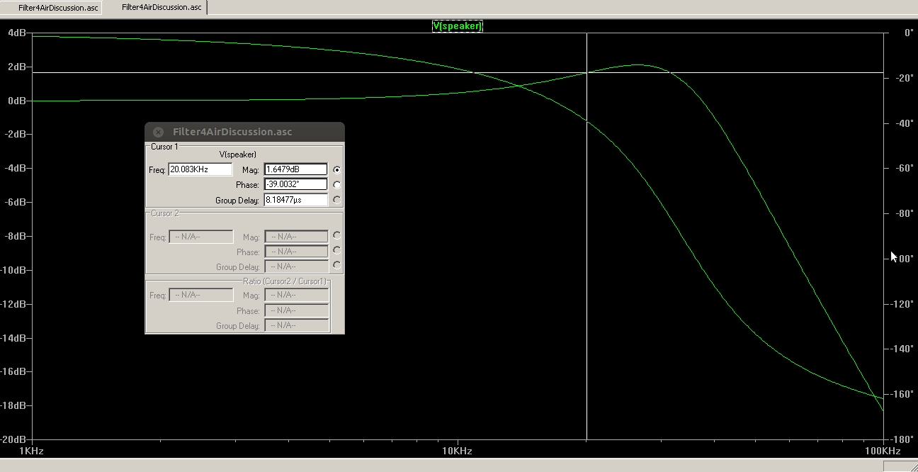

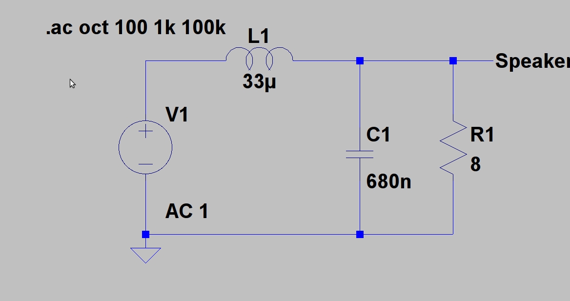

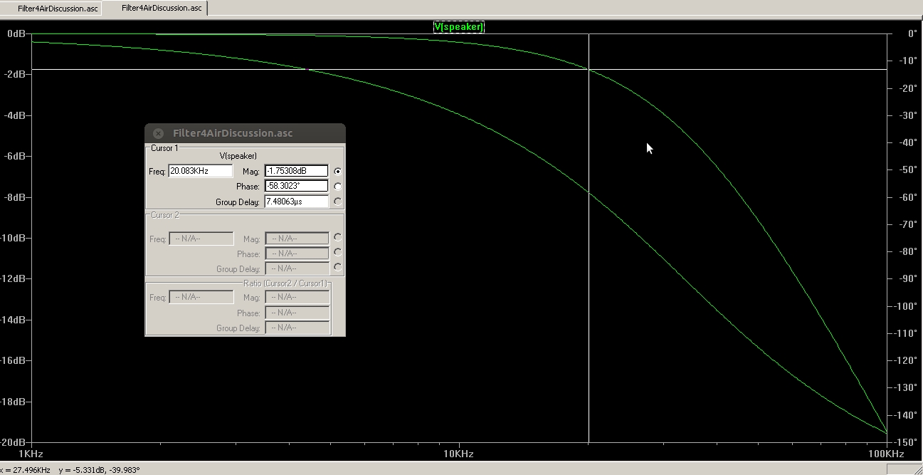

Hi Nigel,
I agree that it is possible to solve it reasonably good.
But that's not at all the normal situation in class D these days.
Let's have a look to a real life filter as attached with values that are not exotic.
In case of 8R the signal will be boosted more than 1.6db at 20kHz.
In case of 4R the signal will be defeated more than 1.7db at 20kHz.
Obviously many output filters will affect the frequency response in a non neglectible way.
Furtheron the difference of 3.4db between 4R and 8R tells that the tweeter is driven with a pretty high impedance. Effective Z is in the range of multiple Ohms. Means a damping factor far below 10.
I am not at all a damping factor fetishist, but such low values simply do not ensure voltage drive for the tweeter.
Someone might now say that speakers are not purely resisitive.
True. But better don't hope that correct equivalent circuits of real speakers would cure things.
