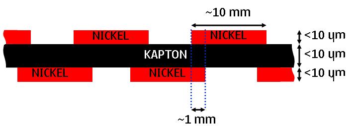

I made an interesting FEMM simulation.
What if we have long ribbon 200 x 2 cm and rotate magnetic flux and current 90 degree? So magnetic field is vertical and current horizontal ;)
With a nickel ribbon you can do it !!! :cool:
Magnetic flux flows the whole 200 cm from up to down in the nickel ribbon and is looped back in an iron rod. There is only one relative small magnet in the loop somewhere. Can be neodym or ferrite. Total loop length is about 4 m but the single magned is enough since in the ribbon the area is really small. Only 2 cm x 10 um.
Imagine: You need only one cheap magnet !!! Total magnetic flux is only about 1/100 than needed with traditional ribbon. Sounds cheap. You cannot do that with an air gap. With a ferromagnetic ribbon you can.
But then again... current should be the same ~100 times larger if same sensitivity is needed. How to do that?
In my simulation I divided the nickel ribbon into 1 cm tall horizontal stripes like shown in the attached picture. Sides of the ribbon is glued on the speaker panel and each stripe is connected together with a solderd wire. They form 200 stripes and 199 wires in series so that the same current flows 200 times throught the same ribbon. That´s it.
I simulated how this laminate works and it works fine. 200 x 10 um gap between nickel stripes don´t decrease much magnetic flux density if stripes are a bit interleaved. 1 mm in this simulation. Magnetic flux is over 1.5T in the whole ribbon! Practically saturation flux density in nickel. WOW :)
Unfortunately induced flux in the ribbon has nothing to do with the net body force from the current
I don't expect to see a bar magnet move around when I put a current thru it (assuming symmetric current return)
I believe you will find that the Lorentz force on a hi perm ribbon is little different from a low perm ribbon, the "increased field" force on the electrons inside the high perm ribbon only cause some current crowding ~= asymmetric skin effect but no net body force
Sad but true...
During few night I fiqured it out. If you could use planar magnetic to move it´s own magnetic field then you would have either perpetual motion machine or anti-gravitation device.
So much about this thread. But if anyone find out any real usage for ferromagnetic foil then please speak up :)

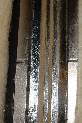

gl said:
Hi jcx,
The Magnepan "true ribbon" is supported by alternating dots of adhesive at intervals along the edges in addition to usual support at the ends. Maybe it's a special case because of its length.
Cheers.
Graeme
Fwiw, they follow in others footsteps.
The Decca ribbons were supplied with some heavy silicone grease type "goo" that was intended to be applied on either side of the ribbon at approximately 1/3 down and 2/3 down the length of the ribbon.
I suspect that the main intent was to limit certain nasty nodes/standing waves and to prevent over excursion if hit with too much LF...
