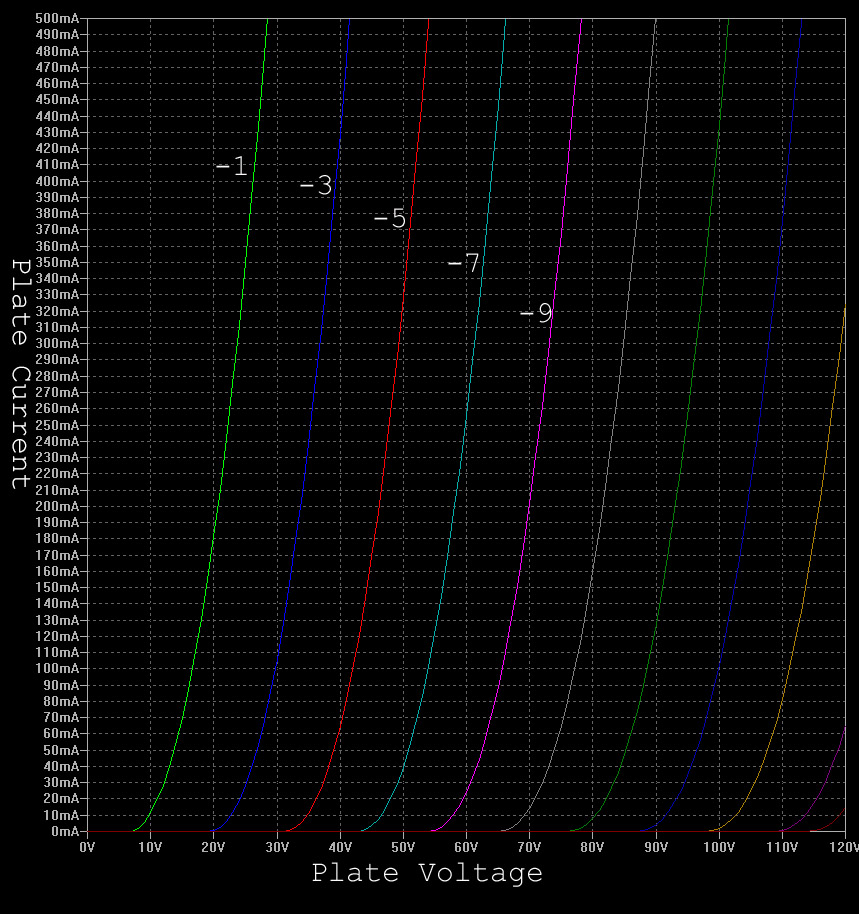

You got me . It´s Sonys old V-FET 2SK79.
Enjoy the data-sheet.
Anyway I got amazed when I saw it. Why don´t they continue to make tubelike sand?

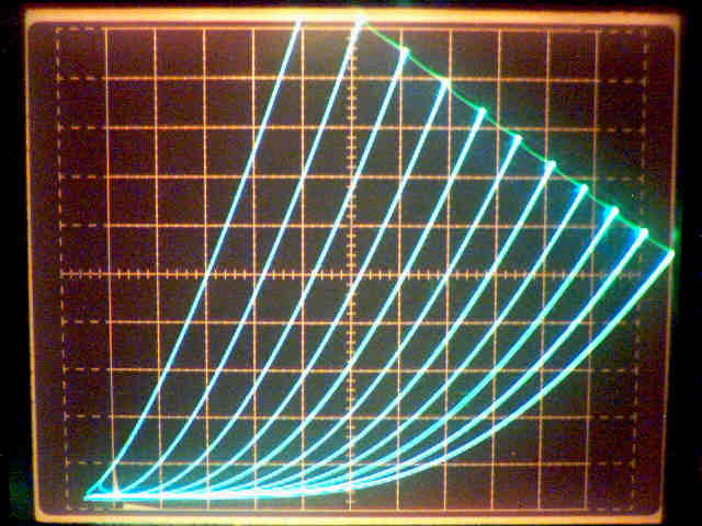

Well they didn't get the $2 dollar ones at least: (a common high gm video amp tube in triode mode, see attached)

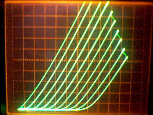

Here are some curves, for comparison, of a typical horizontal deflection tube in triode mode: 100 mA vertical axis, 200 V horiz. axis, Mu 4.2, gm 10,000 @ 80 mA
Don
The curves LOOK like an EL36, but that much current would cook 'em

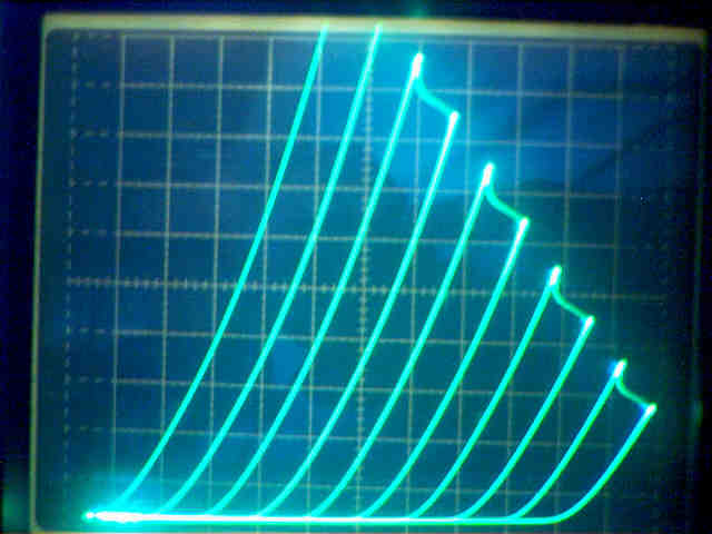

"The curves LOOK like an EL36, but that much current would cook 'em "
The 1st curves are for a 6HJ5, a rugged 24 Watt tube. The 100 mA and 200 V figures are for the full axis (not per div., if that's what you were thinking). But a 6HJ5 will do a 1/2 amp readily. Futtermann used them for one of his OTLs. The triode curves are fairly similar for the other horiz. output tubes (18 Watt class) that I have looked at. Most of them have a Mu of around 3 to 4.7

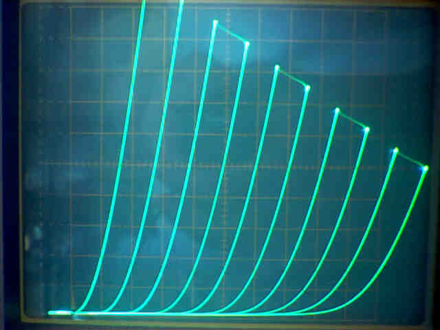

Well, lets take a look at some of the "black sheep" in the tube family now. Here is the triode in a 6KR8 or 6LQ8. Sort of an extreme version of the 12AT7. Notice the curves falling over to the right side. These may still work OK in P-P. But will have heavy 2nd Harmonic in SE.
