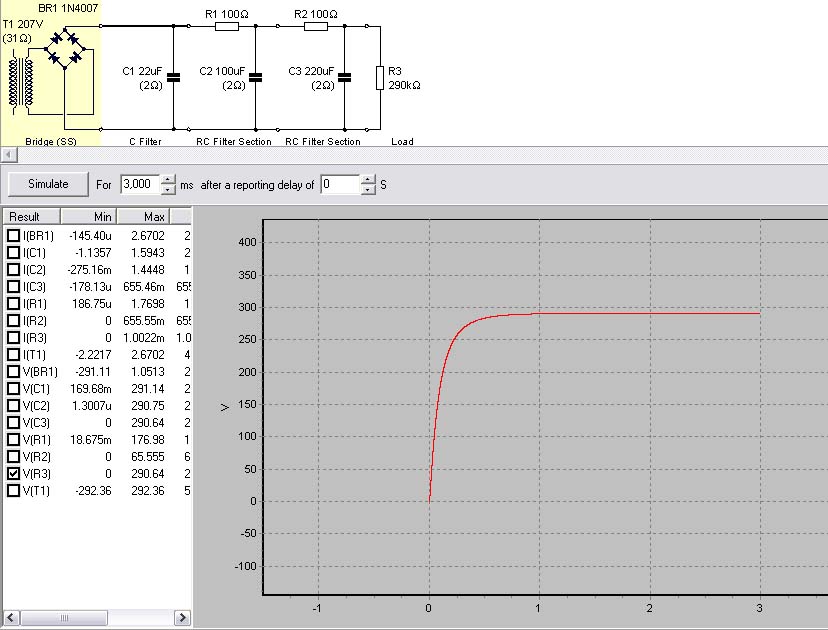

Hi,dave dove!This is my project report to build this simple preamp:
1.Finally i use this configuration for my PSU: 22uF-->100r-->100uF-->100r-->220uF+220k parallel as a bleeder.
I got a a very smooth ripple.My mains supply is 220v.I use back to back sytem using 2 transformator (each 2 ampere).I do some test and get only 207VAC after back to back.After through bridge rectifier,it should be 293VDC.
My question is, in the SJS's website this 12au7 preamp only need 280VDC not 293VDC,so,how to drop the voltage until 280VDC?Should i use voltage divider?
Or, use 293VDC as a supply but do some changes in Rplate's value?How to calculate this Rplate's value?
Need ur help please!

thomgun
the bleeder resistor does not go into psud
if you right click that
select change
select constant current
set to 20mA
you now have 280V
if you change C2 to 20uf watch the rise time/line
it will shift to the left
this indicates a faster psu
you still have enough smoothing
and it's cheaper too
when are you going to build it?
dave dove

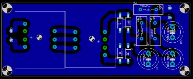

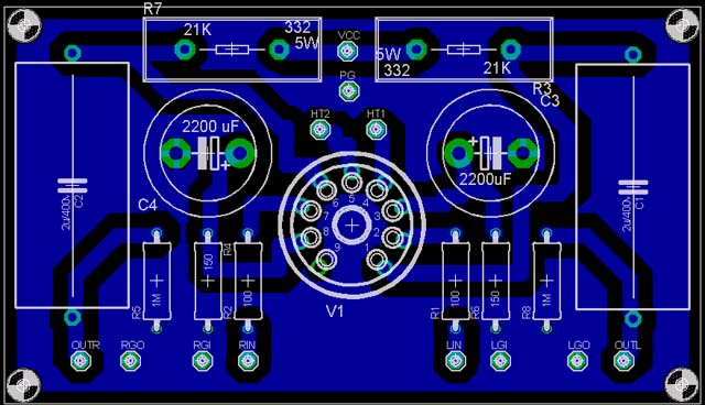

My progress report to build this tube line preamp:
I still do some changes on the PCB because i use a small chassis. I wouldn't put the transformator and the tube outside the chassis, that's why i try to reduce the size of the PCB.
Here is the PCB. Please take a look at my pcb:

thomgun
your pcbs all look OK
but i have never used pcb
i cannot comment on your DC heaters
i've never bothered with them
a cheap choke will be worse than resistor
i have tried hammond 157g 30H 40mA
and they do work ok
i don't know if you can get them
but
your power supply looks fast enough to me
when are you going to build it? ;-)
