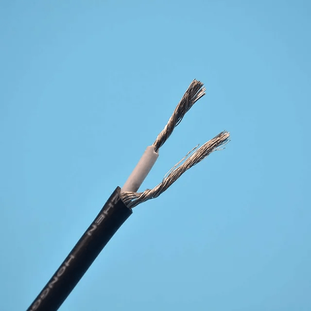

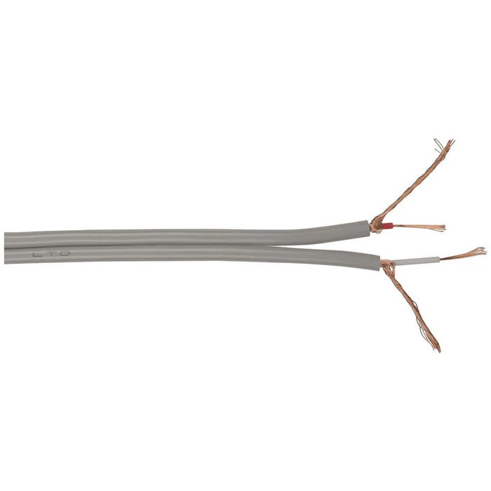

1. I would use single core shielded audio cable.

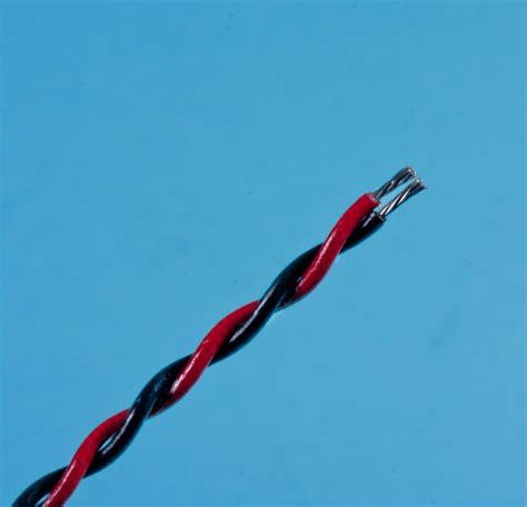

2. I would consider twisted pair cable. Does not require to be thick as current draw will be low.

Others have found that unshielded wire pairs, twisted together, achieve good results, especially when Money Is A Concern. I have some old single conductor 20 gauge twin wire that looks similar to the twin wire above, but without the shielding. I use one wire for signal, and the other for ground. It works fine for my MoFo.
Routing the input wires in different paths can also have a noticeable effect on the sound, depending on where the mains connector, power supply and PCBs are located.

If you’re only going 6” from the RCA to the board you can get away with just twisting two wires together with one ground and the other signal. Keep the signal wires away from the power wires. Don’t over stress this. If you get hum then use single conductor shielded cable.
