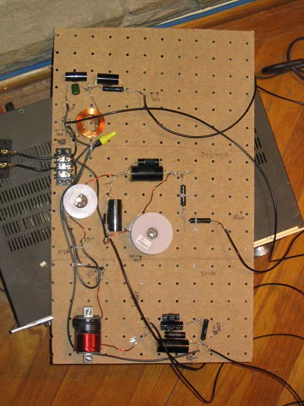

I can't wait for this stuff to arrive so I can start building. Any tips on how to best parallel the caps? I could just tie together the leads, but I'm thinking I could use a terminal strip to connect them together. I think in one case, I will need to parallel four caps, so it may get messy if I don't have a plan.

Alright! Thanks for all the advice. My parts should arrive tomorrow and I suppose I'll start building the crossovers.... tomorrow.
Thanks again-- I'll post pictures either when they're finished or when I frog it up so bad and I freak so far out with anger that I need someone to look into the madness in my eyes and feel my murderous rage as I slowly descend into the Void of Anguish to be consumed by the All Cleansing Fire of Rage at which point I will be reborn into a metalloid inductor-charged speaker-like being who will wreak havoc on his tormentors, bringing unto them their ultimate death, resting only to conjure beings of similar ilk but with different wire gauges and DCR ratings who will wrest from the world any remaining traces of the Holy and the Just so that all of our kind may live in a world of Chaos and Ruin WITHOUT ANY SPEAKERS.

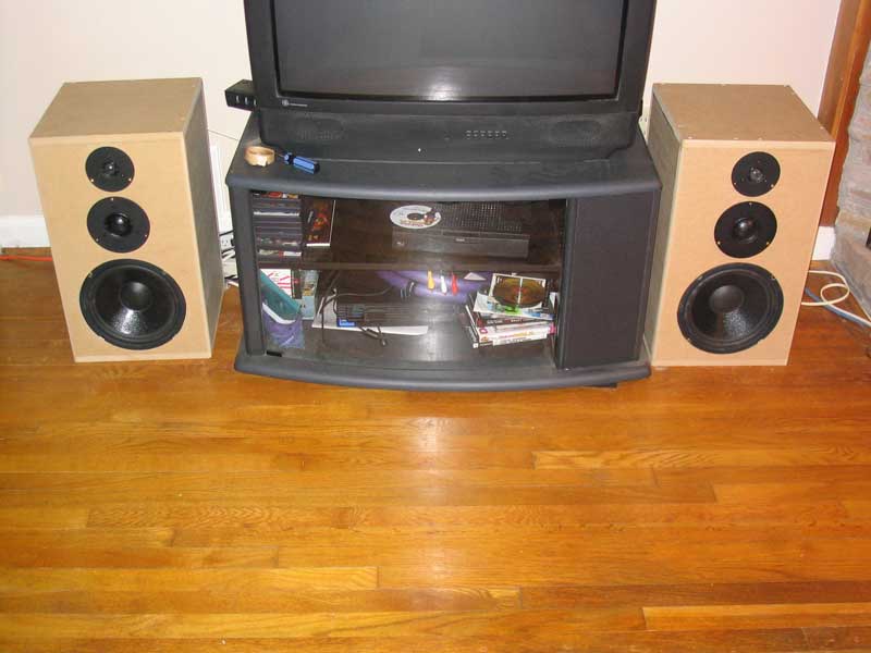

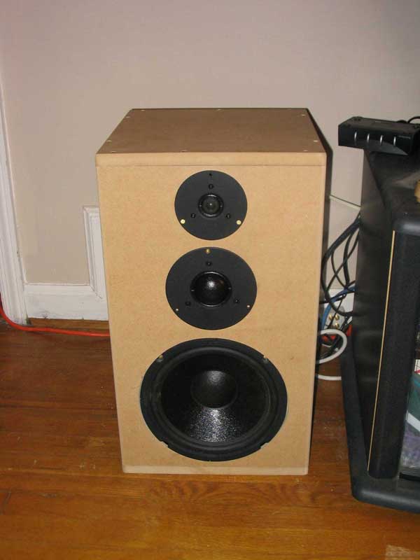

Project 90% complete-- I still have to put the gaskets and the final screws in the speakers, but its up and working and it sounds great.
I got a little sawdust in the silk dome for the tweeter and maybe its my imagination but I think that tweeter is buzzing a little. Is there any way to clean this or will I be buying a new tweeter?
Anyway, here's the proof that I DIYed this weekend:
