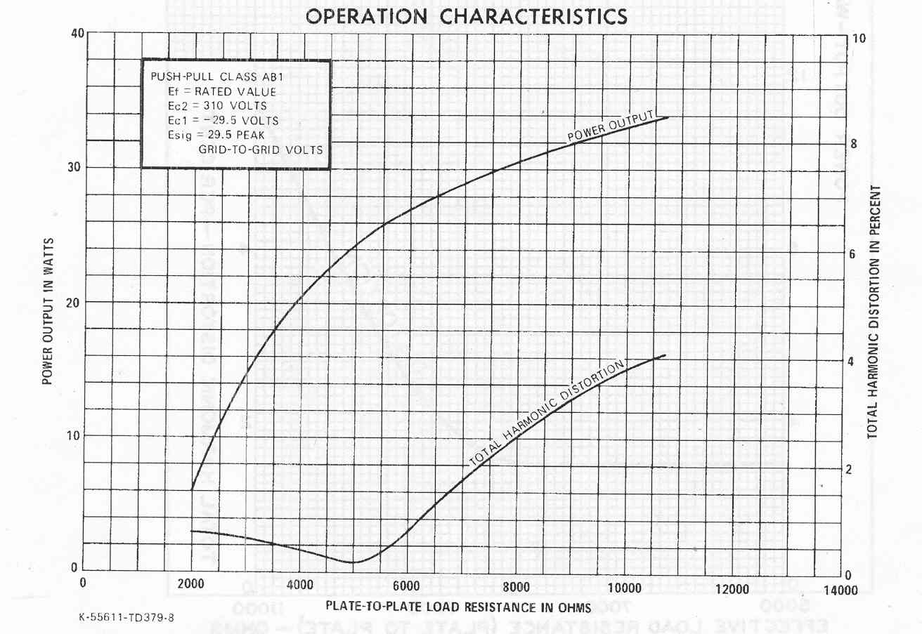

I just checked the GE datasheet for 6550A and it has a more typical distortion versus loading curve for P-P class AB.
Some ramping to the left side still, due to gm variation with current. But since the 2nd Harmonic (seen in the SE curve) is missing (cancelled out), only odd harmonic components are left in. The ramping on the right side is the usual odd harmonics from screen grid current becoming significant at high Z load.
The optimum low dist. point around 5000 Ohm might involve some odd harmonic cancellation between the variable gm mechanism and the screen current mechanism. Otherwise, I don't think the null point would be so sharp. (no reason to expect gm variation would just end at 5500 Ohms as it appears)

Pic 2 is a comparison of 6JB5 versus 6V6 plate curves. Both tubes have the same nominal specs on paper. But definitely not the same curve shapes. Would be interesting to see if the square knee'd 6JB5 reduces some of the odd harmonic dist. at high Z load. But no loading curves are given for either. The 6V6 curves still look like there would be a smooth gm variation for a very specific Zload line, it just has to cut through the plate curve slopes in the optimum place and maybe stay above 75V. I would guess the 6V6 has a narrower optimum Zload distortion null than the 6JB5.

Referring to the left-most graph in post #22 (Smoking-amp), one finds a minimum in total distortion at about 5K load. But one must remember that the graph is for distortion percentage. This is normally taken just before overload. Thus, bringing the rapidly falling graph for maximum output into the mix as the fraction denominator, the actual signal distortion 'produced' does fall as well, just not so fast as the maximum power output.
Measured distortion at a lower constant output level, somewhat below the maximum available level, will show a different tendency, which will be falling all the time, and this is where listening normally takes place.
Just to make matters nice and easy!
"Thus, bringing the rapidly falling graph for maximum output into the mix as the fraction denominator, the actual signal distortion 'produced' does fall as well, just not so fast as the maximum power output."
Good point Johan. We do need a full 3-D graph to really see what goes on there.
And higher odd harmonics would have a faster decay with lower demanded power output typically. And then, at some level, there is the class A region in class AB as well. Presumably these tube distortion graphs are for the output stage only and with some optimal class AB idle current. When the front end and N Fdbk are included, hopefully all this distortion falls below the threshold of hearing. I guess for those who really want to check, there are the FFT programs with a sound card to find out what the amp actually does.

On that post #22 graph of distortion (left pic) for the 6550A tube that Johan commented on. I just noticed that the input signal is kept the same for all loading impedances. So no wonder the power output drops like a brick at lower Zload!
I was assuming the drive signal would be increased for lower Zload to keep power up some. Only increased drive signal would cause increased non-linear gm distortion, which I had been commenting on. So Johan's comment about the denominator ruling things is 100% correct in explaining the ramping distortion on the left side of that (rather mis-leading) graph.
I think someone connecting a speaker to a too low Z tapping would increase the volume control to do a sound comparison with the correct tapping. Which would cause increased non-linear gm distortion (more of the gm curve being used).
I guess the tube data graphs don't show case that however.
That is true for nearly all the old data.
Which is why I commented that it needs interpretation.
In Real Life, we would adjust the drive as appropriate. As has been said, the THD will not rise as fast, but the Watts for a consistent THD would fall off more.
I still do not think it is "critical". 2:1 taps will get as close as you can need, if you have more-than-enough Power. If you are under-powered, you will always be on the edge of unhappiness.
