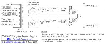

A typical power amp PSU is unregulated - just transformer, bridge rectifier, capacitors. Typically a lot of capacitance for instantaneous current demands. It's also symmetrical. For a 100W amp you are looking at +/- 55V supplies, at least 300VA transformer, probably at least 10,000uF capacitor per rail.

The differences, in theory, are minimal. The main issue is scale. Your rails will be much higher than for a typical hobby bench supply. The currents involved can run into tens of amperes when looking at charging currents and ripple currents. Mercifully we typically DO NOT use active regulation for amplifier designs, so at least you aren't tasked with creating a high voltage / high current regulator (x2 rails no less). Things like grounding become critical and must be considered with care to avoid loops and injecting noise from large current pulses into the audio path.
The schematic for a basic audio PSU will look quite simple. The devil will be in the details of its layout and execution.
