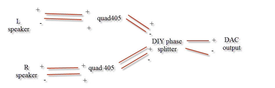

hopefully this is a better description. I have 2 quad 405 amps - each one which is connected to a single speaker. The wires from each speaker are connected to the two positive poles on the output of each amp. So the negative speaker outputs are ignored.
From the speaker's point of view - the + output for the left channel pushes while the + for the right channel pulls. From my stand alone phase splitter point of view - it sends the same signal albeit 180 degrees out of phase to the Quad 405 input for the left channel and to the right channel respectively.
As I understand it - this changes things impedance wise for the speakers but does deliver 2x power (or 4x in wattage terms). Whatever the technicality - this does suit these speakers which were well known to respond better to their rated 200w/ch than to a mere 100w/ch as delivered by a standard single Quad 405. The difference is quite clear even at low listening volumes.
The contraption I build does deliver a large improvement in sound quality but it makes sense on a number of levels that this primitive and now probably miswired thing should be replaced with something better
hope that helps -thanks for replying

OK... hmmm
So it is just a simple phase splitter you have. For several reasons I'm not convinced that the Quads are a good candidate for "bridging" as its called... however

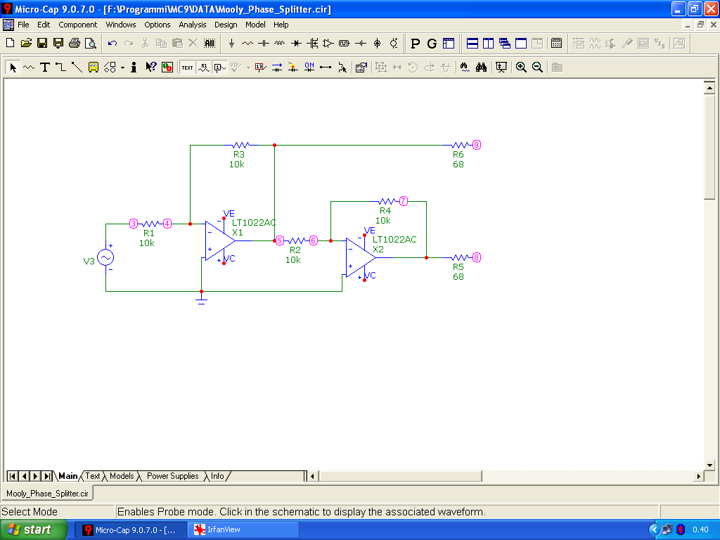

Here is an opamp based splitter. You could use something like the LM4562 or OPA2314 which are dual opamps and power these from the existing opamp already in use in the Quad. So its one dual opamp and 6 resistors. The picture shows the two outputs and the exact 180 degree shift. Using opamps and the split is perfect.

Going back to the circuit. Yes, that's all you need to make a perfect splitter. Refinements might include AC coupling the inputs. You would also be advised to add a decoupling cap across the opamps power supply pins close to the opamp. Something like a 10uf63v cap would be perfect.

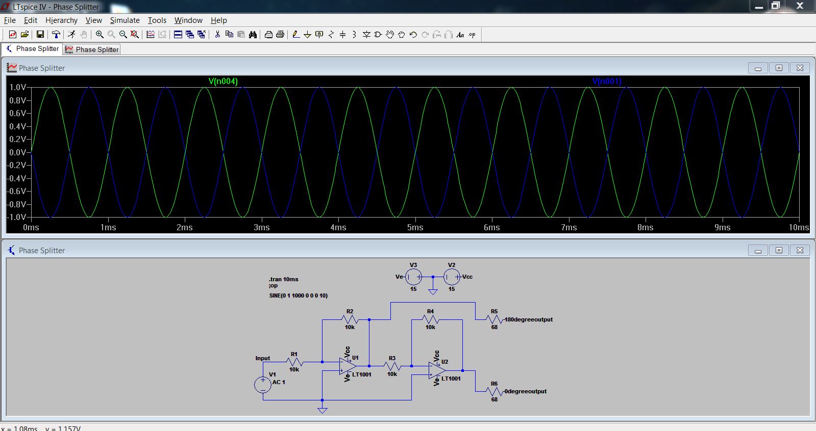

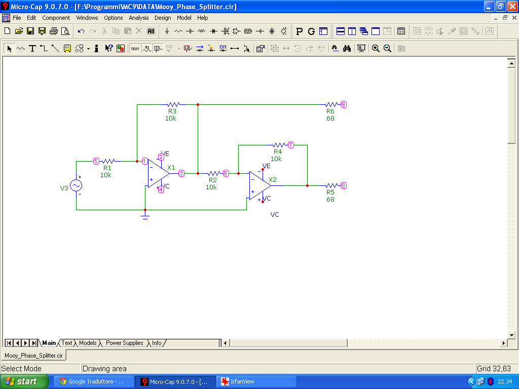

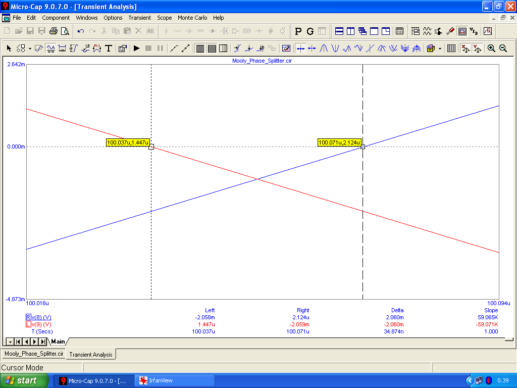

Mooly, the phase splitter circuit you posted has the serious defect that the two signals are not exactly synchronous.
The percentage error in time between the two signals is greater when the signal itself rising in frequency.
But just at the 1 KHz of your example you may notice the delay of one signal with respect to the other.

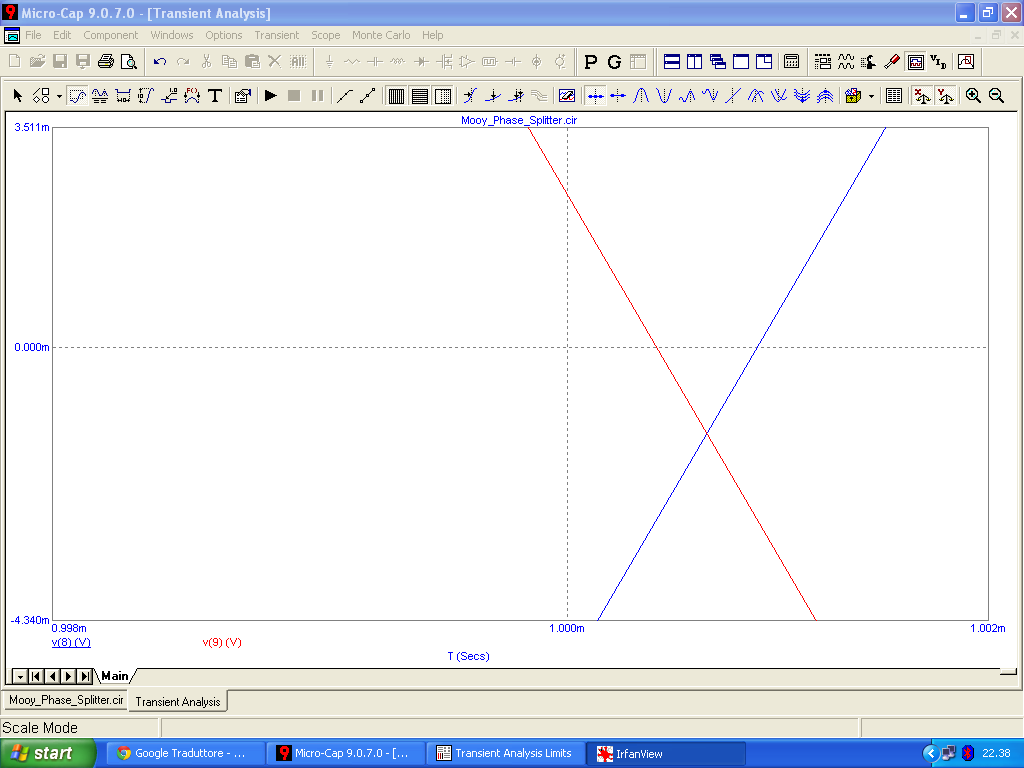

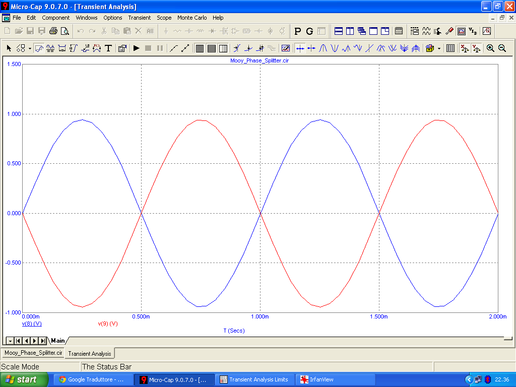

I have done simulations with microcap of your circuit and I attach the waveforms of the two output signals in phase opposition.
To highlight what I'm saying here is need a greater resolution for which in the first image I posted the transient analisys for two whole periods and in the second image I made a zoom in the point of zero crossing after one period.
It's evident how the output signal from node 8 (in blue) is delayed with respect to the output signal on node 9 (in red). Can you immagine what happen with an input signal of 10 or 100 KHz?
Francesco
Hi Francesco and thanks for the observations
What OpAmp did you use for your simulation ?

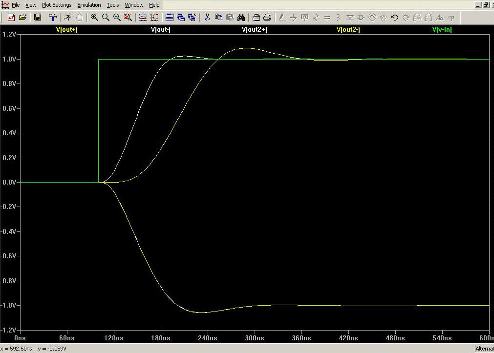

Yes, its true that passing a signal through any amplifier of finite bandwidth delays the signal (and here we have one opamp for one phase and two for the other).
The opamp I used to illustrate the circuit was little more than a 741. Use a higher speed device and the effect diminishes rapidly such as here where I'm using a more representative LT1022 (8.5gbw and 26v/us). I would recommend something like an LM4562 for a real build.
Is such an effect audible anyway ? The difference at hf with a good (fast) opamp is I would imagine is less than the effect of moving a speaker a few millimetres in position.

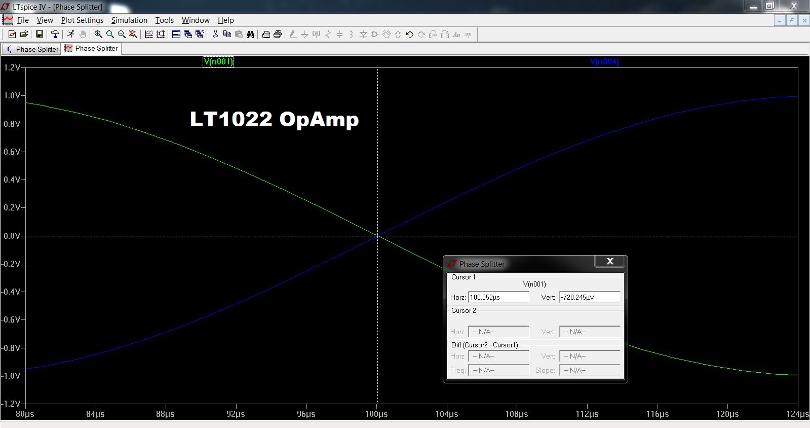

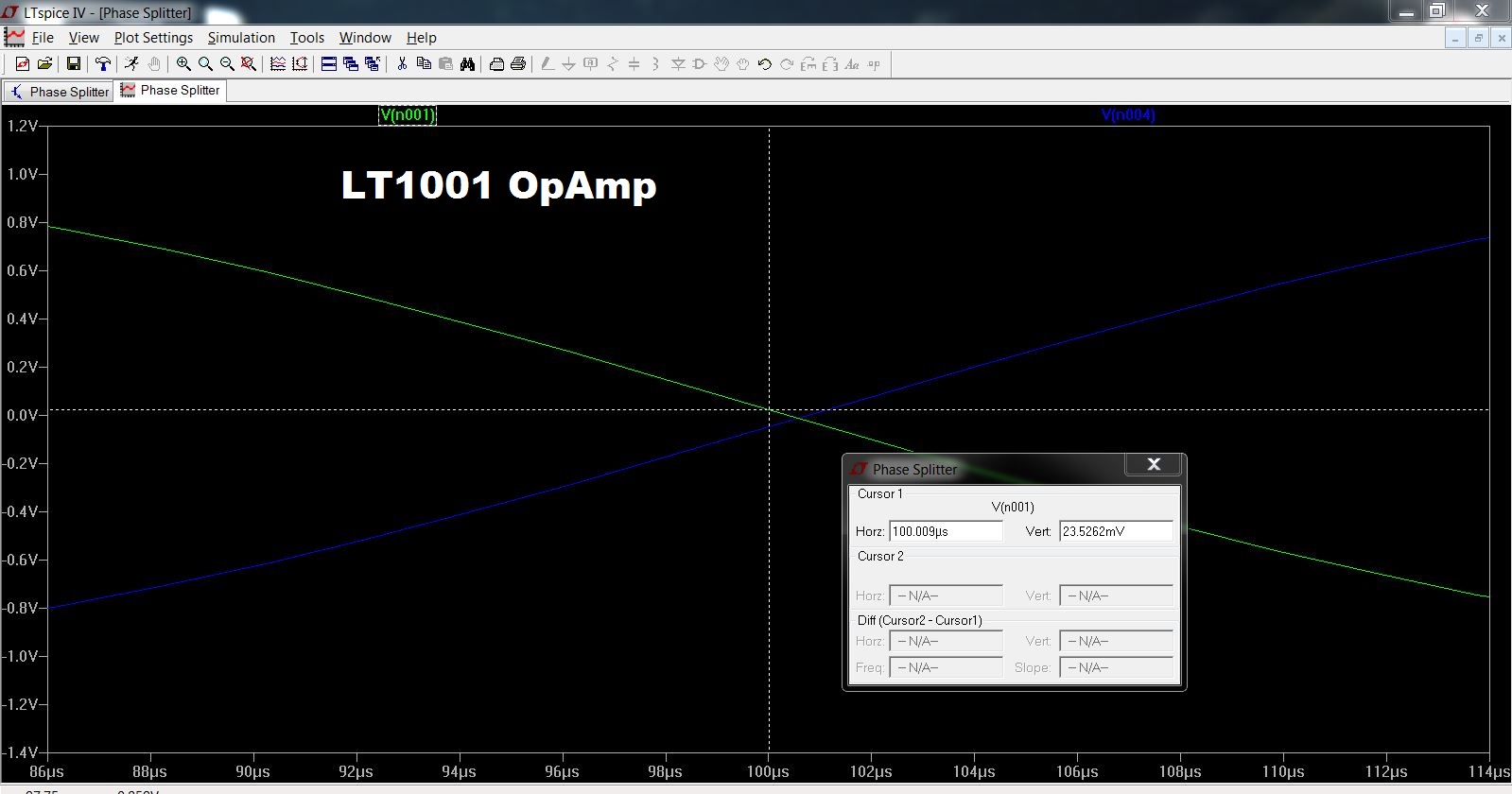

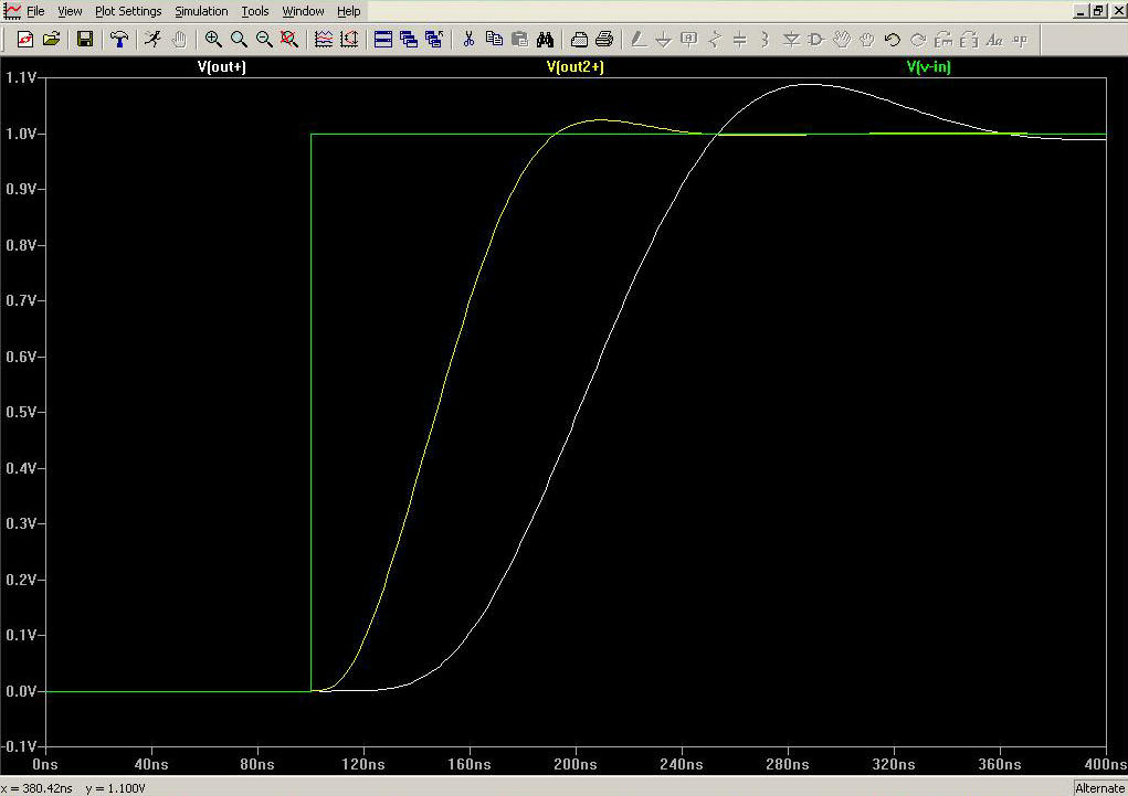

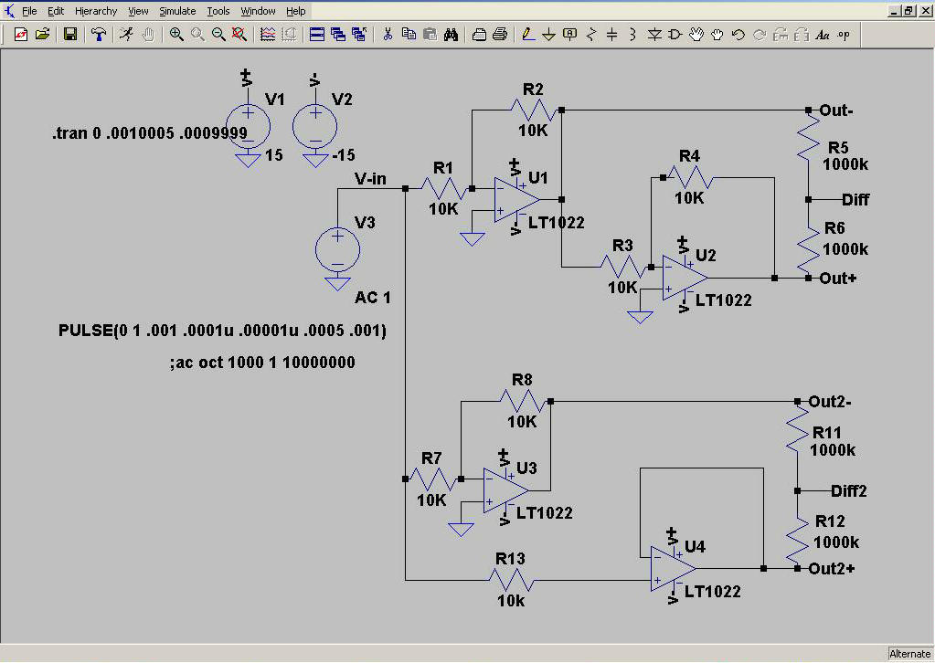

Here is the LT1022 now at 10kHz vs the slower LT1001
Edit If gav is wondering why I'm using LTxxxx devices in the simulation and recommending others to use for real its just because the LT devices are included standard parts with the simulation package.

I have used LT1001 as you.
With LT1022 things are much better, although still remains a small delay of about 35 nsec between the two signals as per attached picture.
To achieve a good phase splitter is very difficult and in fact this stage is generally the most critical, but by it largely depends the quality of an amplifier .
If the two signals are delayed relative to one another, we will lose accuracy in the output signal from the amplifier , then a loss of definition, of detail, of small environmental information and poor focus.
I have not checked instrumentally , but I hypothesize that this delay can also create a distortion similar to the cross-over distortion in class AB ouput stage, with the aggravating circumstance that it is not curable even by a relatively high bias .

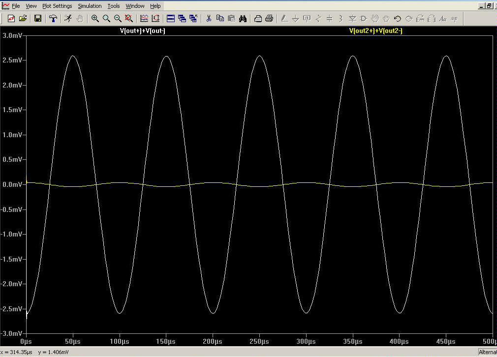

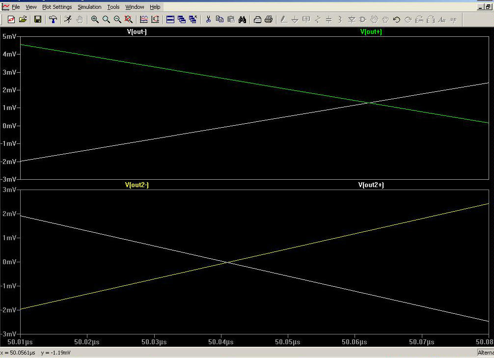

If you use one op-amp to buffer your input signal and one to invert you can eliminate the delay difference between the inverting and non-inverting outputs. (Vout=original, Vout2=Improved)
Schematic, Pulse response, Output difference at 10Khz, Easier to see pulse.
