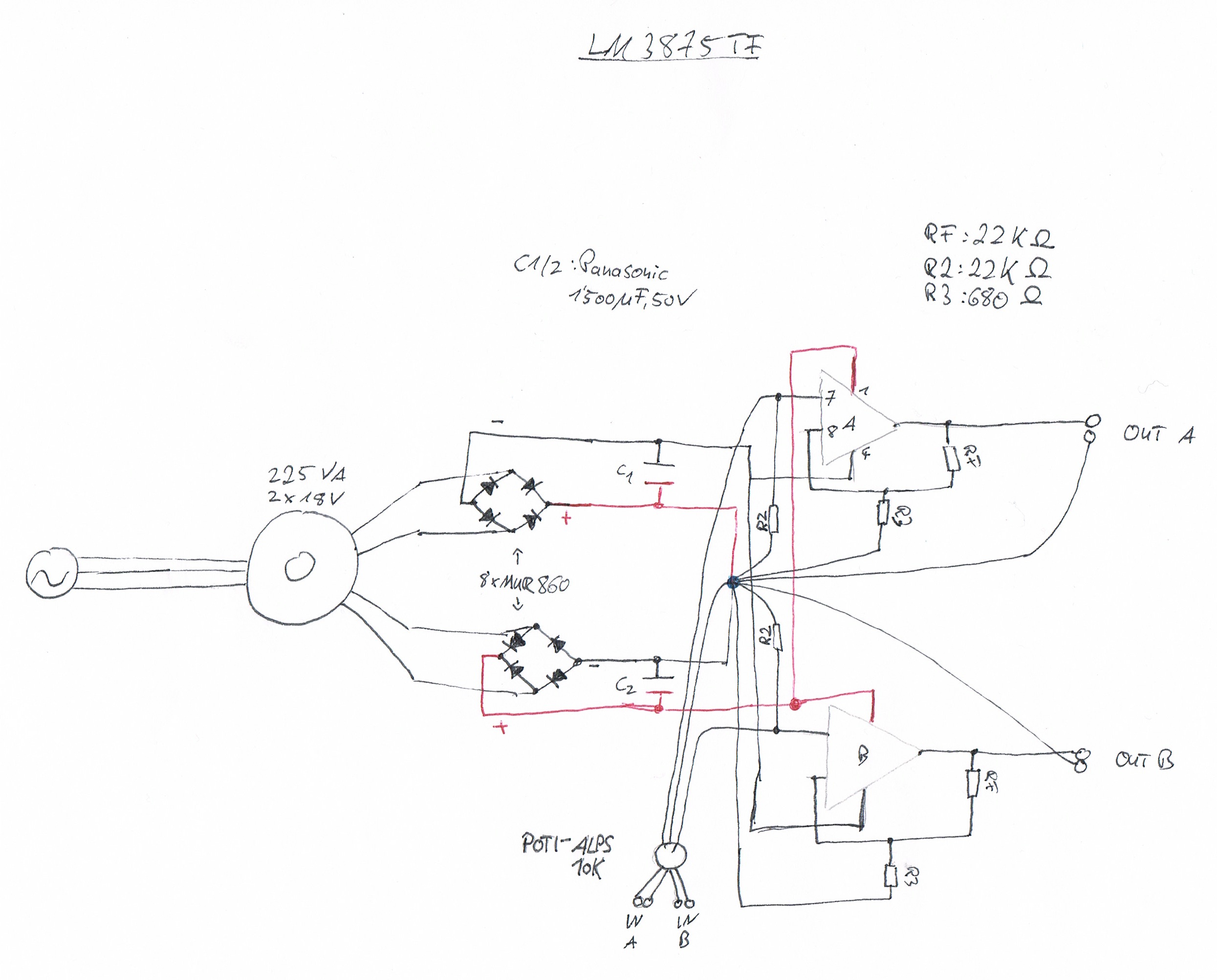

I am new to DIY Audio or in fact DIY electronics. Nevertheless, I want to build a ChipAmp using the LM3875TF Amps. Since I couldn't get hold of an PCB in Switzerland - and because it should be more fun - I decided to go either on stripboard or P2P.
I looked at the schematic on the data sheet of the chip and, mainly, to the instructions given by audiosector for their kit.
Based on that, I came up with the attached schematic. Now I would be really really grateful if someone more experienced could have a look at that. I am wondering whether having one place where all the different grounds go together (star ground?; signal and power ground?) is correct.
I also could not get hold of Caddock MK132. I have a carbon resistor (Yageo), 1/4 W, 5% or a metal foil (Royalohm) 1/4 W as possible replacements. One of these any good?
Thanks-
Benjamin
Use power supply bypass capacitors on pins 1 and 4, 10uF//0.1uF on each, mounted close to the IC.
Also you need a 22uF (or more) capacitor in the nfb loop between R3 and ground, to minimize DC offset.
See the data sheet for details. http://www.ti.com/lit/ds/symlink/lm3875.pdf
Point to point can be good if carefully done, but a single "star ground" is not really the best method.
That's too long a discussion for here, though. Use high quality resistors (Dale RN65C, etc.) for the nfb loop.

If you want any hope of reproducing the performance listed in the data sheet for the LM3875, you need to have a low-impedance (low resistance, low inductance) connection from the quiet signal ground to the ground terminal on the output connector. This means short, wide connections from R3 to the output ground and from the pot and input connectors to the output ground.
Using a star ground like you've shown greatly increases the inductance of the signal ground and causes a rather dramatic rise in THD beyond a few hundred Hz. I've posted a bunch of data in this thread: http://www.diyaudio.com/forums/chip-amps/252436-lm3886-pcb-vs-point-point-data-3.html#post3846783

I'm not sure I fully understand your question. The bypass capacitors are important for stability. National/TI recommends 470 uF + 100 nF ceramic in the data sheet. I go as far as recommending a larger electrolytic can (1000 uF), a smaller electrolytic can (22 uF), and the largest X7R dielectric ceramic cap you can get your hands on that'll survive the supply voltage. I go through my reasoning on the Taming the LM3886 - Supply Decoupling page.
The cap in the feedback network and input ground should go to the quiet signal ground. The decoupling caps, power supply ground, and ground pin on the LM38xx should go to the power ground. The power ground and quiet signal ground should both be low impedance (as wide as possible --> ground planes/pours) and connect at one spot only: the ground connection at the output connector.
It's the output voltage we're trying to control here. Therefore, the output ground is uses as a reference point. Keeping the grounds low impedance (= low resistance and low inductance --> ground planes/pours) ensures that as little voltage develops across the ground planes as possible.

Building a circuit according to the instructions first is always a good starting point. You can easily verify the impact of your modifications - or test my claims - by measuring the THD using a sound card and some software. Watch the THD vs frequency curve as you move the various grounds around.

So I read the data sheet and tried to implement your advise, Tom:
Tom
I have attached the new schematic.
There are some things I would like to clarify: in most cases where I saw those big caps (+1000 uF), people installed 4 of them - two on each rail. Now I have only one cap per type (1500 uF, 22 uF, 10 uF) per rail. Is that ok??
The small cap (10 uF) is an X7R, 50V (SMD) by the way.
The other question is: Should I add the resistor Rb 1K Ohm between Input and IC?
Thank you!
