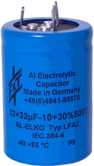

these ones have 3 terminals
are they like this? if they are, they are "two capacitors in one" they often use them in tube amps.

the terminals are spaced at 1.5 cm. i have looked at the mouser and mundorf websites but havent found anything yet.

Can you post picture of that special cap? as we mention before, 6800uf 50v are everywhere.I do not see what is the problem if is just 6800uf 50v. or are you looking for the same one? these days capacitors with that capacitance come smaller than years ago.
