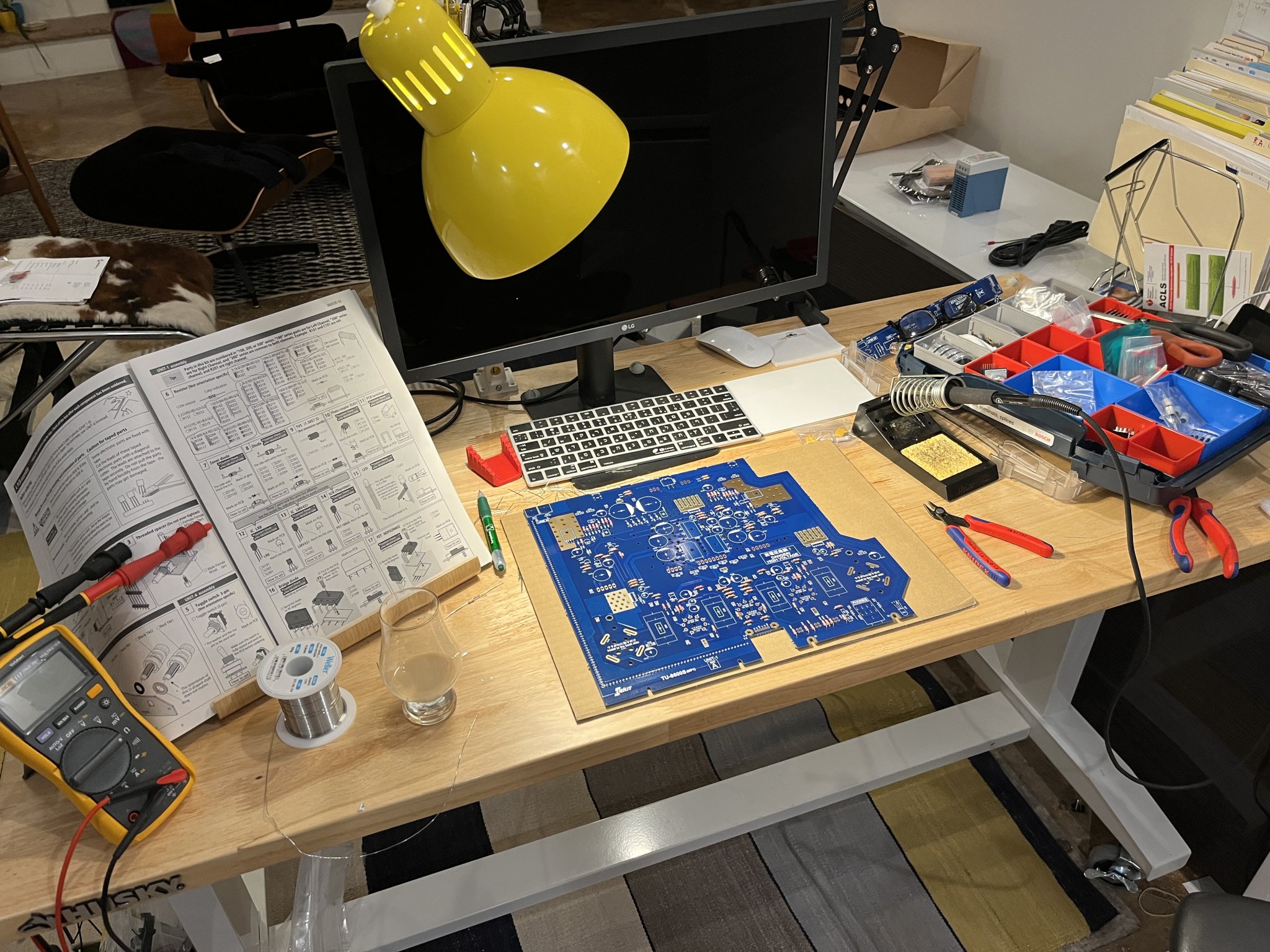

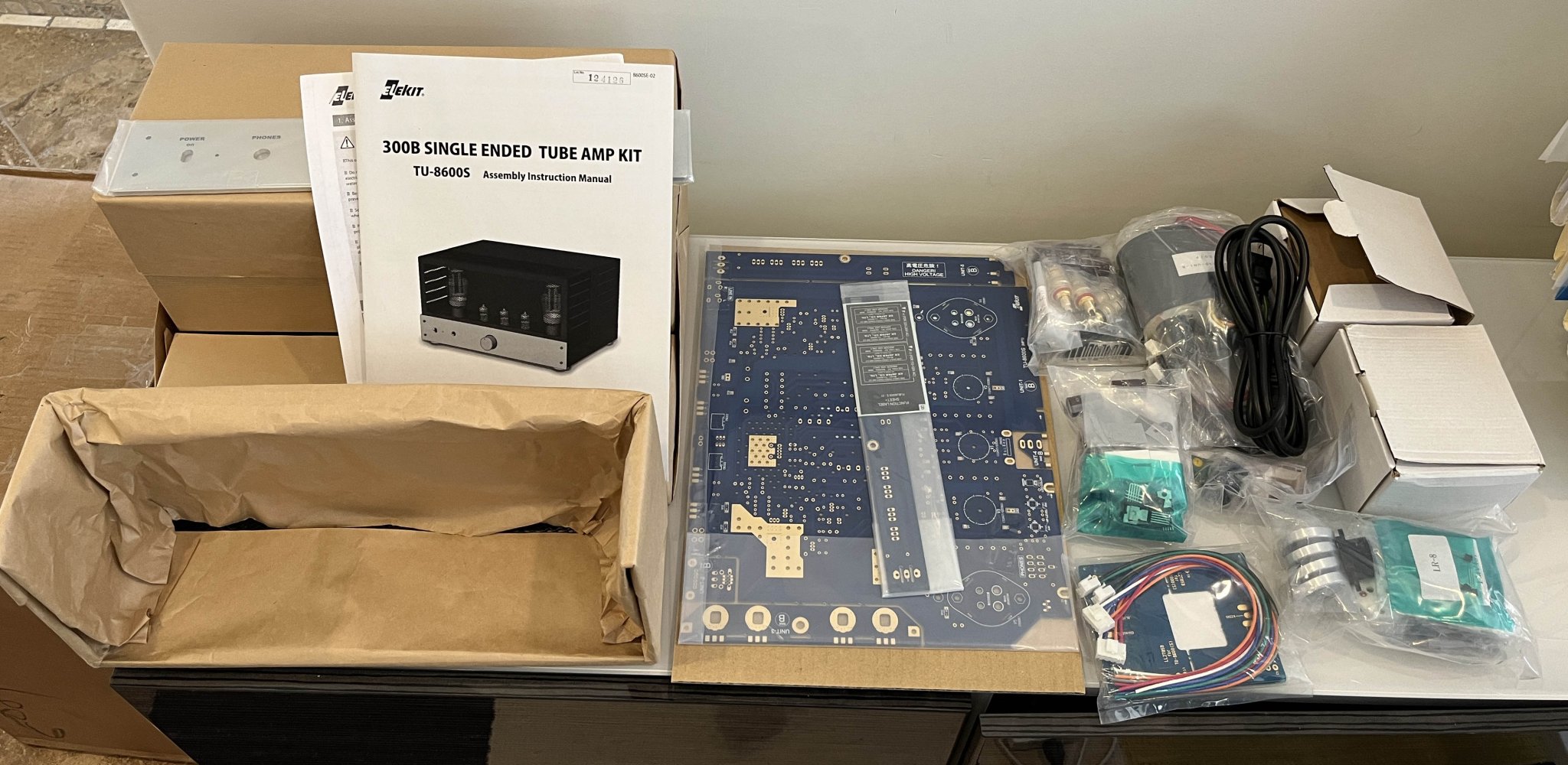

I am a newbie to audiophile stuff and have received my Tu-8600S kit today so will document here the journey of assembling it. Will no doubt have lots of questions, and looking at you all for help.
After an initial UPS hiccup yesterday the package was delivered this morning and it is very well packed -- triple packed actually. I read the manual and now am sorting the parts.
Joined 2023

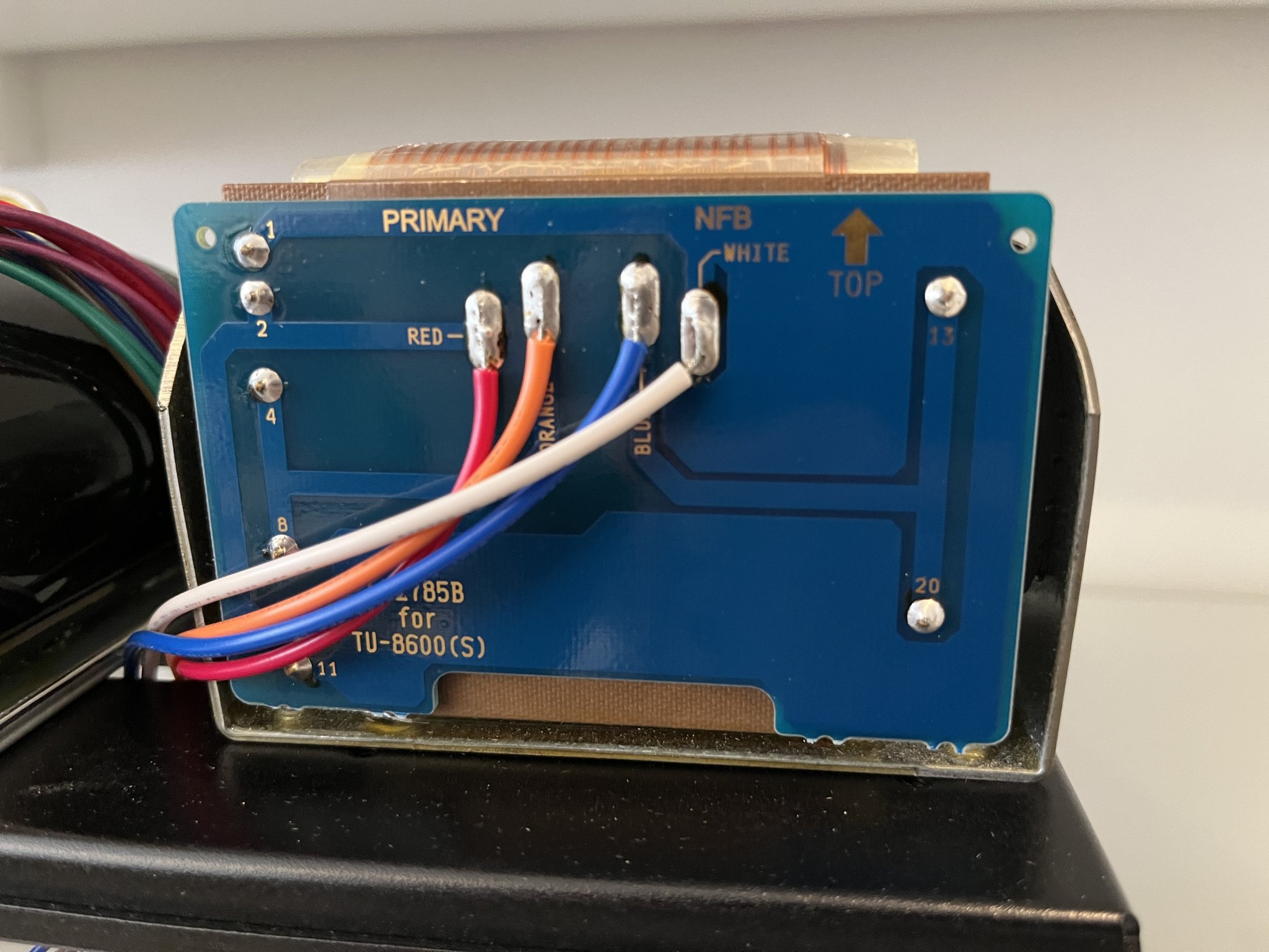

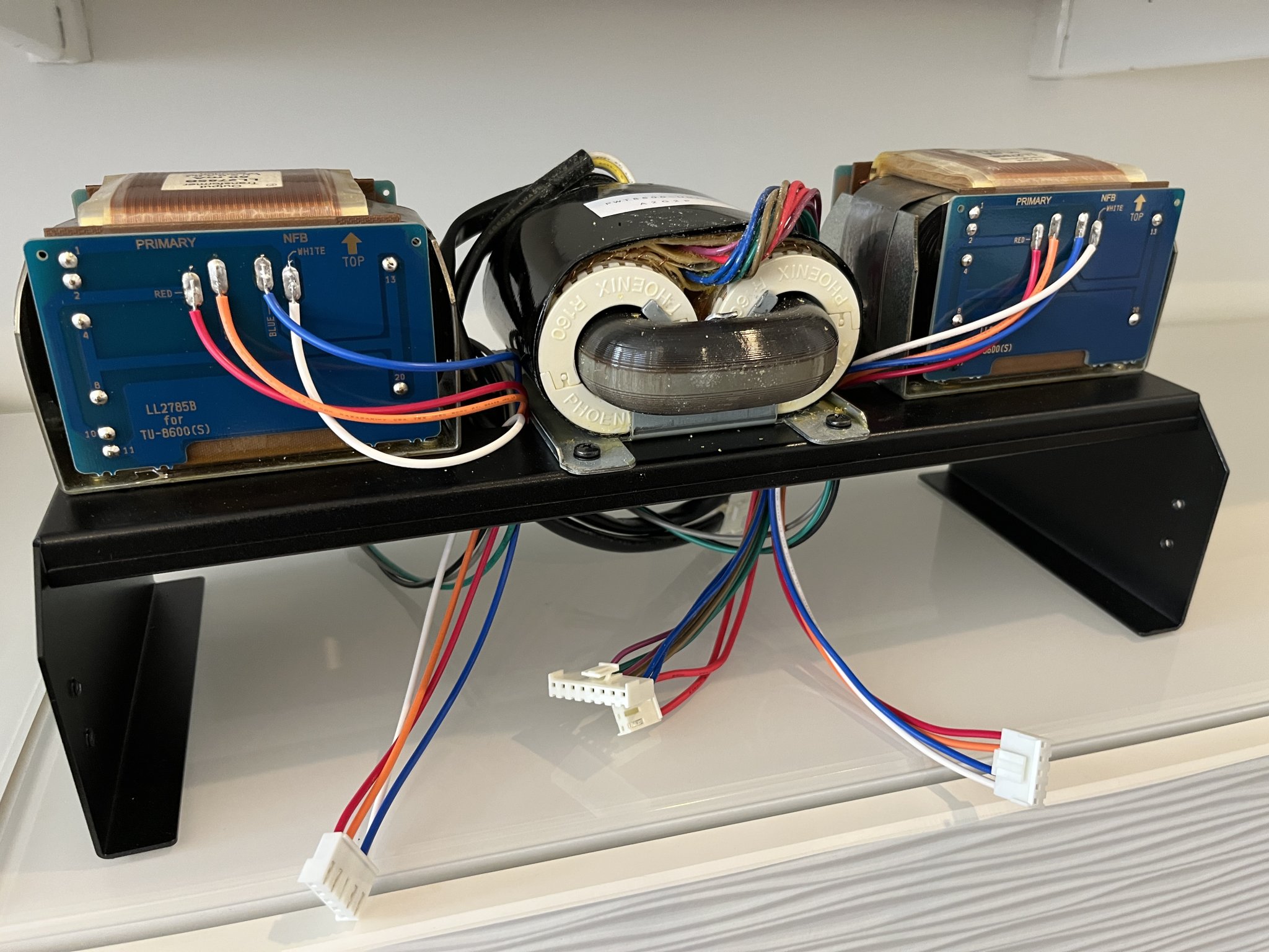

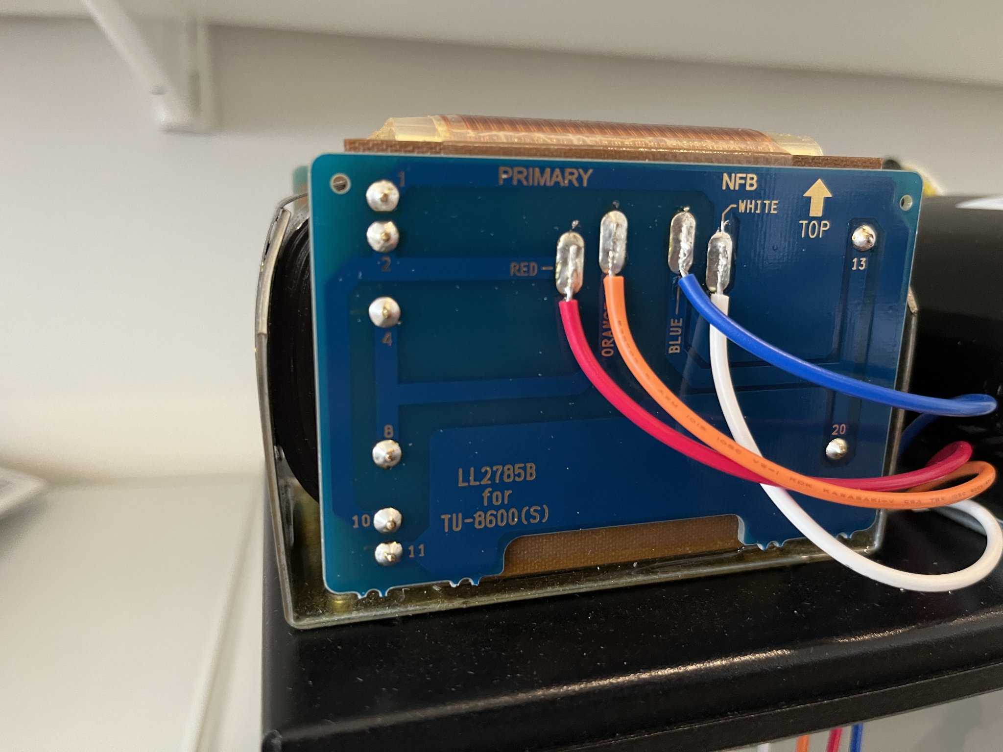

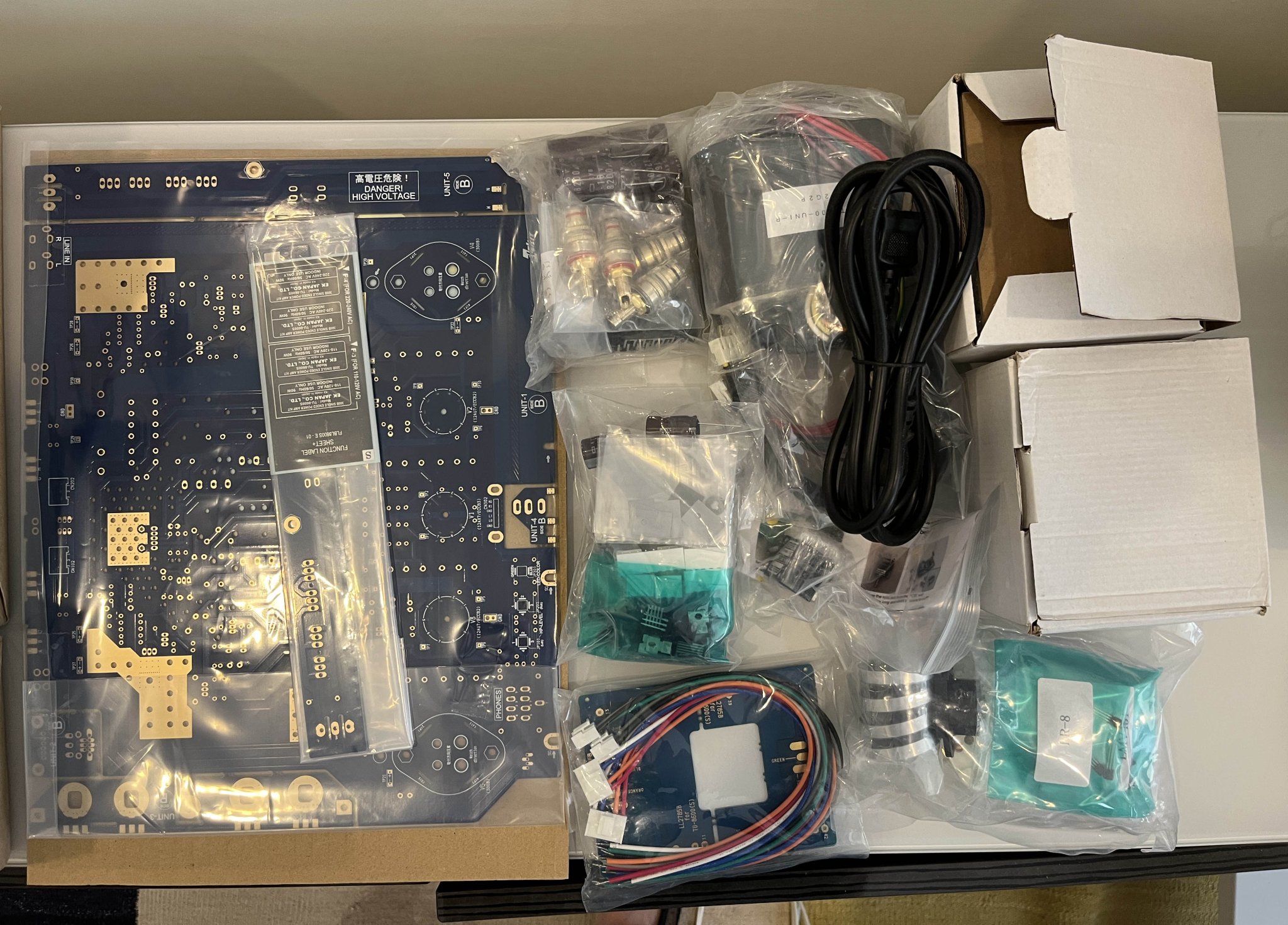

The kit is triple boxed. In this photo the outside box is barely visible on the right and left edges, with its flaps folded over. Shown are the sturdy middle and inner boxes.
This is the entire content.
Everything is very nicely packaged, the Lundahl transformers are in the white boxes at the right.

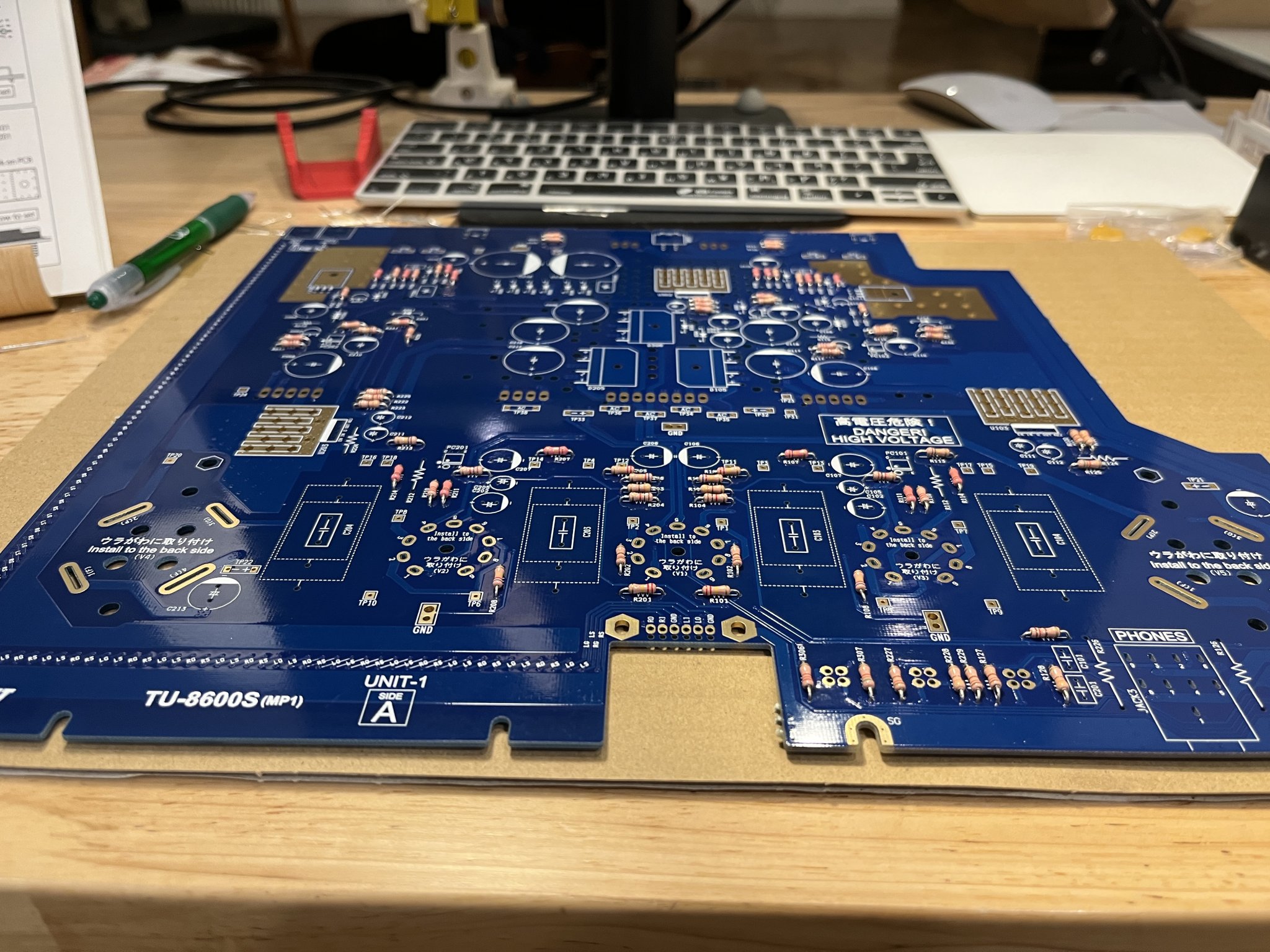

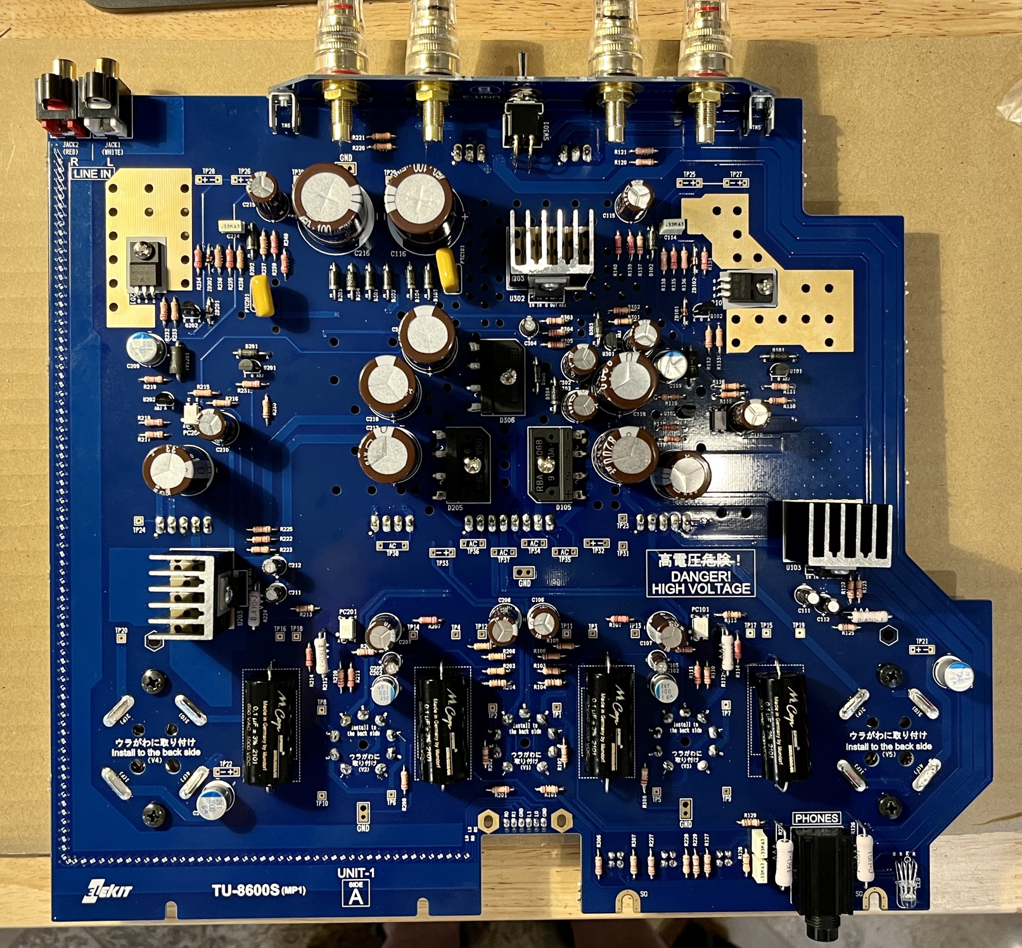

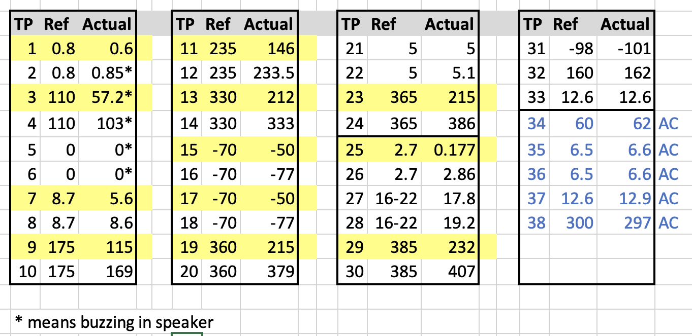

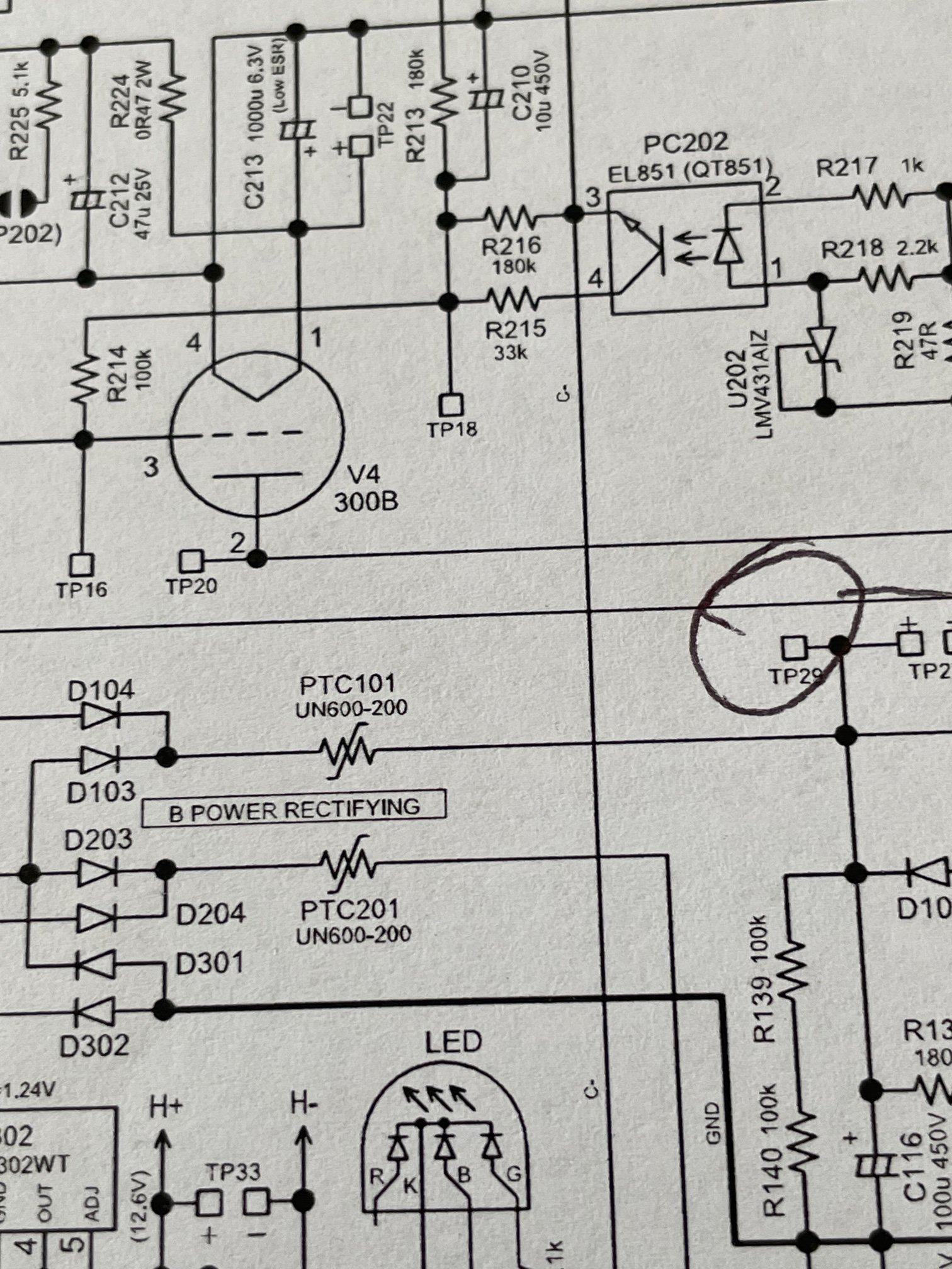

So I finished assembling the amp, and have several questions.
1. The measurements on one side are all off:
2. The tubes do not glow.
3. As noted in the measurements above, the speakers (brand new Klipsch Heresy IV) buzz when certain test points are touched.
When I first observed this, I stopped the system, disassembled it, and re-checked the PCB Unit-1. I did notice that component U-102 (LMV-431). was accidentally inserted reversed. So I desoldered it and reassembled it correctly. Not sure if it got burned up or not, can order a Texas Instruments replacement from Mouser. All other components appear installed correctly. I can take some quality photos of the PCB if that helps.

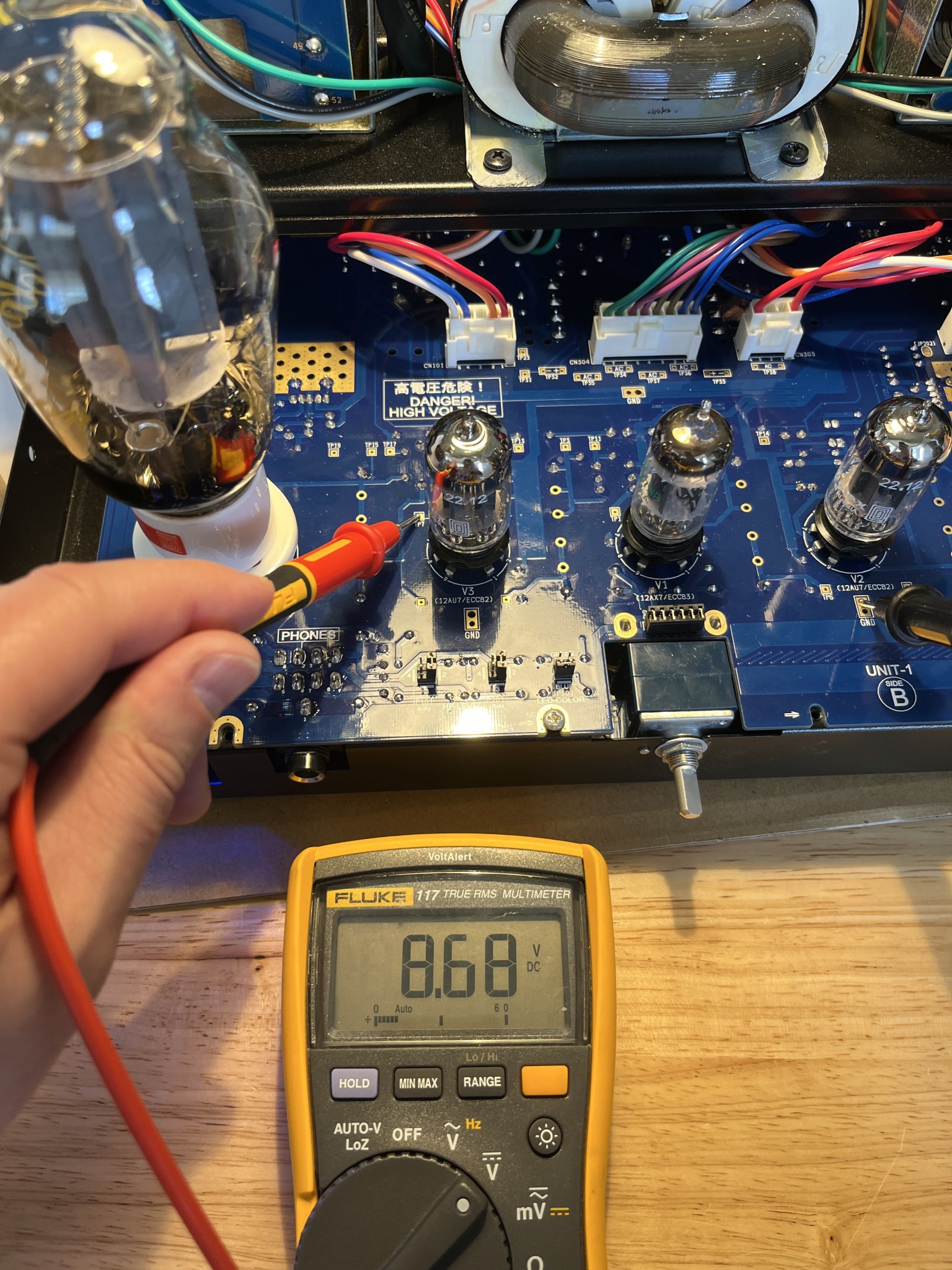

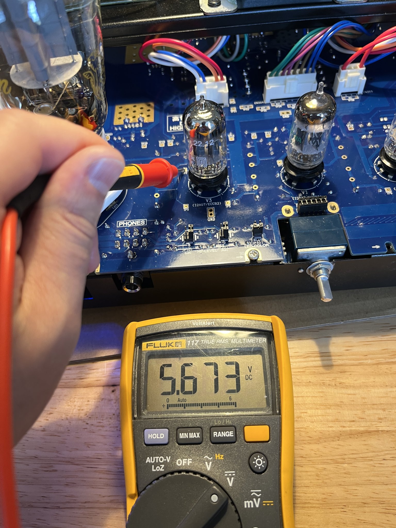

Immediately upon turning the system on, the voltages seem correct:
But then 2 minutes or so into the warm-up the voltages on the left side (odd-numbered test point) drop rapidly to what I measured warm.
I did swap the two ECC82 tubes but that does not make a difference in the sides.
Joined 2023

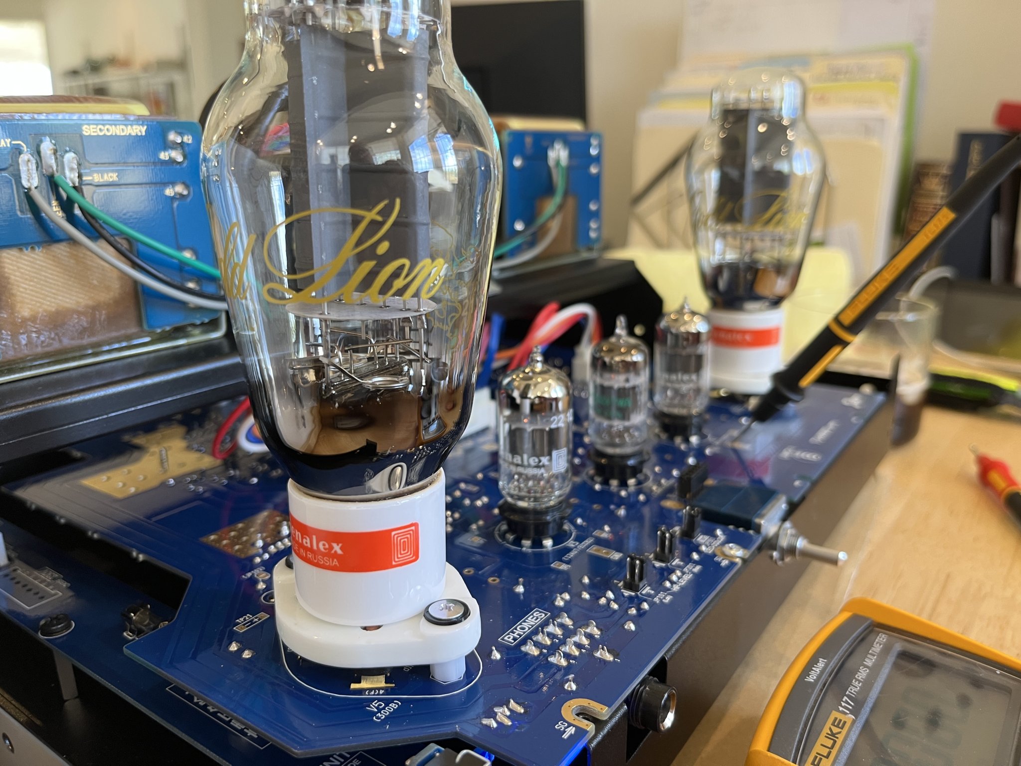

The 300B tubes seem oddly rotated, meaning the label faces left. I paid attention to thick pin going into the bigger hole. I don't mind the esthetics of it but thought I mention it for completeness. The tubes are otherwise well seated. YOu can also see that they do not glow, 10 minutes into operation.
Joined 2023

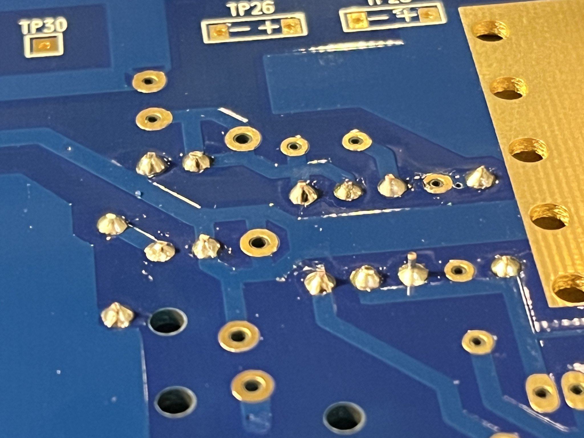

Results so far:
1. Immediately after turning on, all voltages are good.
2. If tubes are cold, voltages drop on the LEFT CHANNEL ONLY to values shown above after 3:30min.
3. If tubes have not cooled down to room temperature, voltages drop after 1-2 min depending on residual heat in tubes.
4. Swapping 300B tubes side-to-side does not make a difference.
5. Swapping ECC82 tubes side by side does not make a difference.
6. Removing the shared center tube ECC 83 does not make a difference.
7. I unsoldered U102 and U202 (LMV431) and swapped side-to-side. No difference. This test was justified by the fact that originally U102 was inserted wrong and I wondered if it is damaged. It likely isn't as the swap makes no difference.
8. I unsoldered PTC 101 and PTC 201 and swapped side-to-side. No difference.
Something happens after tube warmup that drops the voltage of the L channel but the tubes themselves, and the components above are not the culprits.
Any thoughts of what to look next? D103/104 swapped to the left?
Hopefully will be talking to Victor later today but curious if anyone has any suggestion.
Joined 2023
Ok, Victor @vkung you were spot on with your advice on the phone: I checked carefully the left channel components and one of the resistors was poorly soldered on. After I resoldered it, the system shows the correct voltages, balanced between right and left.
