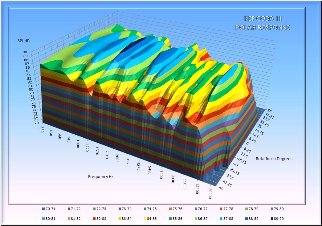

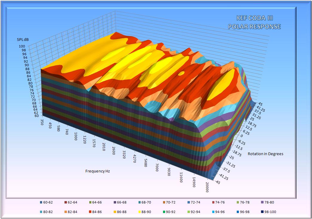

Inspired by Earl's graphics I decided to see if those of us who don't have access to expensive softare could format up data in excel to present polar responses in a more meaningful way.
Below are my current graphs. I will not pretend it is easy to creat these but it is possible.
So what does the graph tell us, well probably that the CODA III was not KEF's finest hour;

This is great, I'd love to see a standard format and if it is Excel all the better. BUt it does need to be setup as a standrd excel file so that all I need to do is import the data and the plots appear. Otherwise it won;t be viable. Can you just post an excel file that does this and we can import our own data?
Honestly, I think that the data that you are showing is rather typical. It shows how much more of the problem are apparent in this kind of data presentation. The myruad of resonances that affect the axial as well as the off-axis response will created a colored sound as both the direct field and the everbe field will display the same peaks and dips.

Here is my proposed standard please comment if you think it should be different.
17 data sets for the polar responses at:-
-45 -41.25 -37.5 -31.25 -25 -18.75 -12.5 -6.25 0 6.25 12.5 18.75 25 31.25 37.5 41.25 45
Each data set to contain 200 points (Arbitary decision).
My current data set is 84 points but it is a bit rough so this is a compromise between time to manipulate the data and smoothness. If there is a standard data set size I am happy to change to it. (It cannot be changed on the fly as it will mess up the axis labels)
Data to be in SPL. (70dB to 100dB)
I will set the range between 100dB and 70dB. It is fairly easy to re-size this range but the colours change and it is tedious to set them back to something that looks good. If the range can be smaller than this it would be better but I am thinking that with the range of efficiencies in speakers it will be required if we want all graphs on the same scale.
My current sheet takes relative data from Holm Acoustics and offsets it to creat the correct SPL level, however I suspect alot of people will have SPL data and you can get Holm Acoustics to do this before you export the data, I just forgot.
Frequceny steps: 200Hz to 20,000Hz in 200 log spaced readings
Frequency steps must be logarithmic as Excel will not convert to a logarithmic scale.
What do you think?
Is this a format that enough people will be able to create to make it worth while?

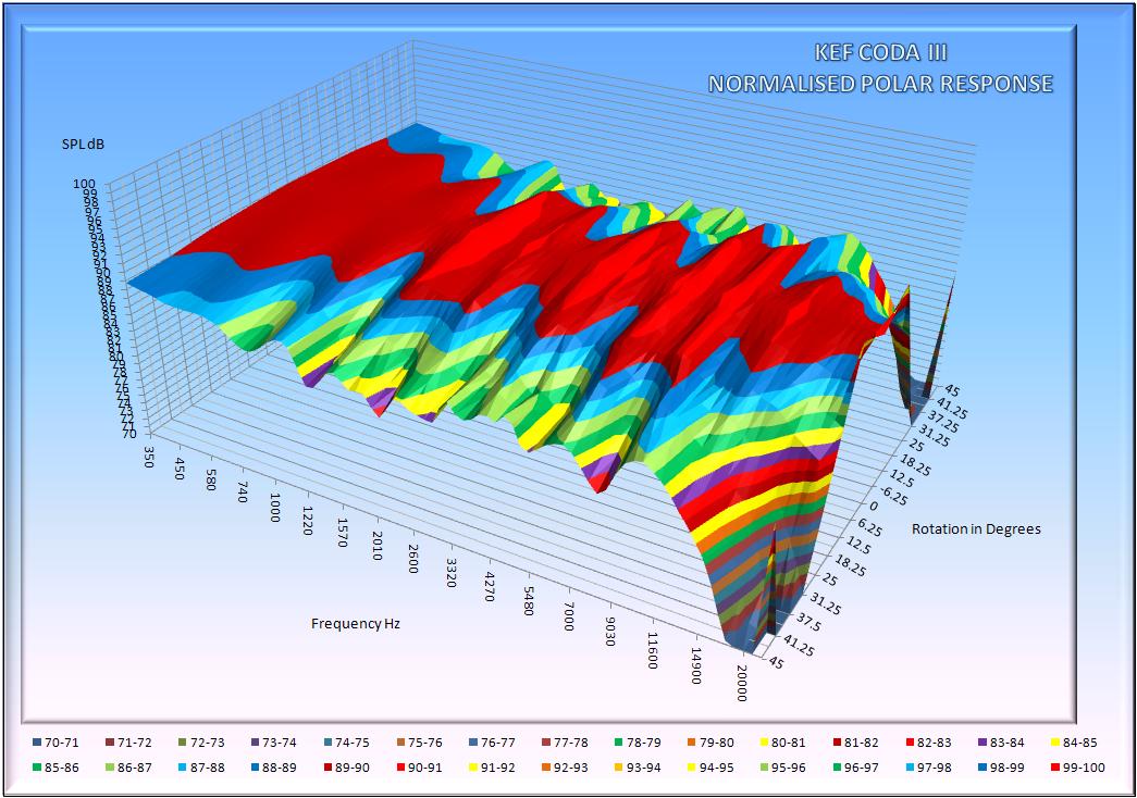

I have attached the normailsed data on a 70dB to 100dB scale to give an idea of what this would look like. Once the data is entered excel can easily creat the normalised and un normalised data and the contoured or flat views so all the graphs can be dispalyed. Note that the flat view is not completely flat it is the contoured data from almost directly above.

My 2 cents
I would like to see 5° or 7.5° increments, ±90°.
Should be based on the actual data input. Earl?
Range of 60dB
Log display for frequency is fine.
I find find the "block" 3D view more unambiguous:

I have found a way I think I can iterpolate the data from an arbitary data set size to always have 200 data points on the correct scale. Data input can then be linear or logarithmic. If you use linear data you will need alot or interpretation at the bottom end will be rubbish. Interpolation or fixed data set size will be required or the graph will need fetling each time you enter new data. The interpolation is linear no fancy cubic options I am afraid.
I can set up both 5 degree and 7.5 degree options eventualy but lets choose one or the other at the moment as this is now looking like it is going to take a long time to set up.
Excel is not very adaptable when using 3D graphs so the data input will all be required. 90 to 90 in 7.5 degrees is 24 data sets. Are you really all up for this much measurement? Every data set will have to be manually copied into the correct place in the table. I am not an excel genius like the guys at FRD so no fancy input screens.
I do not have a data set like this so if I am to creat this spread sheet someone will need to send me one as I don't feel the CODA merits that much measurement and my measurement system is not set up at the moment. I guess I could coble something together by duplicating data from teh CODA data set but it would be better to work with real data.
Range change is trivial but I don't think you will be able to read the legend with this large a range and the option is all range points displayed or none. (This seems to be a function of the way the contour system works as other graphs alow sparse points) I have changed the range to 60dB to 100dB but note to make this readable I have had to go to 2dB steps which means the colour bands are 2dB wide. (shown below)
If there is someone who is expert with excel out there and laughing at my poor graphing and data manipulation skills please feel free to step in. It took all of today to work out the graphs here, so I suspect it will take a very long time for me to work out a generalised solution. However I will have a go if people are interested.
