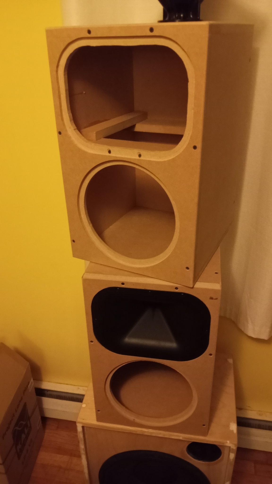

The measurements of the WG10 in post #13 look quite good, surprising low end pattern control, and uniform polar response, even outside it's nominal 70x60 rating.The Eminence has a taller vertical, so might hold lower. May not try to be so narrow to begin with which is harder to hold. Only guessing without measurements.
It's "70" is wider than a lot of so called "90" for the top octave.

no idea how they sound, I'm waiting on drivers to get here.

Idk yet, they're just boxes for now until I can swing the money for the drivers. I have other speakers with similar dispersion and I like them. I like narrow because my rooms generally don't have treatment for wide to sound good.
- new waveguide from Eminence WG10
