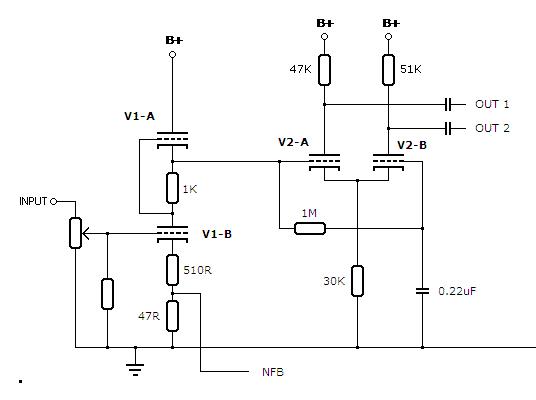

Don't understand. Newbee to tubes. You say it is a long tail, but it looks like the output of one is sent to the second. Would that not be a paraphase splitter, followed by a diff pair? I thought a long-tail relied on an RC phase delay feeding the second grid to get the non-inverted output.

I do not understand why the plate resistors are different values. Why?

Good question. If the phase splitter was attached to an large cathode resistor, which was attached to an negative supply rather than ground, the value of the cathode resistors would be equal. This is the designers way to compensate for the less than perfect phase splitting in this design.I do not understand why the plate resistors are different values. Why?
A CSS (Constant Current Sink) can replace the cathode resistor and come very close to a "perfect" resistor with finite DC resistance and large AC ( Order of mega-ohm for well designed CCS at audio frequencies)

Also check out the last paragraph of page 7 and top of page 8 from Claus Byrith
http://www.lundahl.se/pdfs/claus_byrith/amplifier_30wpp.pdf
Just printed that one. Been grabbing every schematic I can find and trying to work out the "wisdom" of one option vs another. Unfortunately, many designers omit or publish incorrect values to protect their design, which makes it hard to use them for learning. Time fore some serious calculator work.
