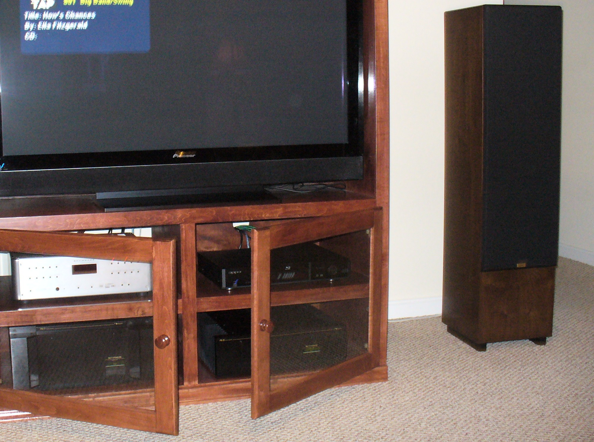

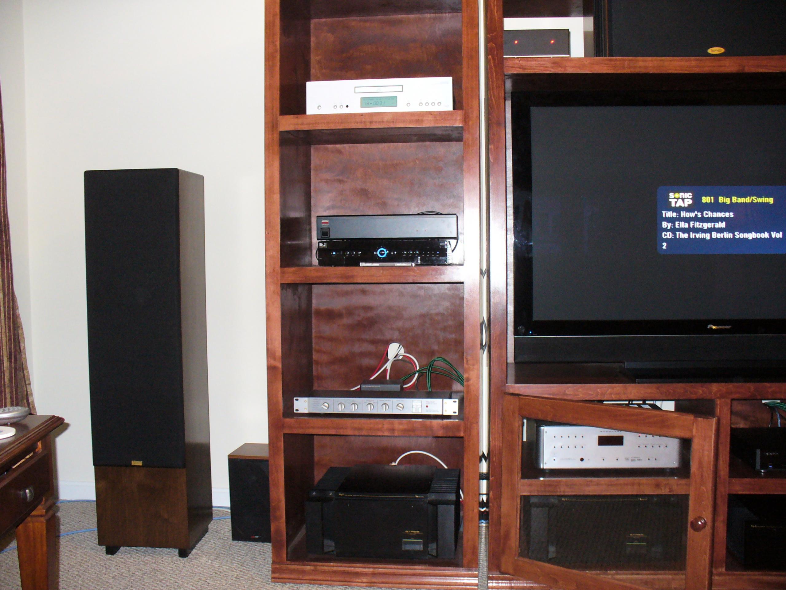

Here are a couple of picss with the refurbished FET-10:
The new power supply is massive! It has a 200VA Torodial transformer, not to mention a lot of fileter caps. The difference rendered by the new power supply for the FET-10 is remarkable.
The sound from this setup is truly outstanding.
Actually, there are two PA-7's, and one PA-5 for the center channel. All the amps have been refurbished, and they sound great.

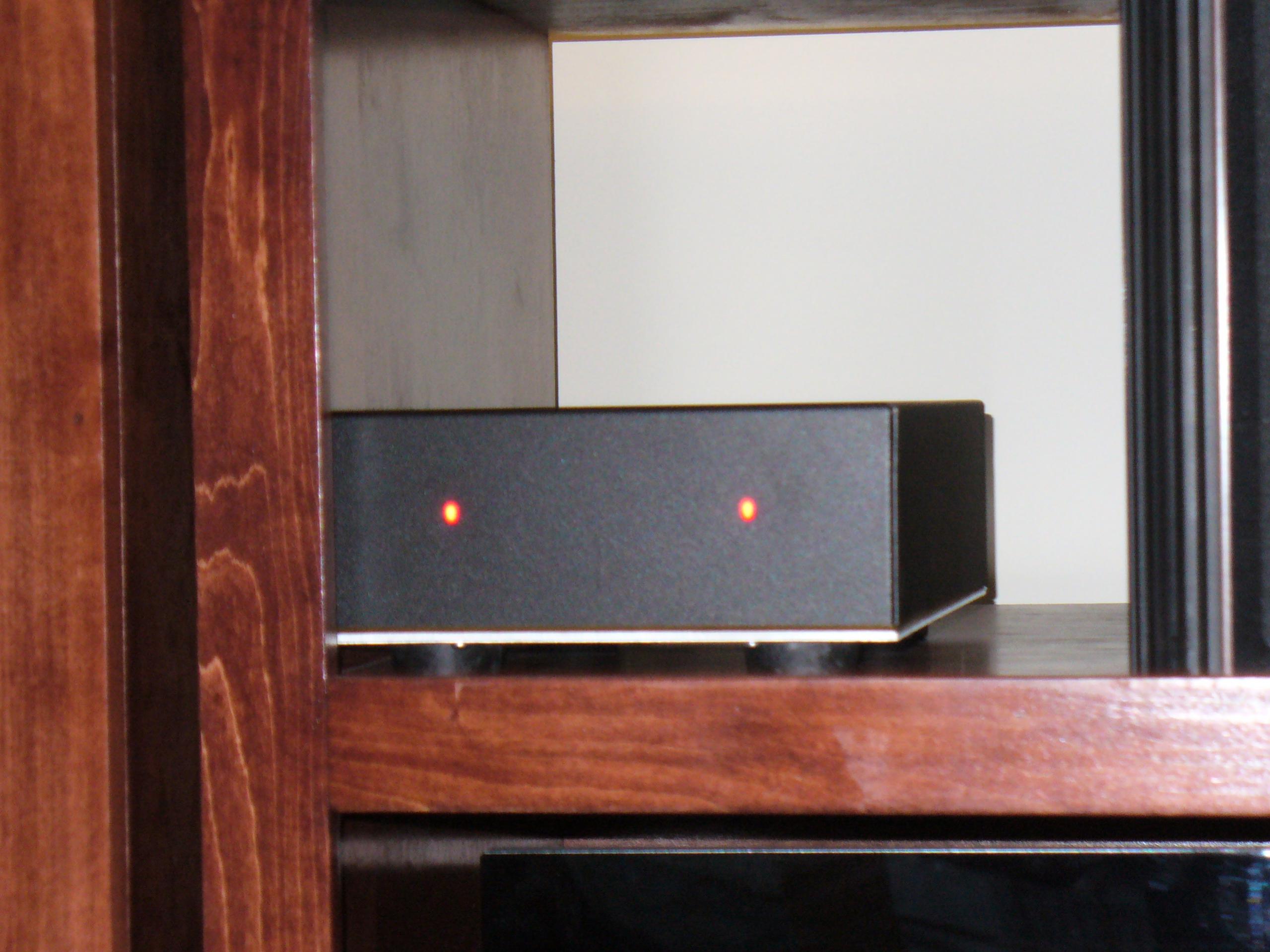

The new power supply for the FET-10 (it's the black box with the two LED's), makes a HUGE difference. It transforms the FET-10 to another level.
It almost seems that the original power supply for the FET-10 was designed by someone else. It really is pretty wimpy, and does not match the outstanding quality of the FET-10.

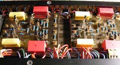

I recapped my FET-10/HL.
The outboard PS now has Nichicon FG power supply electrolytics (along with UF4007 diodes). Inside the main case, for the 4.7uF bypass, I used Elna Silmics.
Signal path - for the 1uF input capacitors, I replaced them with Relcap PPMFs which fit the same space perfectly. The 10uF output capacitors were a little more tricky - I ended up using 10uF/63V Wima metallized polycarbonates lying on their sides. It was a bit of a squeeze but everything works.
Subjectively speaking, the sound is a bit better - touch more detail, faster and more 'transparent'. I'm very happy and feel no need to buy anything else (for now!).

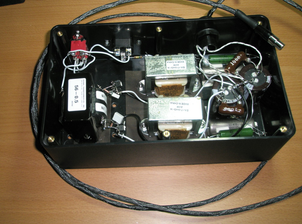

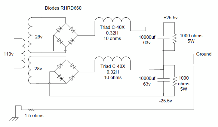

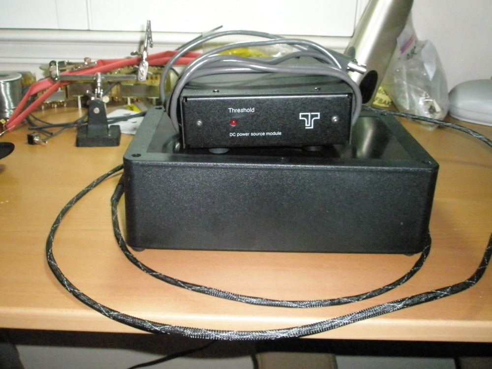

I built a new external power supply for my FET 10hl. The original power supply has a very puny transformer - only 6VA. I measured the current being drawn by the preamp and it draws about 3W steady state (it's a Class A preamp) so that's isn't much margin for the transformer. 6VA will deliver slightly less than 6W because there is some phase difference between current and voltage otherwise known as the power factor.
I upgraded the transformer to a 28VA transformer for extra headroom and changed from a traditional transformer - diode bridge - capacitor supply to a choke input supply, which consists of transformer - diode bridge - choke - capacitor supply. These are more commonly used in tube amps and are known to be very quiet. I also increased the size of the power supply caps to 2 x 10,000uf.
I wouldn't be writing if it wasn't a big improvement. Soundstage is huge and even more transparent than it was previously. Additionally a slight harshness/sibilance I was hearing, which I thought was due to my amplifiers has almost disappeared. It must be a good improvement because I keep wanting to listen to more music.
Attached is a schematic of the supply that I built. Not shown are the bypass caps that I used on the 10K electrolytics. I used Russian military caps - 10uf 63v (type K73-16) and 1uf 200v (type K40Y-9) and 0.22uf 630v (type K42Y-2).
For scale I've attached a picture of the original supply sitting on top of the new one. The new one is quite a bit larger and heavier due to all the iron.
Happy listening.

. . . I have a feeling that is worth trying that lower choke - moving to negative lower leg
Thanks for the suggestion. Can you say more about why it might make a difference? Each side of the supply is hooked up as a separate loop so I didn't think that it matters where the choke goes.
---Gary
say that ripple in upper neg leg and lower pos leg is same but in opposite phase ; you need them in same amplitude to superimpose them .
if you move lower choke to lowest leg , that way you'll also have same ripple in final pos and neg legs
difference maybe audible , maybe not .........
I am reluctant to disagree with someone as esteemed as our own Zen Mod but I will in this case. I don't think that the ripple is changed by the location of the choke. If one says that the rectified AC from the bridge has a DC component Vdc and an AC component Vac, then it's simple to show that the capacitor charges to Vdc and the Vac term is attenuated by the ratio of Zc/(Zl+Zc) and the size and sign of the ripple is unaffected by the location of the choke. At least that's how it looks to me. But I'm happy to be corrected if I'm thinking about this in the wrong way.
Best regards,
---Gary

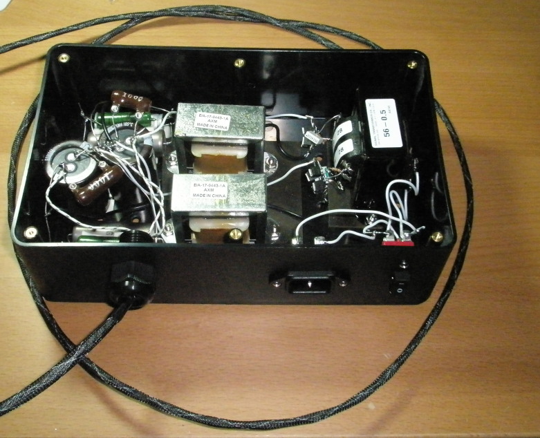

PS pictures
Here are a few photographs showing the construction of the power supply. I wired everything up by hand and did not use any circuit board. Many components are suspended by their leads from the terminals for the transformer or the capacitors. It looks a bit messy but this type of construction sounds very good since everything is isolated in free space with minimal coupling.
GaryB - you have all rights to dissagree with anyone , especially with someone so not-serious as ZM is
my thoughts aren't directed on electrical function of circuit itself ( and mea culpa for not addressing that) but more on physical layout of circuit itself ;
meaning that -for best results- physical layout of adjacent routes in PSU must be symmetrical/identical too .....
maybe splitting a hair but - in this hobby we are used to look at that last one ( hair )
