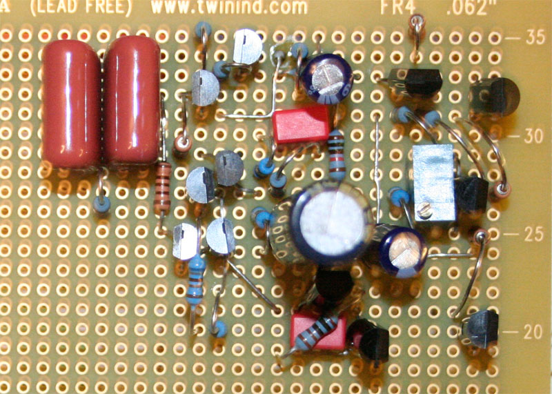

Yea ok, I realize that the layout kinda janko right now. Tomorrow hopefully I'll have time after work to get some components on a new board where everything is on the board as i had posted before. Since I didn't get any objections, it must not be so bad then...
I tried just swapping the CFP with an EF output (Flipping it upside down and swapping drivers) also shortened the driver wires a bit and I cant get it to sound nearly as good as I did with the CFP, its also got a lot more background noise, and it was making weird sweeping noises for a while. I thought I was being attacked by aliens. :) Hopefully it works on a board better. Thanks again guys.
thanks again mooly I figured as much.
Also, andrew thanks for that explination, I guess that means that I shouldn't have the input highpass pulldown resistor much different than the main feedback resistor? I think I might remember that now from the online guide, oops.
Ok so here's what I got so far. I haven't soldered much yet it's just placed/jammed in there. Input goes top left and middle left with a jumper to the center ground. I haven't made the jumper from the input to the base of the transistor yet, so you can see its just chillin' there.
Everything is 1/4W resistors, the small transistors are ksa992fta and complements while the drivers and vas are ksa916yta and complements. I thought those seemed to be appropriate sizes from my limited choices. I also have some MJE172/182 but I thought they might be a bit much for drivers and their a little low on the voltage, I bought them when I didn't know what I was gonna do yet. My final plan is +-60 rails.
Outputs on the right, I plan to have a set of stubby wires from the drivers to the output transistors (like I have seen here before) or maybe just bend the leads, leave them long enough and solder them on the edge.
The output resistors will end up hanging off the heat sink as well, which means an NFB wire will need to run back to the center of the circuit. This will then be the only 'wire' of any length apart from the input wires coming in.
There are no jumps on the back, although in some places it might make sense to move them back there.
Please tell me if the setup looks acceptable enough to think that its gonna work out.

It's scary stuff :)
Is it gonna work ? honest answer... anythings possible... but there's lot's of problems.
The drivers !! A 2SA916. That's a 50 milliamp device, they just won't survive as the volumes turned up. I don't think you realise how much current an amp can draw under full load.
and -/+60 volts, that's way to ambitious for anything built like this.
Cobbling something together with inappropriate parts is just asking for trouble.
I can't do all the work for you, so my advice would be to try something much less ambitious such as a Gainclone kit... you would learn a lot and hopefully end up with a working amp.
If you are intent on building Dougs amp use the correct components, a modest PSU of no more then -/+25 to 30 volts to start, and use a LARGE as in say 6 by 4 inch piece of strip board for the amp and lay it all out following the circuit as a rough layout guide. Use proper drivers with heatsinks... and build the EF version.
ksa916 is 800ma, 900mw... Am I missing something? They are not 2sa, I don't know where you keep getting that label from. The datasheet is on page 3, I linked to it.

you keep saying that the layout is the reason for a lot of my troubles so I figured I'd come up with a new layout and post it so people could say, oh that's stupid the vas should be closer to the drivers, or you shouldn't put transistors close to caps or something.
I've said it many times, the first amp I built worked after I added the driver caps, I'm really just trying to find out the best way to go about improving on dougs design by simply using componets that aren't older than dirt. Sorry if my intentions were not clear.

My mistake with the transistor... sorry... comes from years working with JIS markings.
Your amp "worked" after adding caps because you were killing the HF response such that the amp couldn't oscillate, but that would impact severely on the performance and distortion if you actually measured it.
You can stop a purpose designed oscillator by doing that :)
Dougs design doesn't need exotic components... it can be built with stuff that was around in the 1970's and 80's... honest. And meet it's full specification.
The last thing I want to do is discourage you, so I guess your going to have to go ahead and build it... and see where that takes you.
