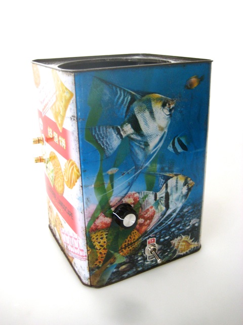

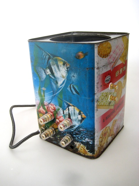

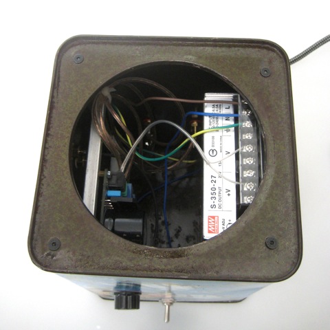

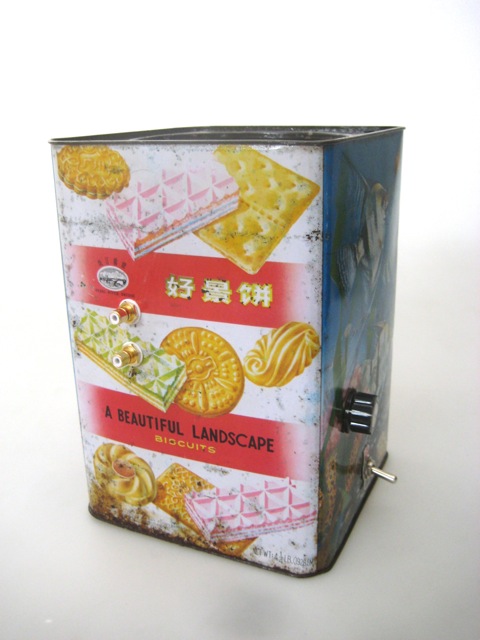

A friend of mine made this amp with a T2 and a meanwell smps. Looks nice!
Yes it does!
