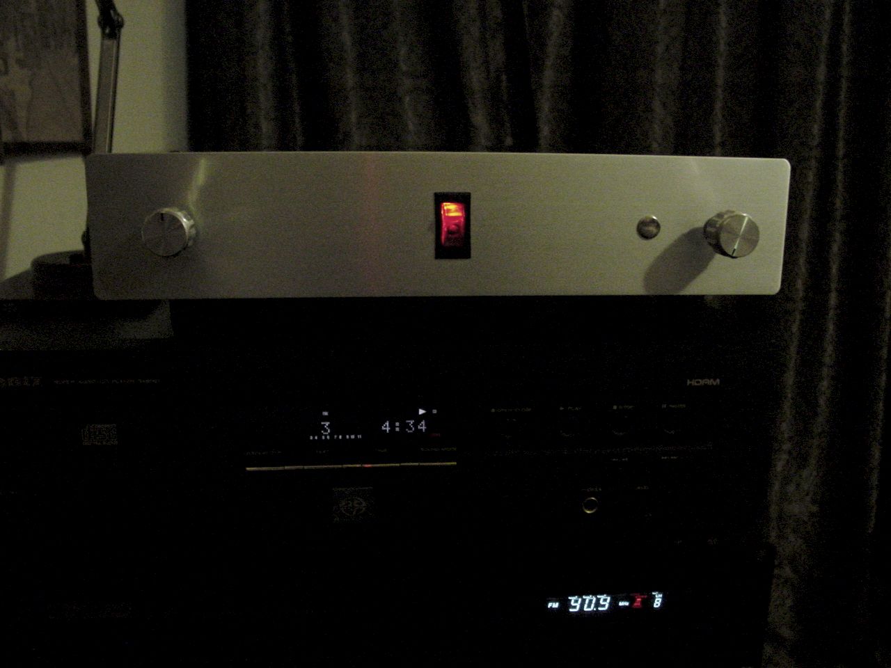

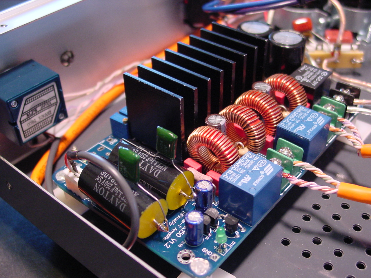

Here's the resulting amp; it sounds AMAZING. I've got a modded Sonic T-amp which is excellent, but the T1 is simply superb.
I'm still breaking it in, but WOW
simply stunning, like the RCA input selector.
