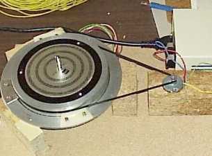

Just a very rudimentary setup to measure things like the tacho waveform, phase detector output waveforms, etc. at actual playing speeds.
The 'other' motor is stolen from a 5-1/4 inch floppydisc drive.

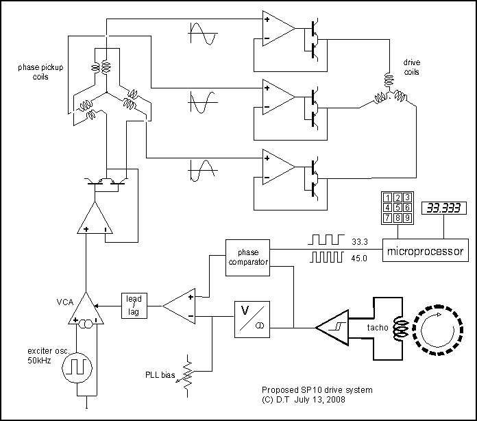

This is the basic system / configuration I've decided upon. I'm working on a breadboard version of parts of it. The actual electronics will use no esoteric or unusual ICs - except for the microprocessor part, but since its only function - other than control logic - will be to generate the quartz-derived timing signal, it could be substituted with a discrete logic divider.

I believe that circuit will give performance comparable with the old voltage servos which were used before the FG servo circuit was developed. This is a distinct retrograde step.
The problem lies in the available accuracy and precision of the frequency to voltage conversion being nowhere close to the accuracy and precision available by staying in the frequency domain and using the PLL to generate the lead / lag signal.
Feeding the split magnitude and phase components of the tacho frequency signal back into an error amplifer via an active filter network is how they do it until today (SL-12x0MK5)...
The 'vintage servos' were implemented without a tacho frequency coil signal at all. I have both an SL-2000 (servo control) and an SL-1200 (MK2, servo control with quartz referenced PLL using the tacho speed in a multi-loop) and the difference is like night and day. ;)
