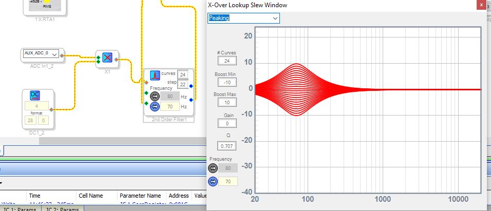

Hello all.
I wonder if someone can point me in the right direction, please?
I am trying to use a pot to control a peak filter for bass and I would like to add another for treble as well. Volume is being successfully controlled by a 10k pot as per the pdf which describes it.
There is an example file that comes with SigmaStudio so I copied the group of components over and reassigned it for ADC0 which corresponds to MP9 (the first pot on the Sure board). However, when implemented the 2nd Order Filter immediately puts the curve the minimum and there is no control from Pot 1.
Can anyone see what I am missing?

(please ignore MP2, that was highlighted by mistake before I left this morning)

Hello all.
Absolutely brilliant, thanks! All working like a dream in that respect.
I've not had a play, the zip file contains the original SureDSP firmware and the link is the TI hardware control application notes pdf:
