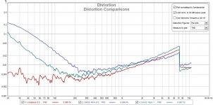

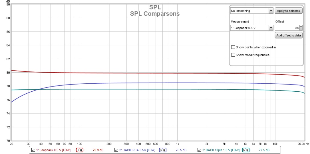

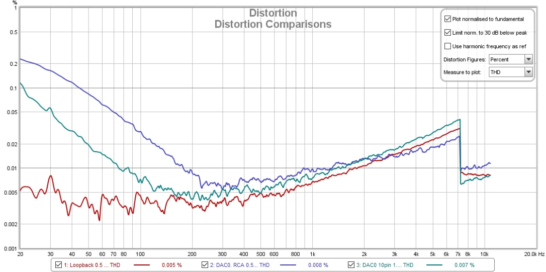

Here are a few tests I ran on the Sure 1701 board. I was interested in the board's frequency response and harmonic distortion, especially since it doesn't appear to have reconstruction filters. I performed the tests in two different configurations: one using the Sure extension board (the board with the RCA connectors) for inputs/outputs and a second using the 1701 board's 10-pin extension connector lines directly. To perform the tests I created and downloaded a SigmaStudio program that simply maps input 0 directly to DACs 0 and 1 and input 1 directly to DACs 2 and 3.
I first ran a static test at 1 KHz to determine the loss between inputs and outputs. The 1701 board is configured for a maximum of 2 Vrms input and the maximum DAC outputs are 0.9 V. That calculates to an expected loss of 6.9 dBV. Using the 10-pin connector I measured a loss of 7.5 dB, 0.6 dB more than expected. I then repeated the same test using the RCA extension board for inputs/outputs and got my first surprise: an average loss of only 1.5 dB. The extension board must be providing about 6 dB of gain on the input before sending it to the 1701 board. The question I have to ask myself is how? The only ICs I see are the two SGM4917 headphone amps Neil Davis mentioned in post #32. Since I'm not really interested in the extension board I don't plan to pursue the answer.
I then ran frequency response and harmonic distortion tests using both configurations. In an attempt to keep the 1701 DAC output at the same level for both configurations I ran the extension board tests at 0.5 V (approximately half full scale) and the 10-pin connector tests 6 dB higher (1.0 V), also approximately half full scale. I also ran a loopback test at 0.5 V to measure my system's baseline response and harmonic distortion. I attached the comparison measurements for SPL, phase and distortion. My interpretation of the measurements:
SPL: The upper red trace (loop back) and the lower green trace (DAC0 using 10-pin connector inputs/outputs) are pretty much straight lines. The middle blue trace (DAC0 using extension board inputs/outputs) shows the extension board adds a high pass filter that rolls off very low bass. And it looks like I should have raised the 10-pin input level one more dB to match the extension board output level.
Phase: The red loopback trace is at or near 0 degrees as expected. The lower green trace (DAC0 using 10-pin connector inputs/outputs) is at or near -180 degrees. That's because the 1701 DACs are inverting DACs as explained in the 1701 datasheet. The upper blue trace (DAC0 using extension board inputs/outputs) shows the phase shift due to the high pass filter and then approaches 0 so the extension board must also invert the signal. Perhaps an inverting active high pass filter with gain?
Distortion: The lower red loopback trace starts off at a respectful 0.005%, but starts increasing at around 500-700 Hz to 0.03% at 7 KHz. I don't know exactly why that's happening unless it's a flaw in my audio interface (a USB/Firewire Behringer FCA610). Something to investigate later. The upper blue trace (DAC0 using extension board inputs/outputs) has higher distortion in the 20 to 300 Hz region than DAC0 using the 10-pin connector (middle green trace), perhaps from the high pass filter. But notice that from about 300 Hz and above the distortion using either set of inputs/outputs is near the distortion floor of my system. I really didn't expect this from the 1701 board, especially if it doesn't have reconstruction filters. One thought is whether my Behringer has low pass filters on its inputs in the 50 KHz range that act as reconstruction filters. Just a guess.

Thanks for doing this. I was curious how well the I/O board performed. It uses a pair of SGM4917 headphone amps to buffer the outputs, which is an unusual choice.
The SGM4917 has an on-board charge pump to provide a negative voltage, which has two benefits. First, it allows the output to swing above and below ground so that you don't need an output capacitor. And second, it increases the total voltage swing to get more output than what is usually possible from a 3.3V device. That allows the I/O board to compensate for that 6dB loss in the ADAU1701 from using the 2V input. So it looks like the DSP board with the I/O board provides pro-gear compatible voltage levels on both input and output (nominal 2V input and 2V output).

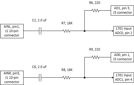

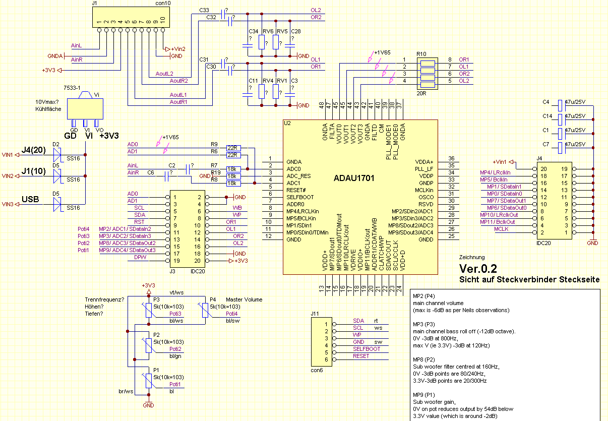

Daniel - I can think of a few areas that might be causing your noise problem:
1. Don't use the AD0 and AD1 inputs on the J3 20-pin connector. I recently discovered these inputs bypass the input capacitor and 18 KOhm resistor which are needed. When using the 1701 board alone use the AINL and AINR inputs on the J1 10-pin connector or use the extension board with RCA inputs. See my attached input sketch.
2. Amp gain setting: TPA3116 amps can be set up for 20, 26, 32 or 32 dB of gain. Amps set to 26 dB of gain work best with the 1701's DACs' maximum output level. A gain of 20 dB will work and is the quietest, but you'll be limited to 20 W (using a 4 ohm load) when the DACs are at their output maximum of 0.9 V. Several people have noticed hiss with amp boards using 32 or 32 dB of gain.
3. Grounding: The J1 10-pin connector has two types of ground connections: pin 9 is "GND" and pin 2 is "SGND". I've always connected the negative side of the input to "SGND" and not used "GND" at all.
4. Input level: if you're using the 1701 board alone without the RCA extension board you should ideally use an input device that can produce up to 2 Vrms to the 1701 board. If you're using the extension board 1 Vrms is the maximum input.

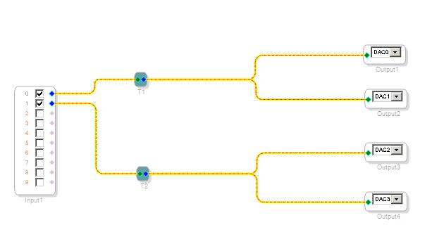

5. SigmaStudio program: For testing I'd recommend that you replace the SigmaStudio program that comes with the board with a simple program that just routes the input 0 to DACs 0 &1 and input 1 to DACs 2 & 3. That assumes you have a 1701 programmer.

Dear ernperkins,
Thank you for your comment.
Your 1, 3, 4, 5 points: I've tried them. Unfortunately nothing results. :-(
At the moment the conections are according to your tips.
The noise is there without any input too. If I make the connektions withot power on the kernel there are only a moderate size of hiss, so the noise doesn't come from EMI. If I power on the Kernel board the noise appear. With signal input, without signal input and with shortstopped input too.
About point 2: Maybe you're right. My first idea was the gain problem too, but I thought that the kernels's board gain is too high. I've tried to decrease the ADAU's gain with the sigma software. Without any success... Can I decrease the kernel's gain in the board? Sure, but unfortunately my eyes aren't sharp enough to make soldering on a surface mounted PCB. Is there any other possibility?
I will try the config with a lower level gain amp. (I must realize how can I set the gain level in the finished amp board)
At home I will try to make a pic about my sigma software and the connected device too.

the LF distortion could also be a jitter introduced S/N problem. the ADAU needs an xtal controlled dac freq, not a pll reconstructed digital input stream
